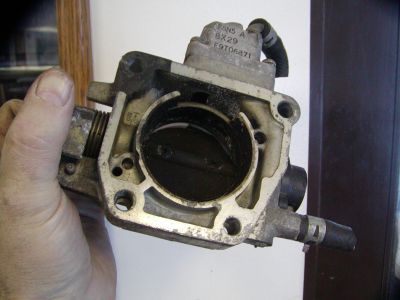

Not sure if this is anything like the 4.0 liter, but might be worth looking at. Carbon buildup on the iac under the throttle body may be the source. Clean both the iac and throttle body and all is well. Carbon buildup may not allow iac to move correctly and maintain the correct position.

And yes I think this is very possible. Carbon will get sticky and can get worse when cold as it is thicker.
This is the carbon build up on a throttle body.
https://www.2carpros.com/forum/automotive_pictures/30961_P1190121_2.jpg
It can get very thick and tar like.
I have seen it make throtlle body plates stick open. IF you were to press on the accelerator and it stayed open it what I refer to.

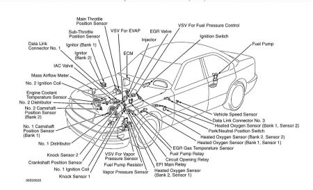

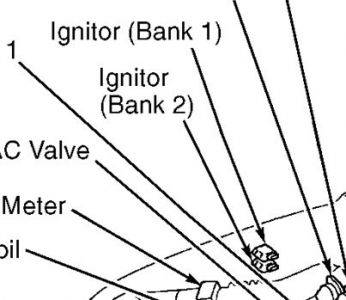

I would still recommend a intake cleaning and/ or pulling off the iac and cleaning it. This is an often overlooked maintenance procedure. Setting that aside, there is another wya you may be able to duplicate this problem to narrow down the source.
Using a hair drying, you can heat up components individually and try to re-create the no-start. Don't cook anything just raise the temperature.
Focus on ignition components, I would start at the ignitor area first.
https://www.2carpros.com/forum/automotive_pictures/30961_1l_1.jpg
https://www.2carpros.com/forum/automotive_pictures/30961_1l1_1.jpg
The ignition switch is another. I believe they have a transponder in the switch that my not be giving a signal.
