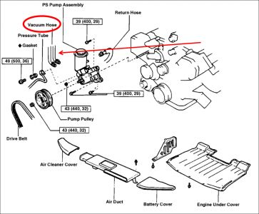

My car smokes when I start it. The only fluid levels I can find are the power steering unit which requires constant refilling. Is there a connection between the power steering and the exhaust smoking? The power steering unit specifies auto transmission fluid.

Hello -
Is your car running rough at all?
What color is the smoke and is it all the time or just at start up?
Have you inspected the PS pump lines all around the rack and pinion area for any leaks?

Very little smoke after brief run time. A lot when when engine first started. Smoke is very light colored, not dark like oil smoke. Cannot find any leaks. Tklhe power steering unit uses ATF fluid instead of power steering fluid. Cannot understand, losing more fluid and the smoking gets worse. Go figurs.

Well, normally from my experience the PS is not connected to the engine. . .. . .. . .but I need you to look at the below pic. . .. . .I have circled and put an arrow at a couple of items. They say they are vacuum lines.
https://www.2carpros.com/forum/automotive_pictures/248015_Picture1_40.jpg
I have looked through numerous schematics and can not find any vacuum lines going to the PS other than. . ...these if they are.
Please pop the hood and put eyes on the target here and let me know what you see. . ...
There should be two lines that go to the rack. . .. . .. . ..
These look like two others. . ...see what they are connected to and where do they go. . ...if it is what I think, these lines end up going to the intake manifold. I would disconnect them and see if you have PS fluid in them. . ..
Let me know what you find there. . .. . ...
