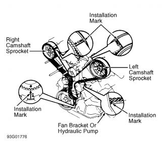

93 ls 400 intially the car was running poor lack of power misfiring. Got code 13 and 41. Needed a water pump and front seal also. Put water pump and seal in and put it back together. It cranks barely and dies. Try to start again and its just turnig over. What could be wrong?

Suspect timing belt not aligned properly see diagram

have problem with codes been repaired?

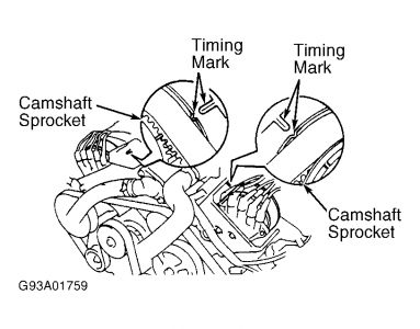

The marks on 93 ls 400 are different. Line up crankshaft on 0 and the two cams line up at the top. Got code 13 and 41. Put another throttle position sensor on and another crank sensor and got car started but it has no power and dies out on me any ideas

Diagram is 4.0L 93 LS 400
