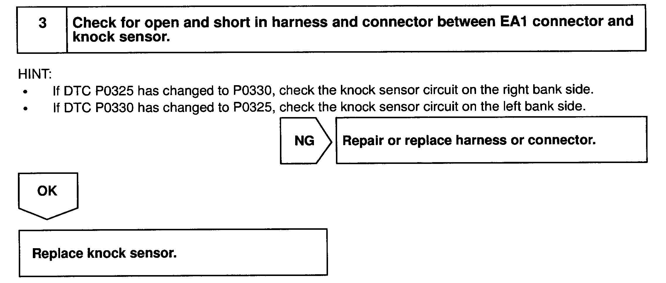

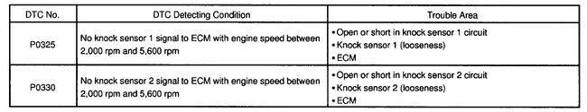

Here are the directions. All attached pics correlate with these directions.
Troubleshooting
Vehicle ALL Diagnostic Trouble Codes ( DTC ) Testing and Inspection P Code Charts P0325 Troubleshooting
TROUBLESHOOTING
CIRCUIT DESCRIPTION
Each of knock sensor is fitted to the right bank and left bank of the cylinder block to detect engine knocking. This sensor contains a piezoelectric element which generates a voltage when it becomes deformed, which occurs when the cylinder block vibrates due to knocking. If engine knocking occurs, ignition timing is retarded to suppress it.
picture 1

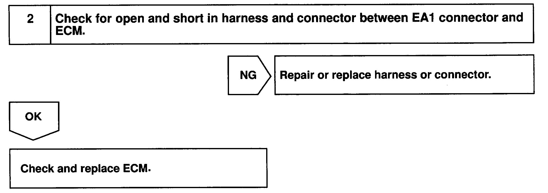

DETECTING CONDITION
If the ECM detects the above diagnosis conditions, it operates the fail-safe function in which the corrective retard angle value is set to the maximum value.
picture 2

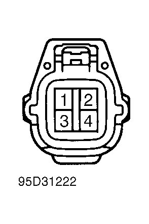

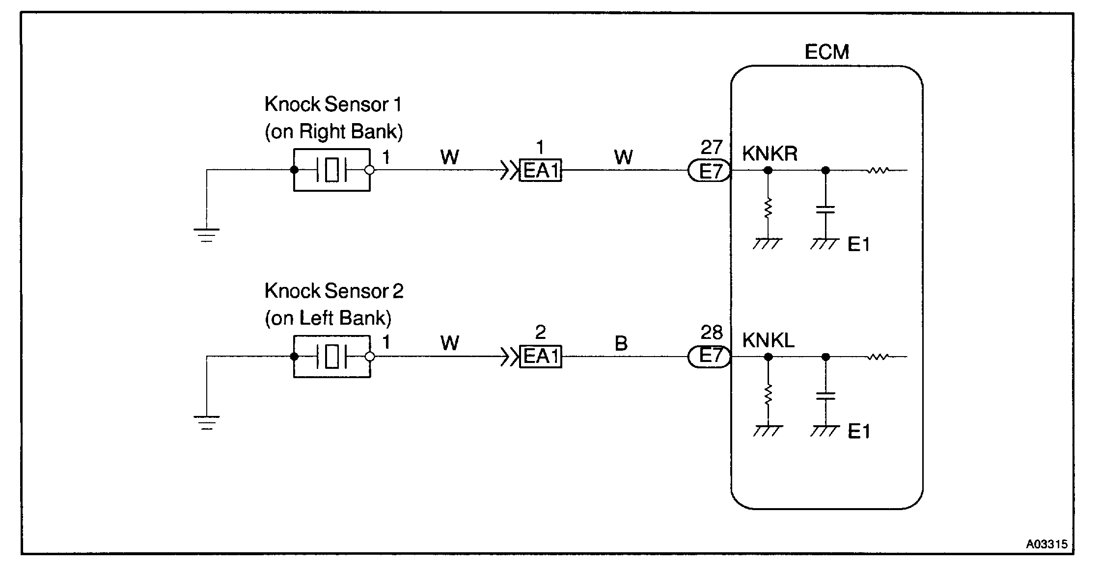

WIRING DIAGRAM
Step 1
picture 3

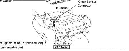

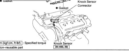

Step 2
picture 4

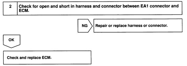

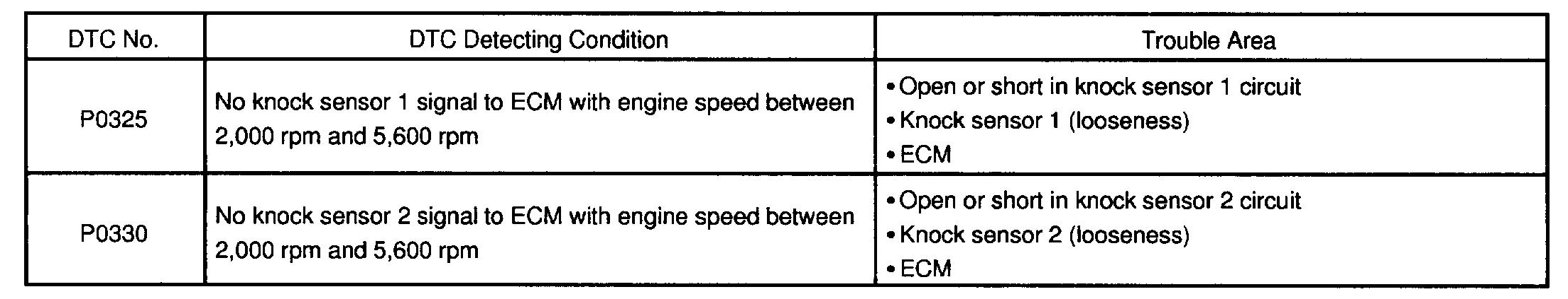

Step 3
picture 5

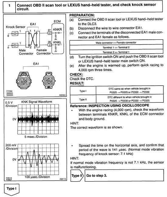

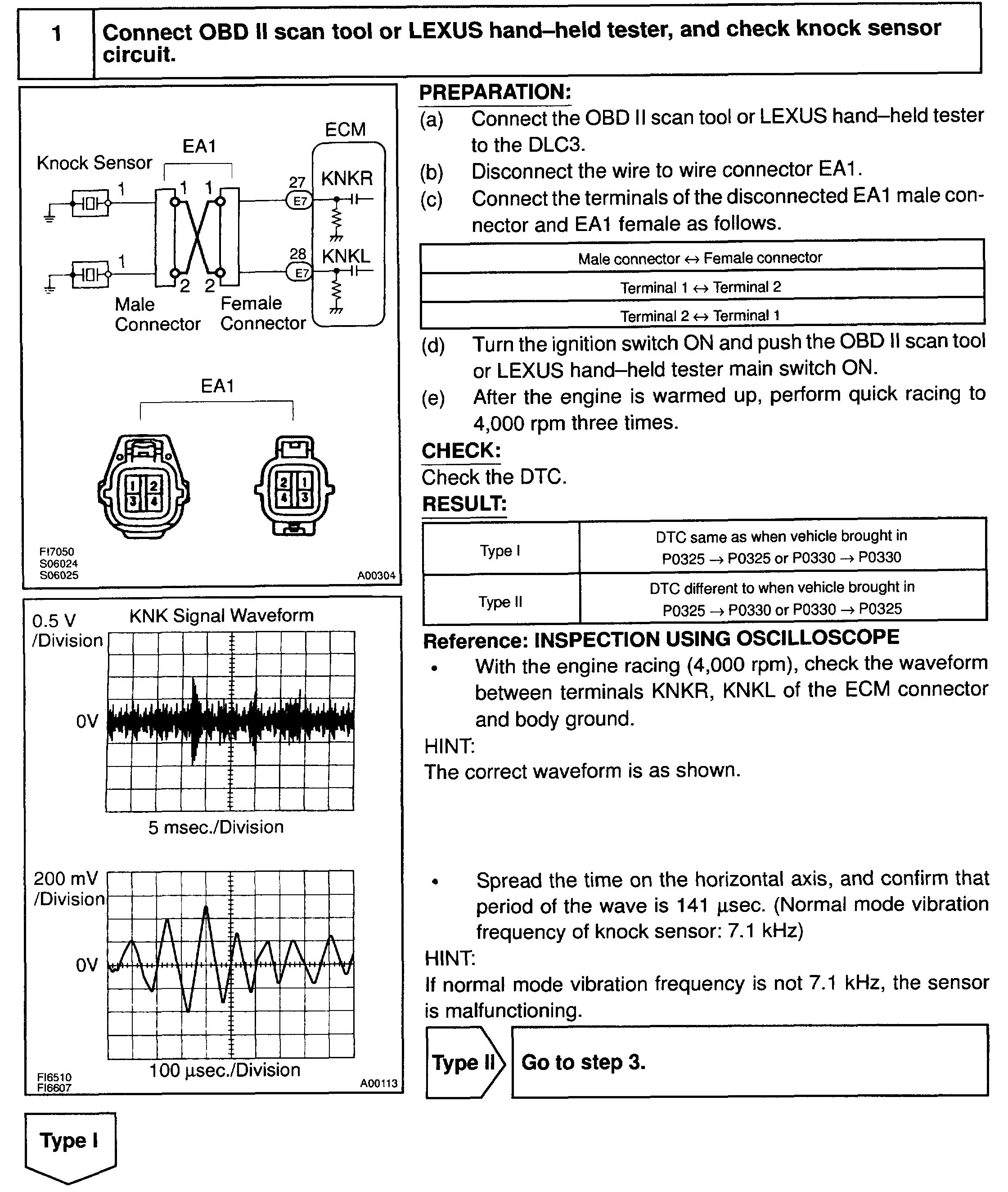

INSPECTION PROCEDURE
HINT:
- DTC P0325 is for the right bank knock sensor circuit.
- Read freeze frame data using LEXUS hand-held tester or OBD II scan tool. Because freeze frame records the engine conditions when the malfunction is detected. When troubleshooting, it is useful for determining whether the vehicle was running or stopped, the engine was warmed up or not, the air-fuel ratio was lean or rich, etc. at the time of the malfunction.

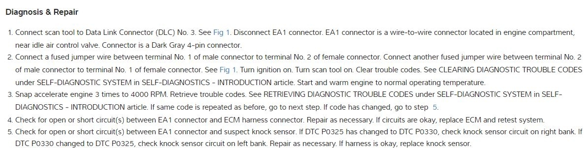

Wow, I'm not sure what to tell you. You may be better off at this point to take it to a dealer.
What I have done is provide the diagnostic instructions in pic 1. It may help you or the person you are taking it to. The second picture shows the plug connector to the sensor.
Let me know if this helps at all.
