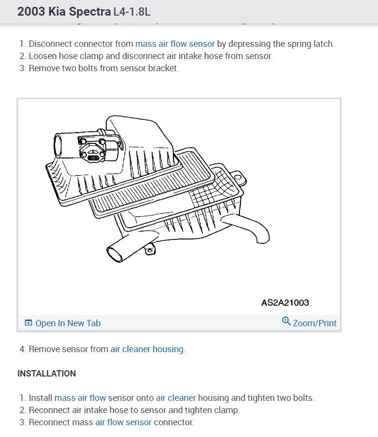

Working on my parents 03 kia spectra that has same misfire issues. The more i messed with it the more random the misfires became, especially on cylinders 1 and 3. Started looking at the coil pack harness connector and noticed one wire wasn't pushed in as much as the other wire. Come to find oit the connector has deteriorated and is falling apart. Hoping that will fix my misfires
Feb 18, 2019 at 7:07 AM
  • CAR REPAIR CONTRIBUTOR
  • 54,222 POSTS
Yep it sounds like it will. here is a guide that can help. I have seen a bad MAF sensor cause this issue as well, check out the diagrams below.
and
https://www.2carpros.com/articles/how-to-replace-a-mass-air-flow-sensor-maf
