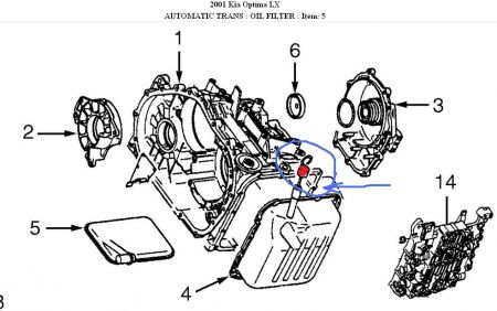

My new problem is, when I first start my car (and this just started in the last few days), it won't shift into reverse, I have to go down to Neutral, and then back up to reverse and THEN it will shift. Often times when doing this, it is very jerky going into reverse that way. Also, over the last month or two, I have noticed that while driving, the car shifts gears a little more rough than it used to.
I cannot find the fluid for the ATF, so I could use some help there. I know it probably needs flushing. However, this is all accompanied by a recent noise I hear while driving over 20mph. Its a humming or whining, not terribly bad yet, but getting worse. Could this also be from fluid?
I don't see any ATF fluid on the ground from my car, or oil of any sort. So unless something else besides a leak is taking the fluid away, it "shouldn't" be low. I just can't seem to find without getting it up on jacks, where my ATF dipstick (if I have one), is, or where I could add some fluid. I have 0 dollars to get Kia to look at this at the moment, so =(. Any help would be greatly appreciated!

Hi captgeech21,
See diagram for dipstick location.
https://www.2carpros.com/forum/automotive_pictures/192750_Trans01Optima_1.jpg
Symptoms does not seem to indicate a fluid issue.

That design was exactly what I was looking for. Fortunately, I talked with my family mechanic and he told me the Automatic transaxle dipstick was the ATF dipstick, something that was confusing me a bit.
I topped it off with some fluid as it was a little bit low, and it started shifting better.

I took it to my mechanic to be safe and get the fluid flushed, and as he test drove it, and put it on the lift to drain the fluid out, he said I had a bearing going bad in the tranny. The tranny is leaking fluid just barely at the bottom, he said near some sort of junction plate. He said the noise im hearing while driving is a bearing going bad and that it could end up lasting another year, or a month.

If it is some sort of whiny noise and the leak is not too bad, the trans might still last. The leak from bottom could be anything from spilt fluids while topping up or a leak in the torque converter seals.
If you are thinking of replacement with a used one, then why not use it till it fails? Who knows, the bearing might work for a long time to come if the fluid level is correct.
Without understanding what could be wrong, I am not able to provide any suggestions for repairs and if the leak is minimal, It could be a seal and that could be from the CV shafts, line pressure test bolts ( retightening might work), loose hose joints or the shift lever seal. These would not be too expensive to repair as the trans need not be removed.
