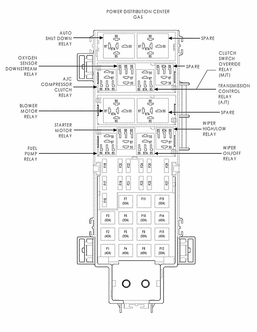

Original grey key. I can unlock ignition, turn to accessories on and then past to start position. All dash lights come on. Will not start. Please help.

I think it is suppose to by a black key, is the security light flashing when you try to start it?

First try stepping on the brake and put the trans in neutral and see if it will start, Wiggle the shifter a bit while holding the key. That will tell you if it's a neutral switch issue.
If nothing then have someone turn the key to start a few times while you listen and feel the starter relay in the PDC under the hood. If it is clicking on/off try swapping it with the spare (if it's still there, if not use the wiper high/low) If it starts now replace the relay. If not then it will be necessary to check the starter itself.
Which engine do you have the 4 or 6 and is this a Sport or Limited model? Wiring is a bit different.
