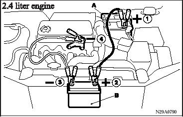

I went to start my car and it just made a click click click noise, and after several tries, the dashboard lights started to dim. When I went to attempt to jump the battery I found what was one negative terminal marked NEG. When I tried to connect the negative clamp for the charge, the cables got hot. I don't really know WHAT the problem is, but I cannot start my car, and I don't know how to jump it. HELP

Welcome to the forum, your owners manual, showed the below info for cables.
https://www.2carpros.com/forum/automotive_pictures/170934_04_dodge_stratus_jumper_cables_1.jpg
If the battery is down, take it out, get it recharged. Too many issues trying to jump. A lot of public service outfits that used to carry jumper cables, to help people. Have quit because of liability issues associated with jumper cables.

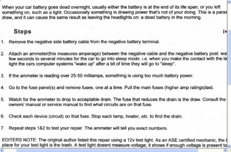

What you need to do is have a current draw test done, this is done by placing an Amp meter between Battery Pos (+) and the battery lead, with the key out and doors closed check the current draw, there should be only around.15-.2 amps max, any more and you have a circuit open, start pulling fuses and circuit breakers, and fusible links one at a time to isolate the faulty circuit, also unplug the alternator as a faulty diode will cause this and still show a charge rate, if in doubt get your mechanic to do this test for you.
Mark (mhpautos)
+1
Saturday, August 31st, 2019 AT 11:14 AM (Merged)
  • 75,992 POSTS
https://www.2carpros.com/forum/automotive_pictures/12900_parastic_draw_1_131.jpg
+1

Replaced battery and alt. Let it sit two days battery drained
HMAC300
  • 48,601 POSTS
You have a draw when your car is shut off. Go back to the site here and it will tell you how to check for a battery draw.
WRENCHTECH
  • 20,761 POSTS
There is a procedure for finding a battery draw like that.
You will need a digital ammeter and a jumper wire with clips on the ends to do this.
First rig any door switches so you can have a door open without triggering the interior lights and unplug the hood light. Remove one battery cable and attach the meter in series between the battery cable and battery post. Take the jumper wire and also attach it the same way. Leave the jumper wire on for at least 10 minutes to expire all the automatic timers. Now remove the jumper wire and read the meter. Anything over 50ma is too much draw. The way you locate this is to start removing fuses one at a time until the meter drops to normal level. This will be the circuit with something staying on. Determine what components are part of that circuit and check them individually until the problem is isolated.
