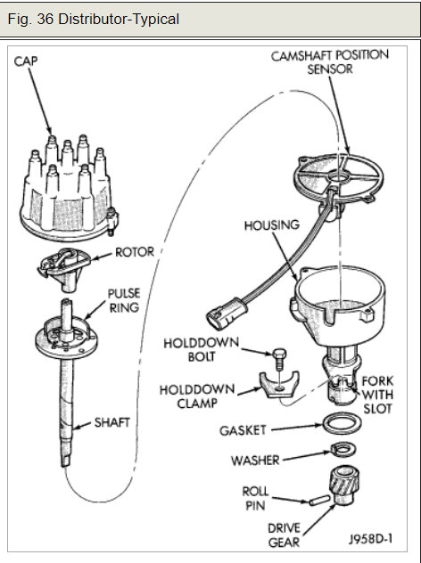

Some say it is the ECM, I have changed fuel filter, fuel strainer, fuel filter, spark plugs, ignition coil.

This sounds like the ignition pick up which they had big problems with here is a diagrams to help you see how to check it out.

Ive changed fuel pump, filter, strainer, ignition coil, rotor, rotor cap and spark plugs. It will die when driving after time, and wont start up again for about 4-10 minutes, once it starts it runs fine until the next shut off. Except that I hear small backfiring noises also. Idle seems a bit unsteady.

Did you try the pick up? Has the check engine light come on? You have replaced just about everything, so we need to look at other things.

No I dont think the check engine light comes on. So I finally got around to ordering and installing the distributor pick up and the pick yup is fixed I wish I tried that earlier.
