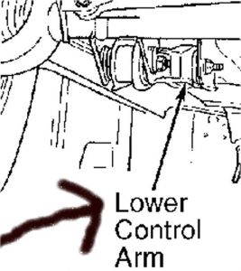

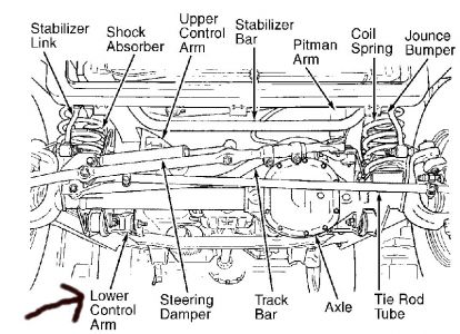

You can't see this from the drivers seat, I don't know if we are on the same page on this. If we are, then I am suspicous the the lower control arm bushing.
https://www.2carpros.com/forum/automotive_pictures/30961_jeep_1_1.jpg
https://www.2carpros.com/forum/automotive_pictures/30961_jeep_2_1.jpg

Hi Paul,
I don't think that the picture went through. But I took the digram you sent me under the car and took a look at the lower control arm bushing. It extends up to the top of the wheel well. I can't see anything physically wrong with it or the bushing attaching it. I don't know if there is anything I can do to identify or eliminate it as the culprit.
Thursday, August 2nd, 2007 AT 5:40 PM
SERVICE WRITER
  • 9,123 POSTS
The tough part is you may have no indication there is movement until you force it to move. I don't think we are talking the same part as the lower control arm is on the bottom. We usually use a 3' pry ba to get it to move, (which it shouldn't).
As far as the body moving, It should pivot but not continue forward, if that make sense. Often a clunk is heard during this.
Thursday, August 2nd, 2007 AT 9:36 PM
