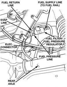

JNOVACK
  • 723 POSTS
2001 Cherokee
The fuel pump inlet filter is located on the bottom of the fuel pump module.
Before servicing the vehicle, refer to the precautions in the beginning of this manual.
Relieve the fuel system pressure.
Remove or disconnect the following:
Negative battery cable
Fuel tank
Fuel pump module
Filter from the bottom of the fuel pump module
To install:
https://www.2carpros.com/forum/automotive_pictures/52960_0900c15280043164_1.jpg
Fuel filter/pressure regulator location"”2000-01 models
Install or connect the following:
New O-rings, lubricated with engine oil
Fuel filter
Fuel lines to the fuel filter
Start the engine and check for leaks.
