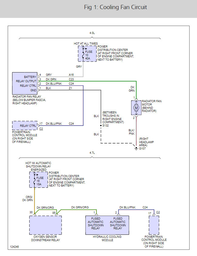

Also, a diagram would be helpful (I couldn't find an accurate one anywhere). I went back and checked the 15 amp fuse in the kick panel (still good). I don't know what the problem is. If it were set to only run when the ac is on, wouldn't there be a limiter or switch for that? I don't see one in the diagram. Could it be the Radiator fan relay ctrl (powertrain control module in the left fender side shield)? That's the only thing I haven't checked and cleared. I didn't even know about it.

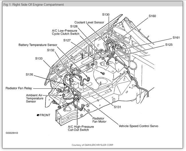

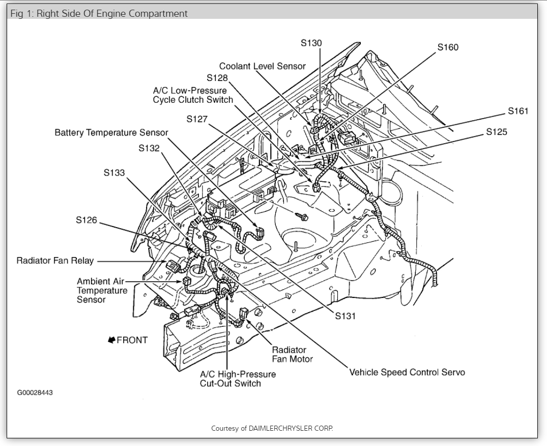

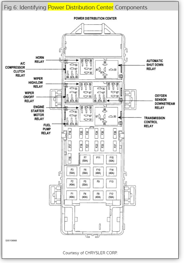

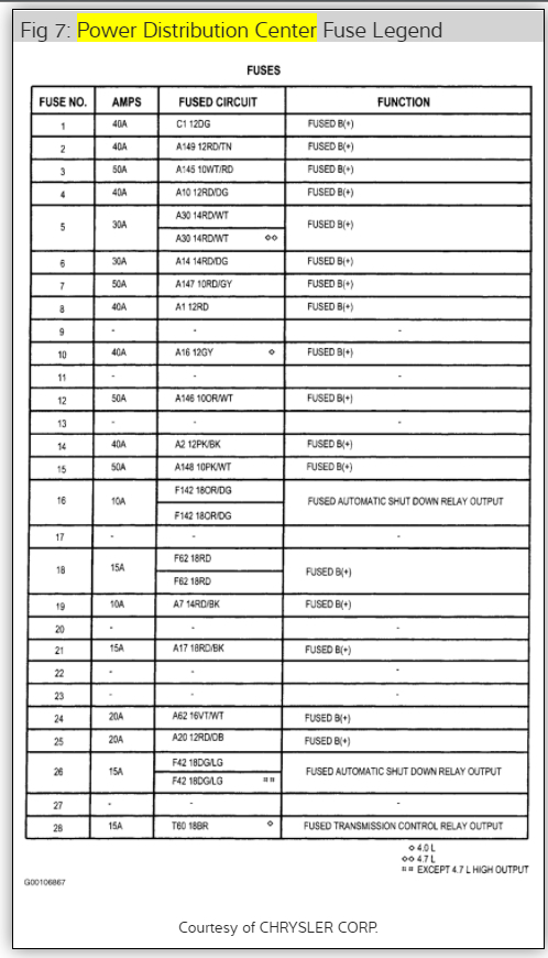

There is a radiator cooling fan relay that goes bad in these cars. Here is a guide and some radiator cooling fan wiring diagrams (below) so we can do some testing to find out what the problem is. the cooling fan relay is located at the front near the radiator on the right side.
Here is three guides that will help us get it fixed.
and
and
What is making you worried about your fan not coming on? is the engine overheating There are many cars that the electrical fan does not come on until the temp gets to 220 230 and some cars do have a completely separate fan that only comes on for the AC.
(Check out the diagrams below)
Please run some tests and get back to us.

Hello, How did you check the relay? I ask this next question because some people look up relay location and relays for a cherokee and not the grand cherokee. And they are different. Were was the relay located? Did you hot wire the fan directly to the battery? If so did it come on... If not then most likely you need a coolant fan motor... Here is a picture of the relay for a Grand Cherokee..
https://images.2carpros.com/forum/automotive_pictures/188069_coolantfanrelaychryslerdodge_4.jpg
This is the location of the relay....Behind bumper on passenger side
https://images.2carpros.com/forum/automotive_pictures/188069_01grndcherokeeradfanrelay_2.jpg
