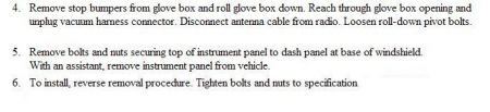

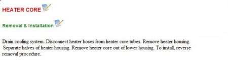

My Heater core is leaking antifreeze into my floor board how do I change it.
