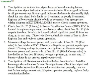

what would cause all of my turn signals to not work or only blink once or twice on either side? (Hazard lights work fine)

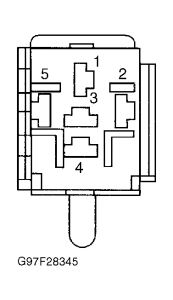

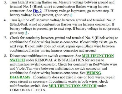

Follow this diagnostic
https://www.2carpros.com/forum/automotive_pictures/55316_99cherokee1_2.jpg
https://www.2carpros.com/forum/automotive_pictures/55316_99cherokee2_3.jpg
https://www.2carpros.com/forum/automotive_pictures/55316_99cherokee2_4.jpg
