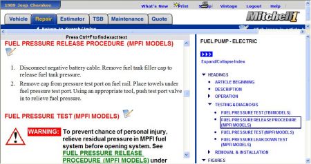

I think the fuel pump is going out on my cherokee. Making a whining noise. Is the fuel pump outside or inside the gas tank? Do I have to drop the tank to replace the fuel pump? What is required to replace the fuel pump on this vehicle?
Sunday, October 26th, 2008 AT 8:50 PM
  • 75,992 POSTS
The fuel pump is located in the fuel tank and the tank has to be drop to get at it-
Depressurized the fuel system before you pull the fuel pump -see below
https://www.2carpros.com/forum/automotive_pictures/12900_fuel_pressure_release_2.jpg
