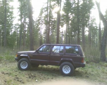

Blew a radiator hose bottom one kept driveing it till made it home have a hurt foot chip fracture to far to walk to get new hose anyway now I have a problem with the no. 1 cylinder either a bent valve or cracked piston anyone else have this problem and what was damaged kinda misses right off idle then kicks in number one spark plug dirty black and white all others spark plugs fine oil looks good just had changed it doesnt over heat now so I think head and gasket ok thanks for any feedback on this one
http://www.2carpros.com/forum/automotive_pictures/203409_041908_1802_2.jpg
