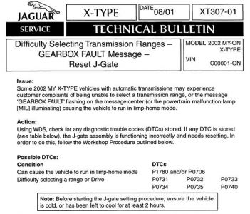

It sounds like you have an input or output shaft speed sensor that is out causing the transmission to have limited operation.
To confirm the problem let's run the codes to see what comes up. This guide will help you.
Here is a factory bulletin as well.
https://www.2carpros.com/forum/automotive_pictures/266999_jag_74.jpg
Please run this test and get back to us.
