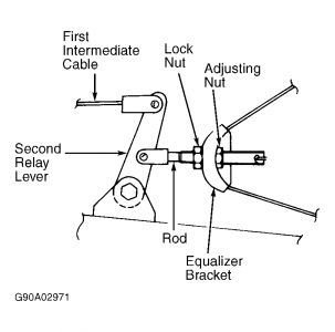

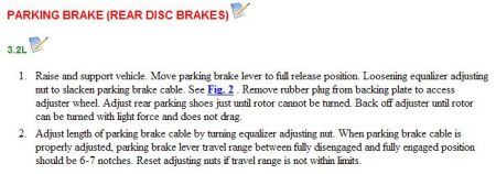

hi I just bought a 95 isuzu trooper and hand brake is not working pads are great just no contact, so my question is how can I ajust these. Please help
