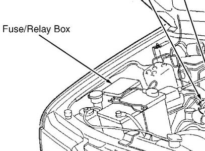

If all you get is just a single click, it has to do with the ignition circuit to the starter. It can be either the starter relay, starter solenoid, or the starter itself. In your case, I would start with the easiest and the least expensive, which is the starter relay. It is inside the fuse/relay box under the hood
https://www.2carpros.com/forum/automotive_pictures/55316_99rodeofuse_1.jpg

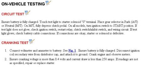

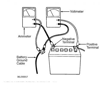

Then you need to check the starter solenoid (attached to the starter)
https://www.2carpros.com/forum/automotive_pictures/55316_99rodeostarter_1.jpg
https://www.2carpros.com/forum/automotive_pictures/55316_99rodeostarter_2.jpg
***Chances are it is your starter.***
