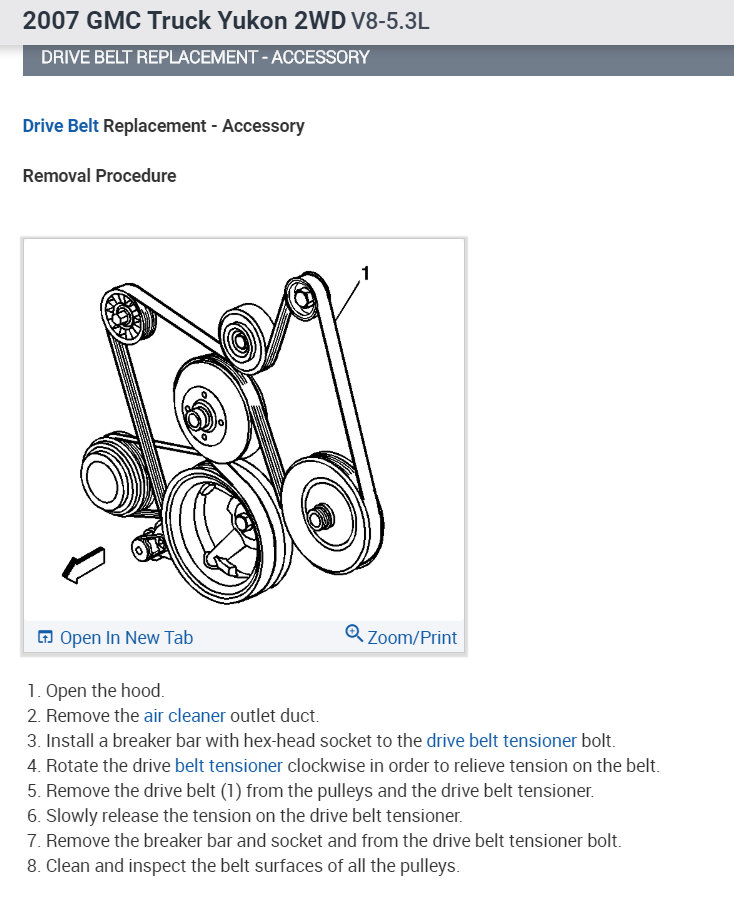

Thanks for the video, it helps. Let remove the serpentine belt and restart the engine to see if the noise is gone. Here is how:
Please upload a video of the belt removed. Please let us know what happens.
Monday, October 28th, 2019 AT 12:01 PM
ADAM SACKLER
  • 45 POSTS
Should I take off the A/C belt too or just the big one?
Saturday, November 2nd, 2019 AT 12:04 PM
KEN L
  • MASTER CERTIFIED MECHANIC
  • 55,130 POSTS
Try the main belt first, let me know. Here are the instructions in the diagrams below.
Saturday, November 2nd, 2019 AT 12:55 PM

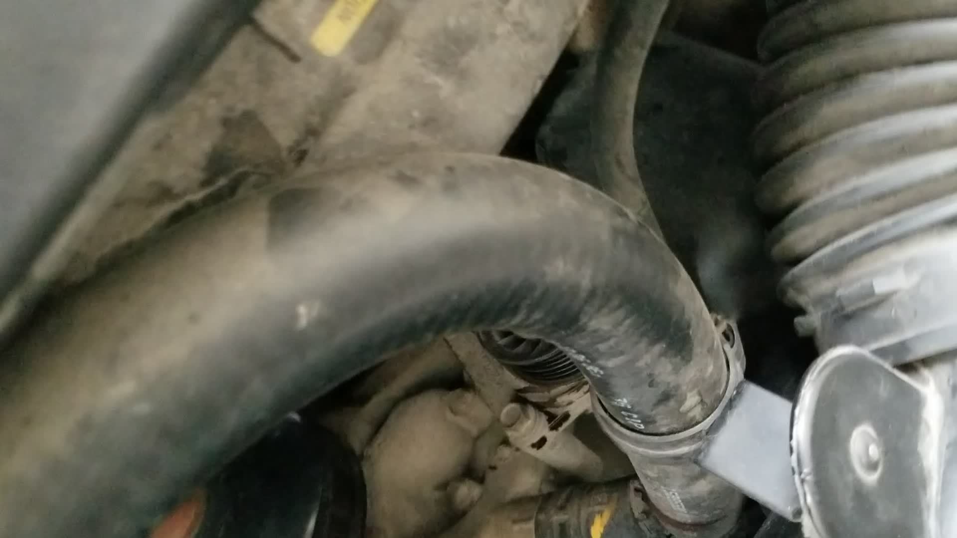

Okay, I watched the video and I'm not sure if it sounds problem free without the belt or not. I can kind of hear a sound in the video and I wasn't sure if it was a rattling or not. But it sounds so much better without the belt. It wasn't on the video but when I was standing there recording it I was hearing a humming sound. I wasn't sure if that was because the belt was off or if that is a problem also. Does this help? Do you know what the problem is?
Saturday, November 2nd, 2019 AT 2:15 PM
ADAM SACKLER
  • 45 POSTS
I ordered a transmission control module because I think that is the source of my problems, or at least some of them. Did the video help? Were you able to figure anything out?
Sunday, November 3rd, 2019 AT 4:41 PM
MASTERWRENCH
  • 258 POSTS
I agree, it sounds significantly better. It appears one of your engine accessories has a failed bearing. I would start by spinning each pulley (including the tensioner) and see if any of them feel rough. Based on the severity of the noise, I would expect you'll be able to feel it pretty easily.

Actually, I forgot about the position of the tensioner pulley when I tested it and it was resting up against something since it is not in tension. I pushed it out with my ratchet and gave it a spin and it is rotating just fine, the idler pulley also is rotating freely and so is the alternator. The power steering pulley does not make noise when I rotate it and seems to turn smoothly but does not rotate freely when I spin it, it will only make a rotation or two before stopping. The water pump pulley rotates freely but makes a noise when I rotate it.
Monday, November 4th, 2019 AT 1:08 PM
MASTERWRENCH
  • 258 POSTS
The water pump sounds pretty rough to me too. I would definitely say that's the source of your noise. Below is the procedure on how to replace a water pump. There's also a great video of the procedure towards the end of the article.
https://www.2carpros.com/articles/water-pump-replacement
You may also want to verify that the belt tensioner arm is not binding. When you load and unload the spring tension on it, make sure it moves smoothly from the full tension point to the fully unloaded position.
