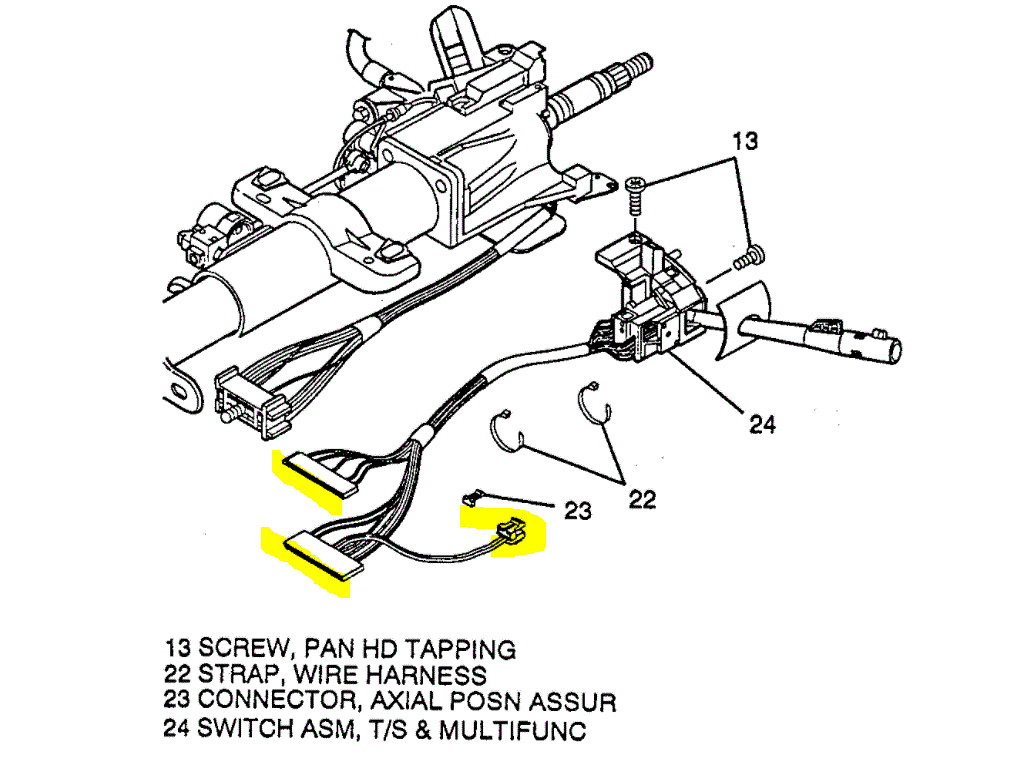

If it starts working when you hit the steering column, it sounds like the switch is bad or there is a loose connection. Since they do work at times, the fuse isn't the issue.
I attached a pic below and highlighted the connectors to check. Just make sure they are tight and not damaged. You will likely need to remove the bottom of the steering column shroud.
Let me know what you find. Also, replacement of the switch isn't a 10 minute job, and will require some special tooling. If we find there are no wiring issues, let me know if it will be something you are comfortable doing.

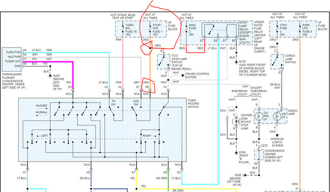

Lets try to work through this. There is a fuse specific for the flashers (Haz). If it is blown, the brake lights won't work either. Confirm they work.
Next, if the brake lights work and the fuse is good, I need you to check for 12v power at the orange wire at the switch. It should have 12v at all times.
If there is no power to the flasher switch but the brake lights work, there is a splice in the orange wire which should be near the brake light switch under the dash. That splice may be bad and only allowing power to the brake light switch.
Take a look at the pic I attached. Confirm the fuse is good as well as make sure it has power to it even if the fuse looks good. I circled the fuse, the wire at the haz switch, and the splice between the haz and brake light switch. We need to determine where power is lost.
If the switch is still the original one, it may have failed. We will know that when we determine if there is power to it.
As far as the flasher you replaced, it also controls the haz flash, so we know that is good.
Let me know what you find Also, here is a link that explains checking for power at the fuse. I don't know if you need it, but I thought I would add it.

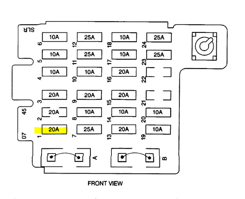

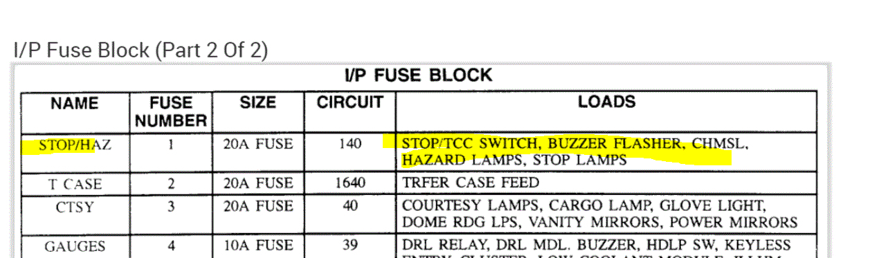

  • 110,194 POSTS
If the brake lights are working, chances are the fuse is fine.
I attached two pics below. The first shows what items are powered by that fuse and the second shows location. It is under the dash behind the instrument panel.

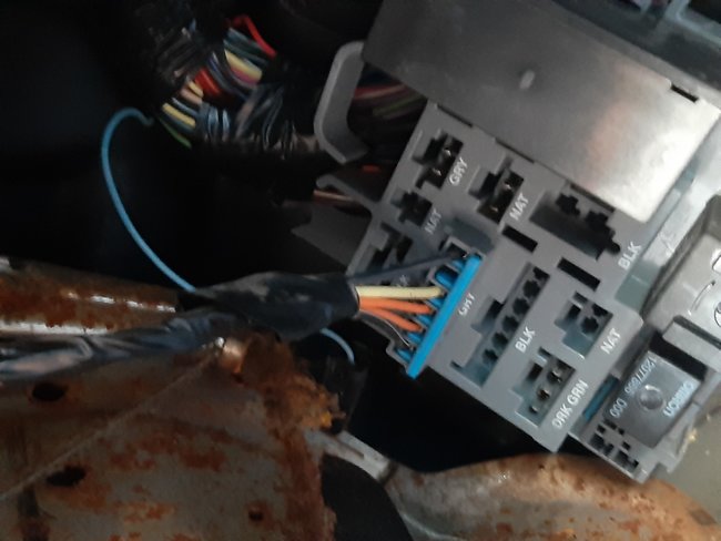

Is this what I'm looking for?
Thursday, October 8th, 2020 AT 1:37 PM
  • 110,194 POSTS
No, that isn't the fuse box. It should be under the dash. It will have several fuses in it. If you look at the second pics I attached in the prior post, that is what it will look like.

That fuse is a breaker. I'm trying to find the orange wire.
Thursday, October 8th, 2020 AT 7:56 PM
PTRHIP
  • 12 POSTS
That fuse box is on the side of dash between drivers door and dash, btw.
