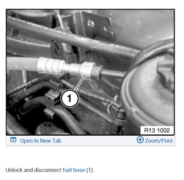

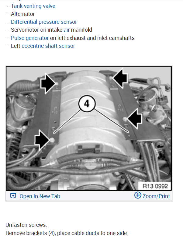

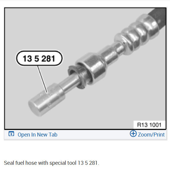

Yep, I agree, I would replace the spark plug again and be careful not to crack it. Next, I would do a com pression test and if okay replace the fuel injector, this can cause the codes you have, please clear them after the repair. Here are two guides to help and I have included how to change the fuel injector out as well.
and please go over this guide as well:
Check out the images (below). Please upload pictures or videos in your response of any problems so we can see what to help you with.
