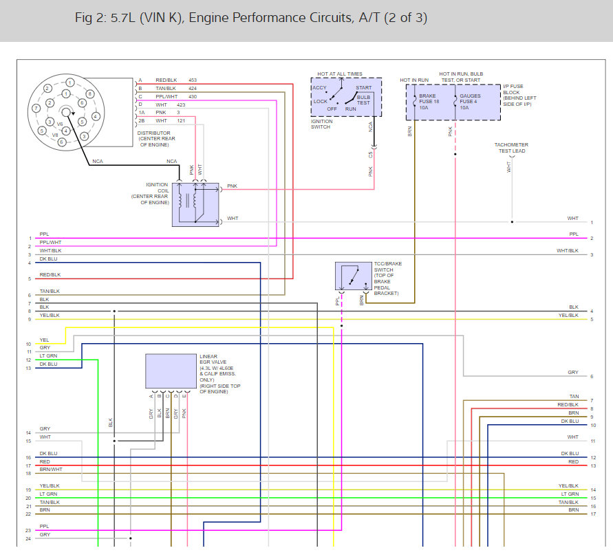

Always cranks but occasionally does not start. Starting fluid does not help as there is no spark at those times. Have removed ignition module and had it tested. Both AutoZone and Napa tested module and say it is okay. Tested coil resistance and both circuits are in spec. The factory tachometer lead comes from the coil but the tachometer is not accurate or even close when engine chooses to start and run. Is there another test for coil/tachometer pick up? Tachometer problem came up at same time as the starting problem.

When the ignition spark stops and the key is on do you have power on both sides of the coil? (Not cranking over.)

The truck started again so I let it run for about twenty minutes and it then stalled. So now I have the "cranks but will not start and no spark" condition. The two wires from the ICM to the coil show no voltage with the key on. Of the other two wires connected to the coil, one shows 12.18 volts with the key on. The pattern seems to be that it runs until it gets warm, stalls, and then wont start again until about twenty four hours later.

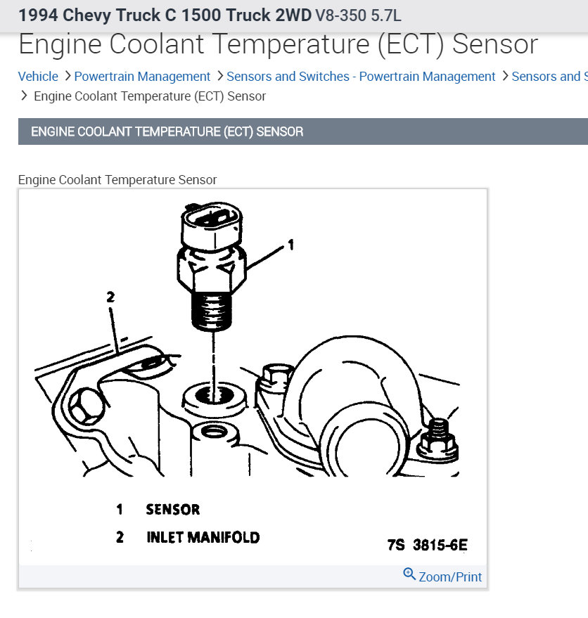

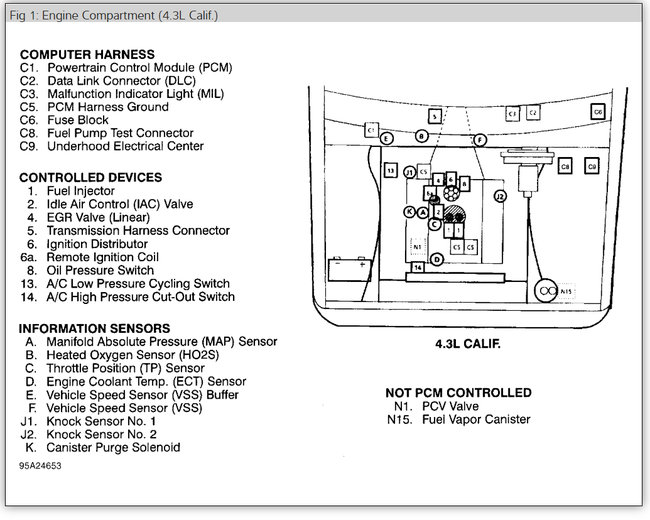

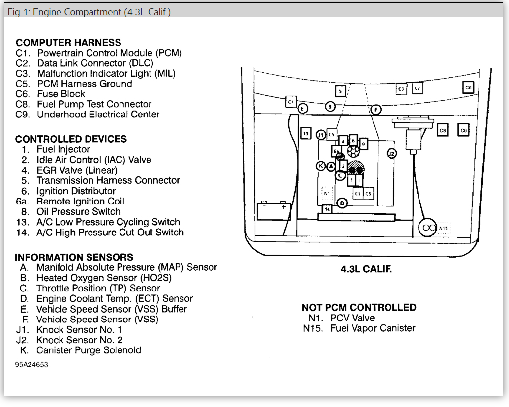

This sounds like the engine coolant temperature sensor is shorting out causing the PCM to cut the ignition control. I have seen this problem before. Here is a guide to help you see what you are in for when doing the job and the location of the sensor for your truck:
https://www.2carpros.com/articles/coolant-temperature-sensor-cts-replacement
Wednesday, August 8th, 2018 AT 10:23 AM
CLIFF ARTHUR
  • 8 POSTS
Installed new coolant temperature sensor. Started and ran for about fifteen minutes, made a clunk like noise from under hood and stalled. Now have "no start no spark" condition again.
Thursday, August 9th, 2018 AT 8:32 AM
KEN L
  • MASTER CERTIFIED MECHANIC
  • 55,481 POSTS

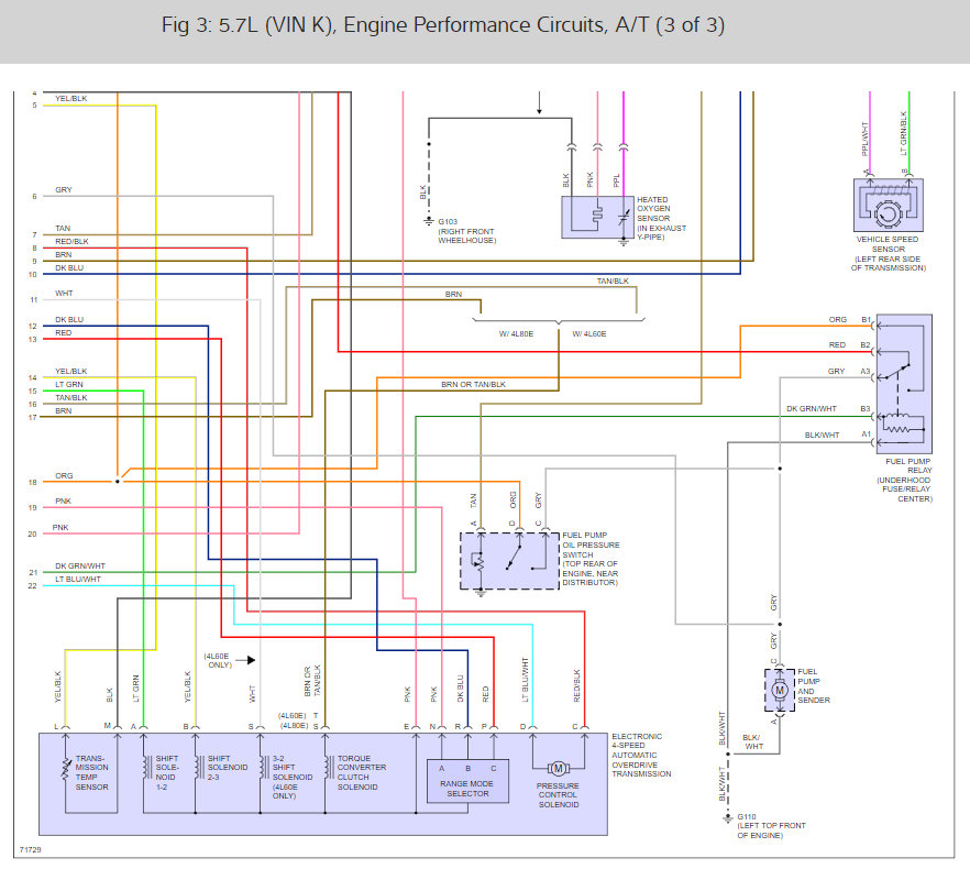

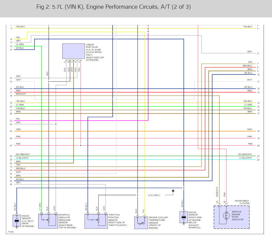

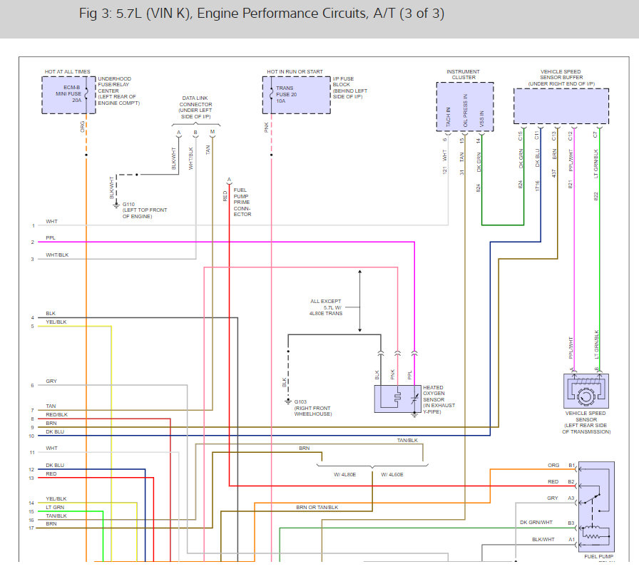

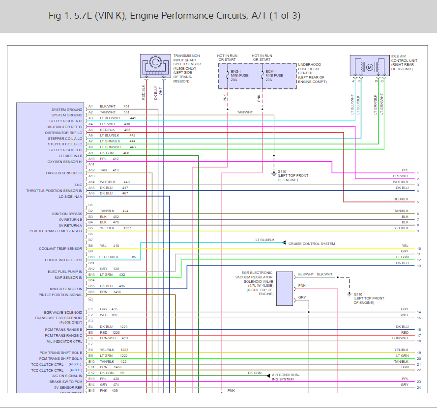

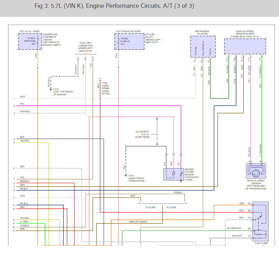

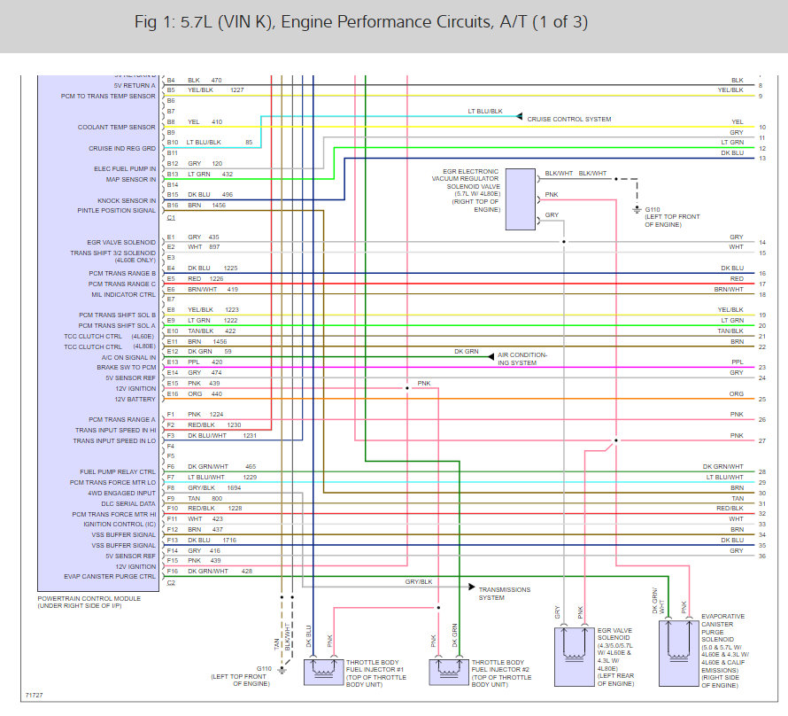

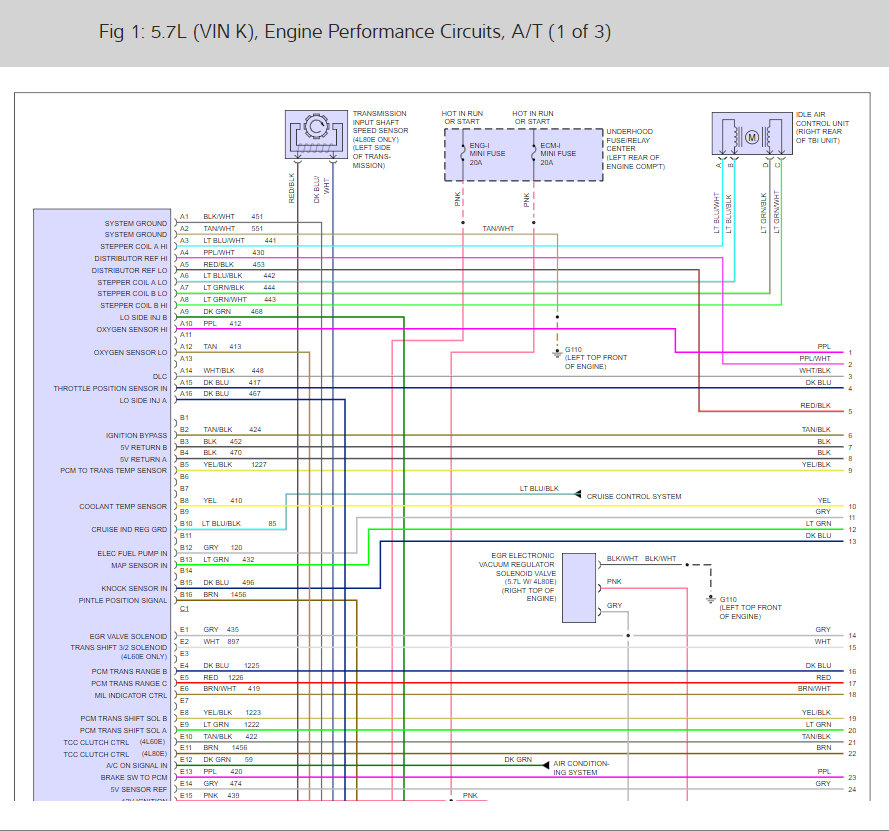

Does it crank over okay sounds normal can you make a video and upload it here in your response? I can hear if the engine has a mechanical issue. If the engine is okay lets test the wiring because it sounds like the PCM could be the problem. Here is a guide to help us check the wiring and the engine wiring diagrams so we can see how the system works. Check all power and grounds if everything checks out try a used PCM. Here is the location:
