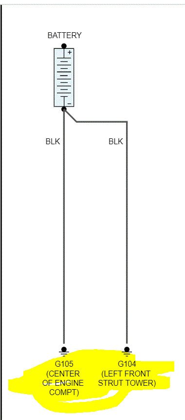

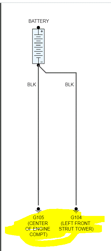

Next, check the battery terminals. Make sure they are clean and tight. Confirm the ground from the battery to the engine and body are in good condition. Make sure they aren't loose or corroded.
I attached a pic below indicating ground locations from the battery.
See pic below.

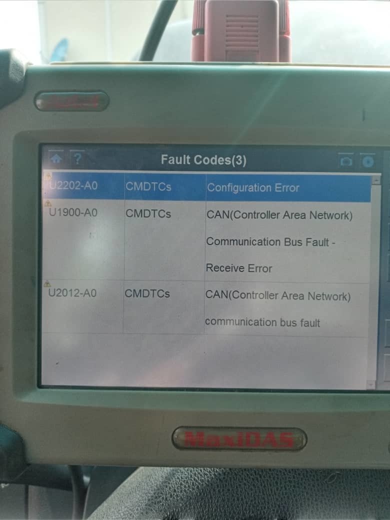

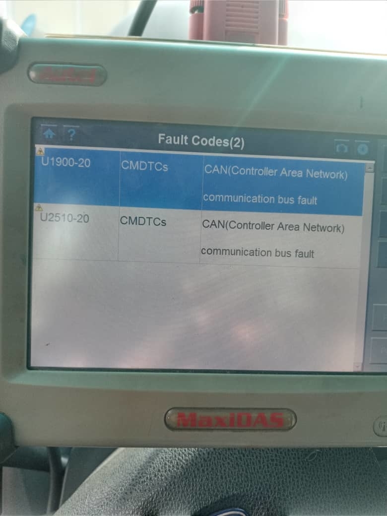

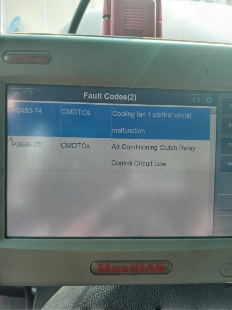

Good evening, I have scanned the CAN BUS system. It passes all the control unit except three.
1. Instrumental cluster.
2. ABS.
3. Power-train.
The snapshot is shown below.
Thursday, April 29th, 2021 AT 3:02 PM
BLESSING EWOBOR
  • 754 POSTS
The first picture sent above is for the Instrument cluster (fault code), the second is for ABS, and the third one is for the power train.

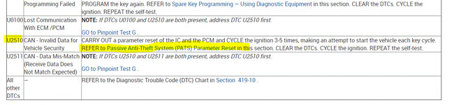

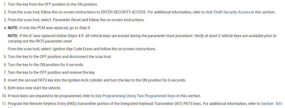

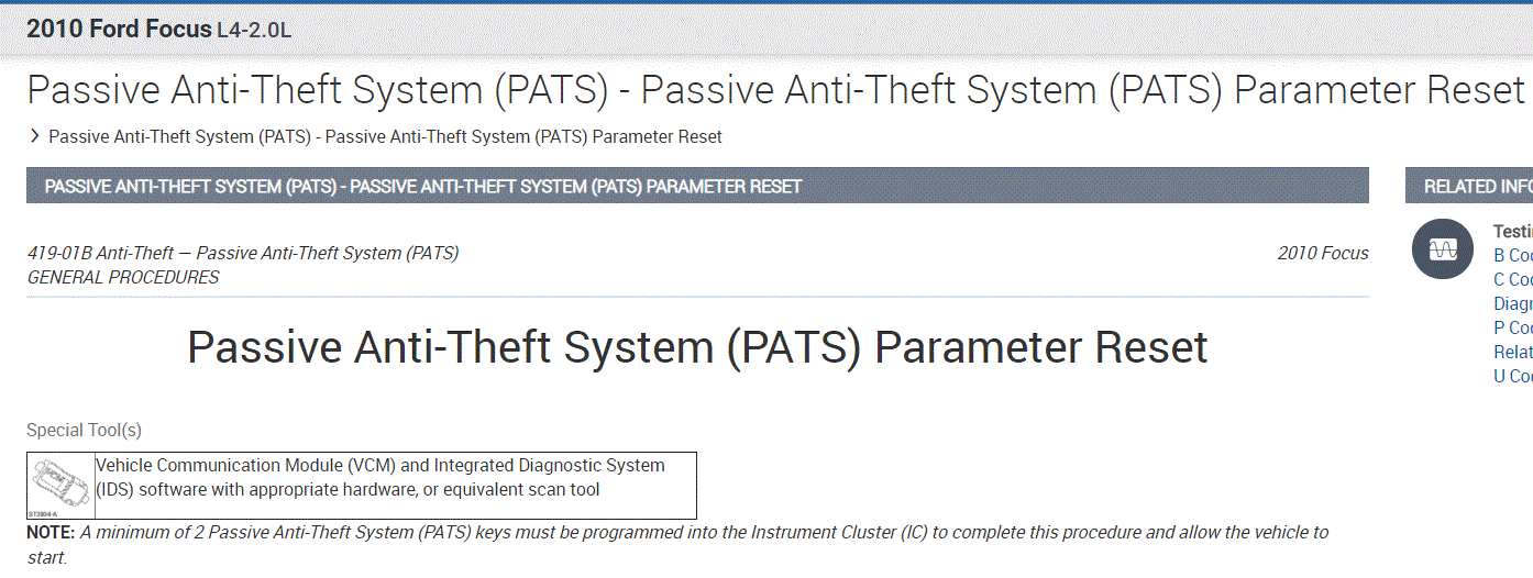

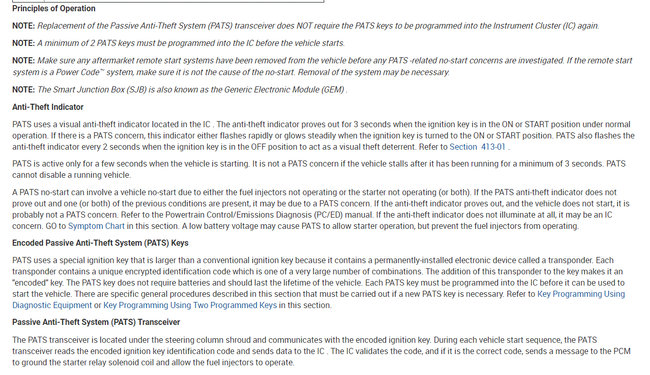

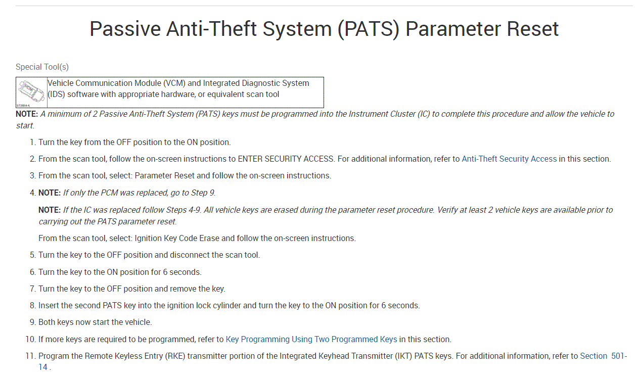

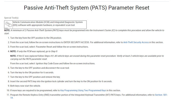

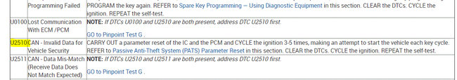

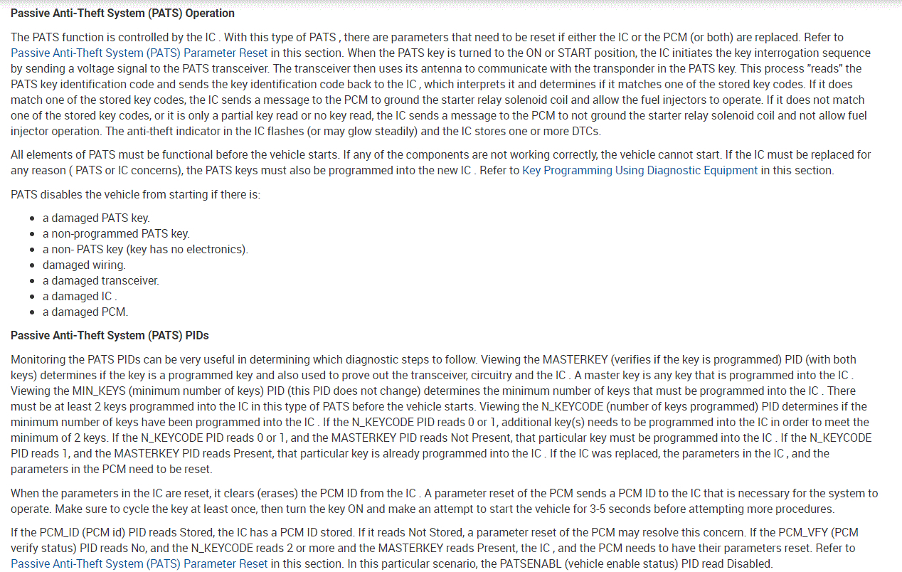

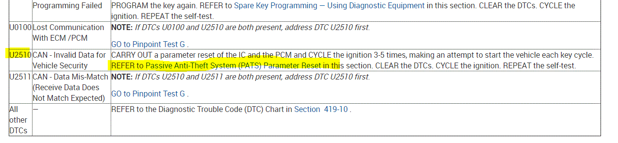

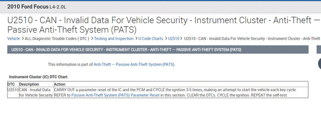

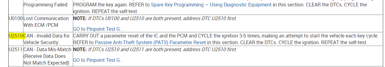

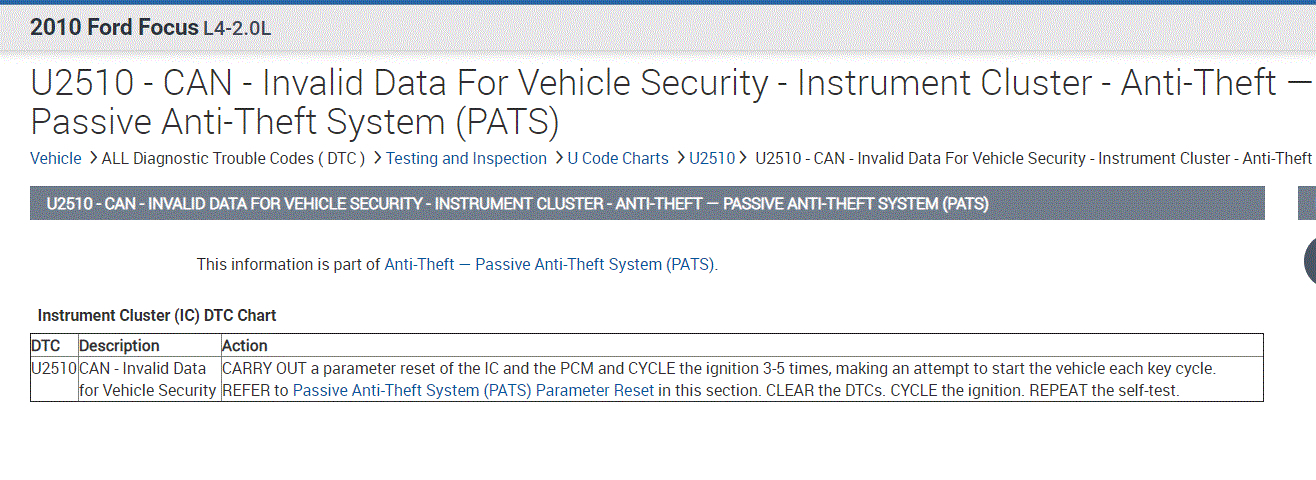

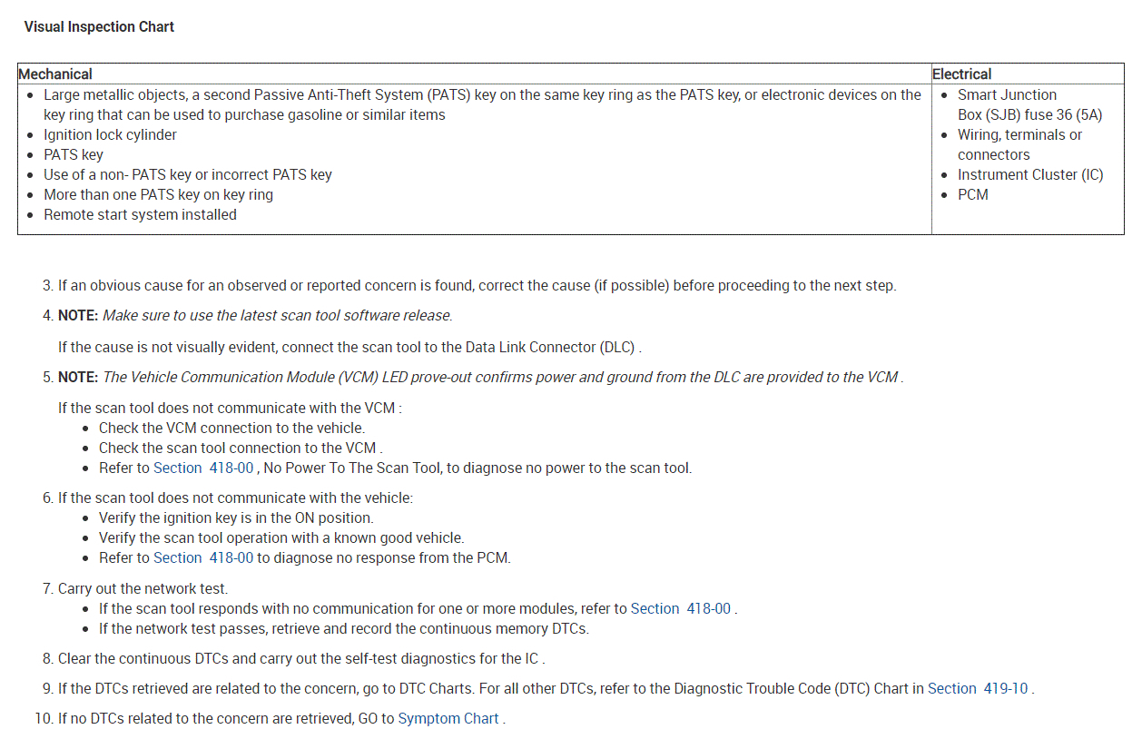

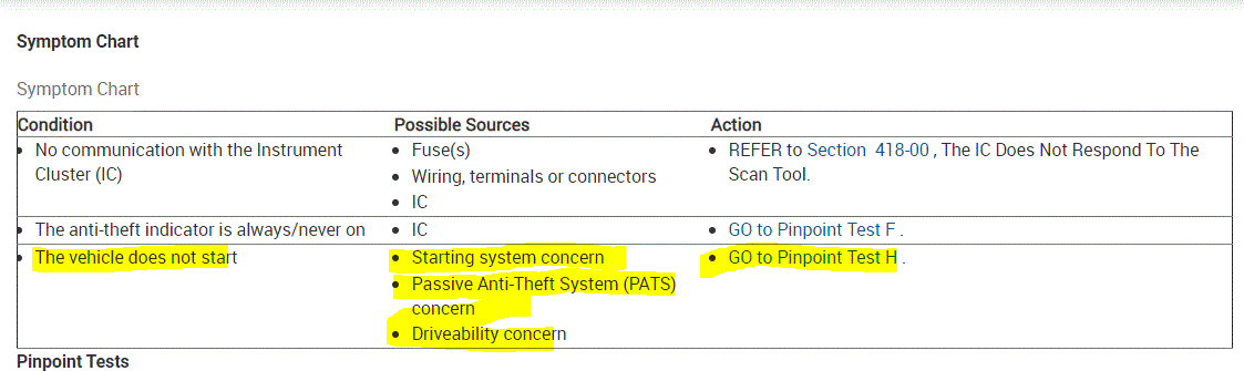

The U2012 is related to a can communication with the ABS, so I don't think that is causing the vehicle to stall. The one related to the AC wouldn't either. The code that I have the most interest in is the U2510. That deals with the (PATS) passive anti-theft system. That can cause a no-start.
I suspect the PATS system is not recognizing the key when the problem is happening. Have you tried a parameter reset with the keys/PATS?

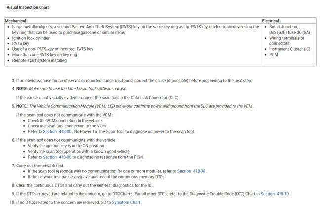

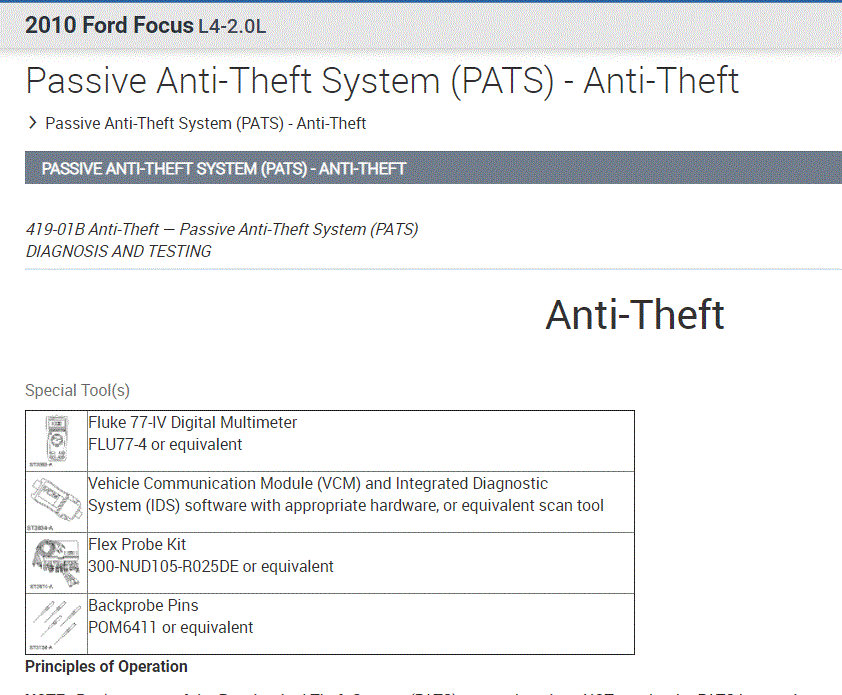

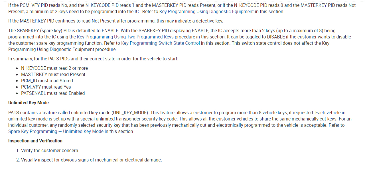

Take a look at pic 1. It defines the code I'm questioning. The remaining pics are where it takes me for the reset.
I'm not saying it isn't a problem with the CAN, but it seems to point in the direction. At least that my theory at this point.
If you look at pic 4, it shows what to do if you have a U2510, and that is what I mentioned above.
As far as the resistance you listed, it is within spec.
Let me know if this helps.

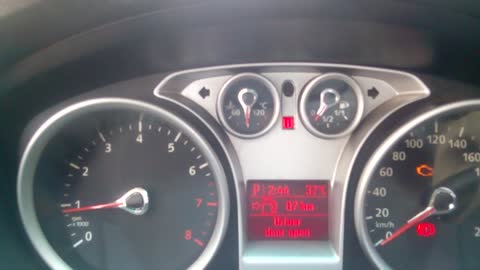

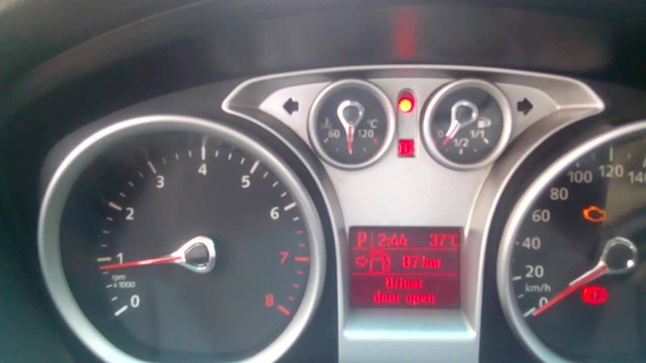

Hello. Checking the vehicle, I realized that once the instrument cluster is pushed somehow, the symptoms will manifest. At the point of the manifestation, I measured the termination resistance it was 119 ohms, the voltage at Can H was 4.4volts while on Can L was 4.1volts. Shaking the instrument cluster again and again it might normalize at this point the termination resistance was 60 ohms and the voltage at the CAN H was 4.4 and the was 2.1, with these the vehicle is functioning properly.
Tuesday, May 4th, 2021 AT 10:50 PM
BLESSING EWOBOR
  • 754 POSTS
This is a short video clip on it.
Tuesday, May 4th, 2021 AT 10:57 PM

Based on the resistance prior to moving the cluster, it sounds like a partially broken or corroded connection. Also, based on the video, the cluster is bad and causing the issue.

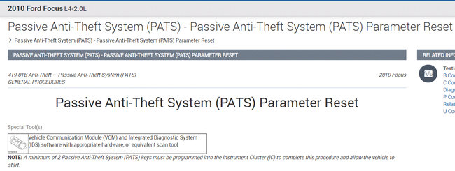

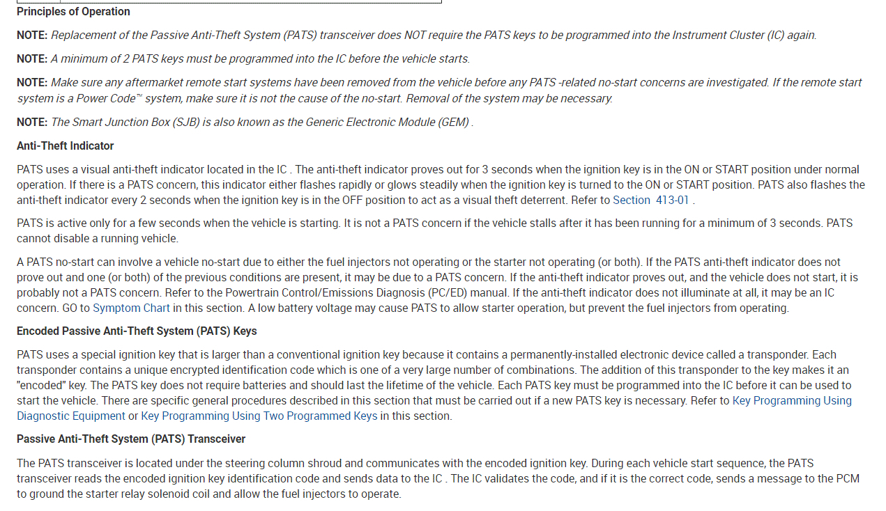

I went through everything related to the 2510. It walks me back to the parameter reset. Have you done that?
Take a look below. I started with the code and worked through until it took me to the test required.

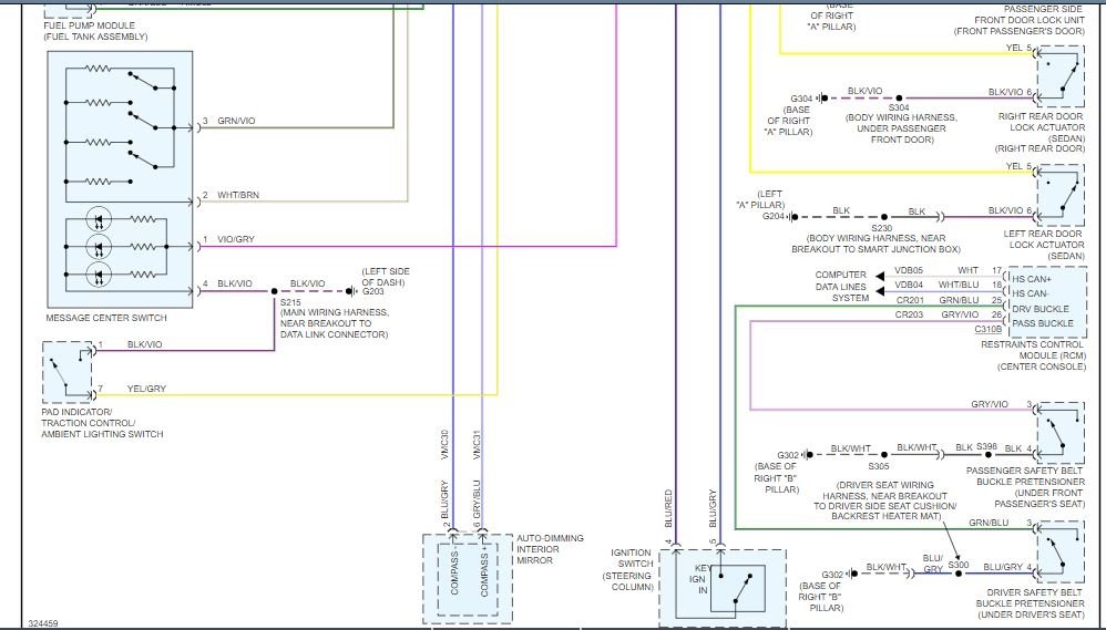

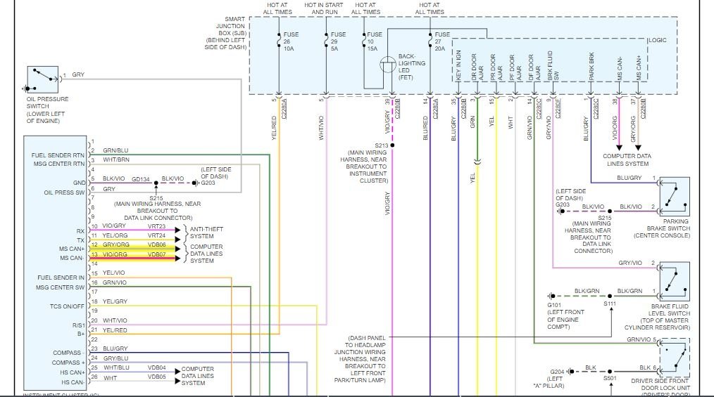

Good morning sir, which of the wires is for the can bus at the instrument cluster and how would the signal looks like when observed on oscilloscope?
Wednesday, August 4th, 2021 AT 11:40 PM
Good afternoon,
I attached the connector for the cluster. I highlighted the wires for the CAN network.
You have the correct resistance for the line which indicates there is not an issue with that line.
Whatever module it is connected to is pulling down the line causing the issue.
It is pointing right at the cluster and you verified it by moving it around.
Inspect the connector for any damaged or corroded wires.
