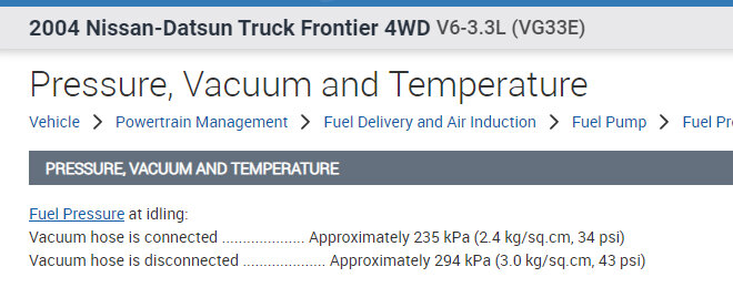

My vehicle listed above had a shut off switch on the fuel pump relay that I installed. The switch wiring chaffed and failed so I removed it and went back to the original fuel pump relay wiring. The truck ran normally for 5ish months. 2 weeks ago, it cranked and wouldn't turn over while I was trying to start it. I got it to turn over with starter fluid, and it was also getting fuel and continued to run. It started idling low a few times but once it ran for about 15 minutes it was idling and revving normally. I then replaced the butt connector/heat shrink on the relay wiring and let it cool down for a couple hours. I came back 2-3 hours later, and it started up no problem, idling normal. Then I tried to start it a day later and it would crank but not turn over. I can hear my fuel pump priming when it cranks but doesn't start. I am going to try to replace the fuel filter to eliminate that. If your're able to share any wiring diagrams for the fuel system that would be great as well. Thank you

You may hear the fuel pump, but it may not be producing enough pressure to run the engine. I would recommend checking fuel pressure. You will need a fuel pressure gauge, but most parts stores will lend one to you.
Here is a link that explains in general how it's done:
The idea that it started with starting fluid indicates it is a fuel-related issue. Keep in mind that the pressure may be good, but we could also have an issue with an injector pulse. But that is something we will check after the pressure is confirmed.
I attached the manufacturer's fuel pressure specifications below. Also, let me know which schematics you will need.
See pic below.

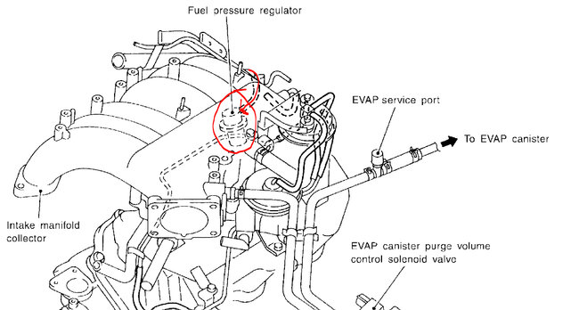

I am going to test the fuel pressure and replace the fuel filter today. The car probably won't start on its own, would it be okay rig up fuel pressure gauge then get it going with starter fluid to measure fuel pressure at idle? Where are the vacuum lines located? Also, I was wondering if I need to bleed the fuel lines of air after doing this, or if the system priming will do that on its own. Thank you so much.

You don't need to start the engine. The fuel pressure with the key on should tell us what we need to know.

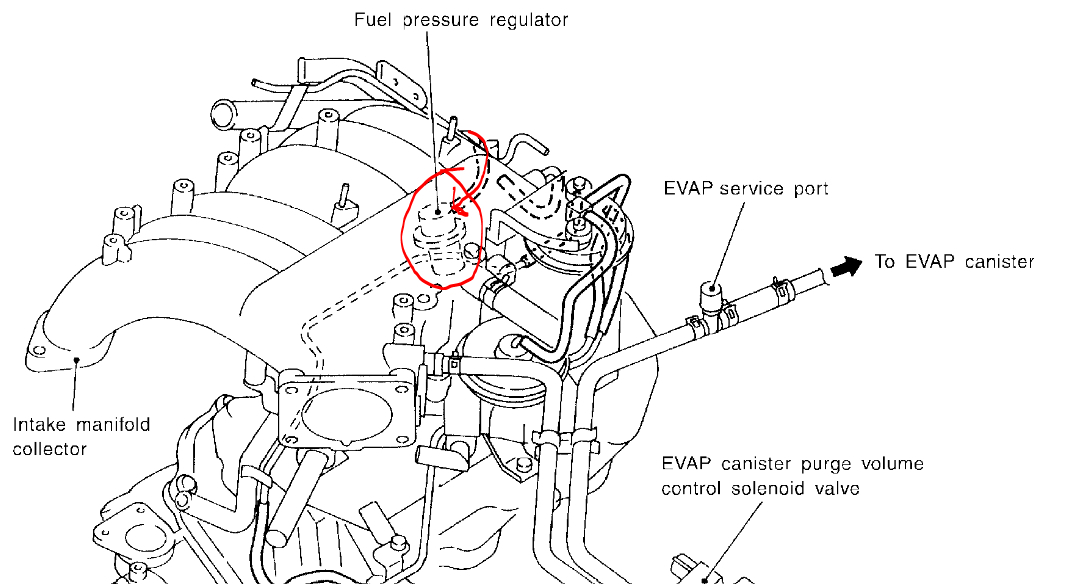

As far as bleeding after testing, no need. It will do it by itself. And vacuum lines are in several areas under the hood. Usually, they will be a black rubber-type hose. The inside diameters are commonly between 1/8" and 3/8".
I may have misunderstood you. If you are referring to the vacuum line at the regulator, see pic 1 below. However, with the engine off, that won't make a difference.
Let me know if that helps.
See pic below.

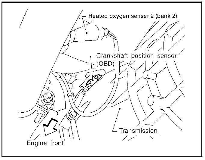

Camshaft Pos Sensor > After cranking car and not being able to get it to turn over w starting fluid, I checked codes. Had 1 code - PO 0340 Camshaft Position Sensor A (Circuit Bank 1 or Single Sensor). I have had this code come up once before, after crank no starting (due to faulty kill switch) a while ago. I tried cranking while watching RPMs and realized they are at 0, not jumping at all while cranking. Camshaft Pos sensor is in the distributor, 12V constant and ground to Distributor/Camshaft Pos sensor tested good. Would need to do more testing to see if camshaft pos sensor is producing correct signals. Are there any other diagnostics you would do relating to camshaft pos sensor and distributor?

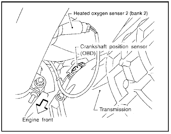

It sounds like there may be more than one problem. The pressure shouldn't drop that fast. Also, if you have no RPM signal, the crankshaft position sensor is my first suspect. (See pic below) If you have a live data scan tool, check to see if there is an RPM signal when cranking.
Next, you could have an injector or injectors leaking. Remove a few spark plugs to see if they are wet with fuel. The engine may be flooded and not starting if they are leaking.

If you have a live signal (RPM), the crankshaft position sensor isn't a likely problem. I know the tachometer is regulated by a signal from the ECM (terminal 3) to terminal 48 of the tachometer.

As far as sensors are concerned, the CKP is what provides the ECM with engine speed. I just double-checked and that is the only thing that is indicated.
