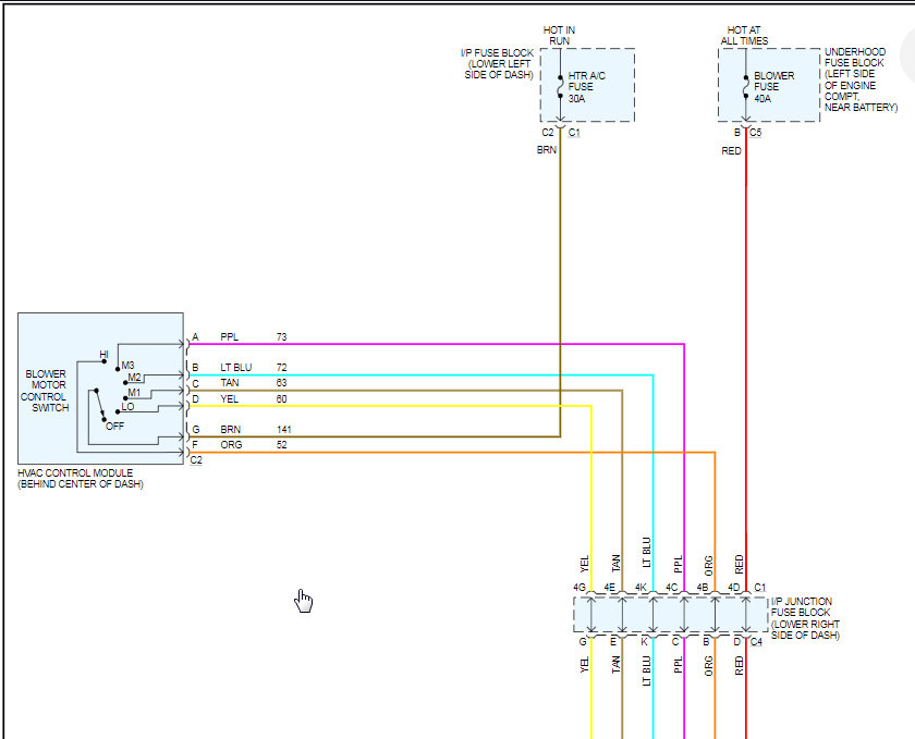

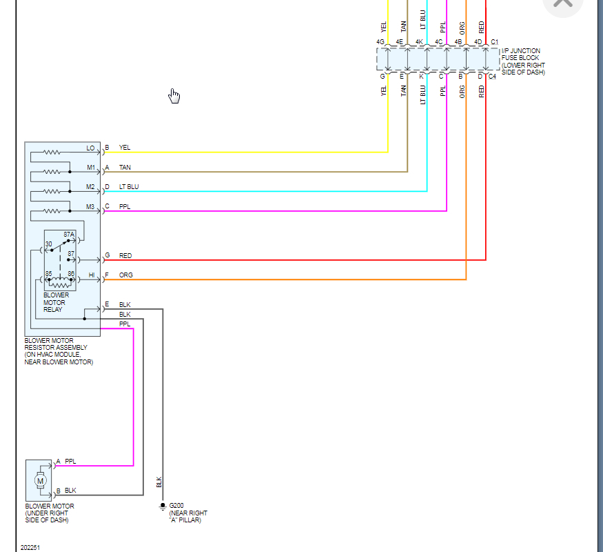

So we need to go to the blower motor and see what we have for voltage. I included the wiring diagrams where we need to check. Basically trace the power back to the two fuses and see where you don't have power and that will tell us what the issue is.

I have a 2006 chevy truck dual control auto temp I have tested the wires at the fan and i'm getting power on the purple wire that plugs into the fan one thing I noticed there is a small purple wire coming into resestor and it has no power to it. Can you help me please

Does fan works when the Black wire of fan motor is grounded?

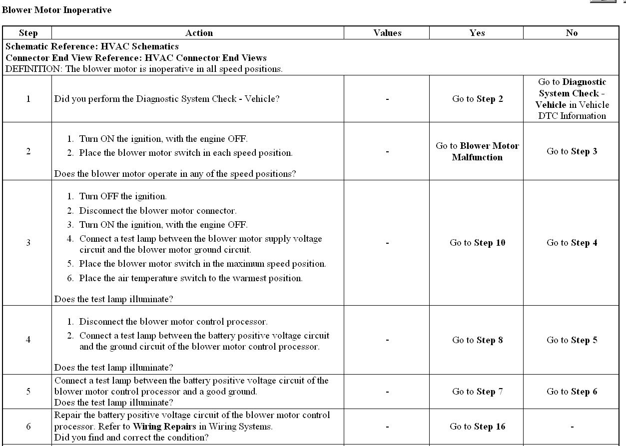

Disconnect the blower motor connector. Turn ignition switch ON with engine OFF. Install a test lamp between the terminals of wireharness. Turn blower speed to maximum. Place air temperature switch to warmest position. Does test lamp illuminate?
Do you mean the Purple/White wire (Purple with a fine White line on it)?
Does blower motor works in any speed?
Friday, April 30th, 2021 AT 2:21 PM (Merged)
MIKEH
I did that test and I have no power, yes the purple/white wire that comes into the resistor it says input on the resistor. I took fan out and hooked power and ground to fan and it worked like that. The doesn't work on any speed when it stopped it was like some1 had turned the speed down slowly. The it stopped. Thanks for the help

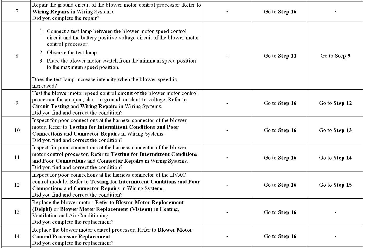

Here are the cmplete diagnostics for the blower motor. Go through and let me know what you find.
MIKEH
Ok thanks I think we have it its the heater control panel in the dash.

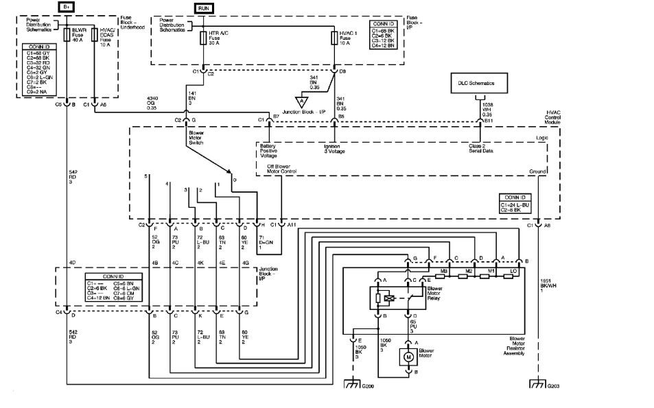

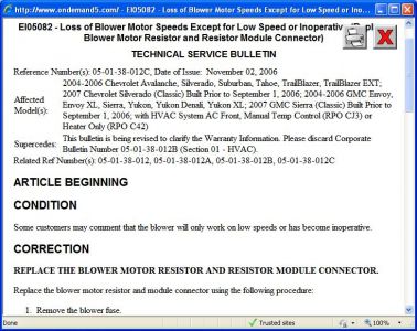

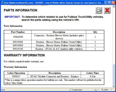

After having a ignition switch replaced at the local dealership my fan motor quit working a few weeks later. Last week I took it back to the dealership and was told there is a resisitor bad causing the problem. In order to replace I would need to purchase a new pigtail which the resistor was built into at a cost of over $250. I feel the dealership was pulling my chain. Any advise? If so are there any wiring diagrams aviable?
Tuesday, May 25th, 2021 AT 11:45 AM (Merged)
SATURNTECH9
  • 30,869 POSTS
https://www.2carpros.com/forum/automotive_pictures/416332_2006_1500LTac_part1_1.jpg
https://www.2carpros.com/forum/automotive_pictures/416332_2006_1500_LT_blower_motor_resistor_1.jpg
https://www.2carpros.com/forum/automotive_pictures/416332_2006_1500LT_blower_motor_bulletin_part1_1.jpg
https://www.2carpros.com/forum/automotive_pictures/416332_2006_1500LT_blower_motor_bulletin_part2_1.jpg
https://www.2carpros.com/forum/automotive_pictures/416332_2006_1500LT_blower_motor_bulletin_part3_1.jpg
https://www.2carpros.com/forum/automotive_pictures/416332_2006_1500LT_blower_motor_bulletin_part4_1.jpg
I solved the wire harness for the blower motor resistor card i posted the bullitin so you could read why you have to get the harness too.I also posted the wire diagram for it as well.If you have anymore questions let me know.
