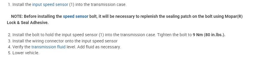

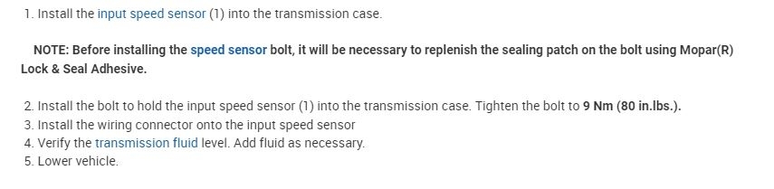

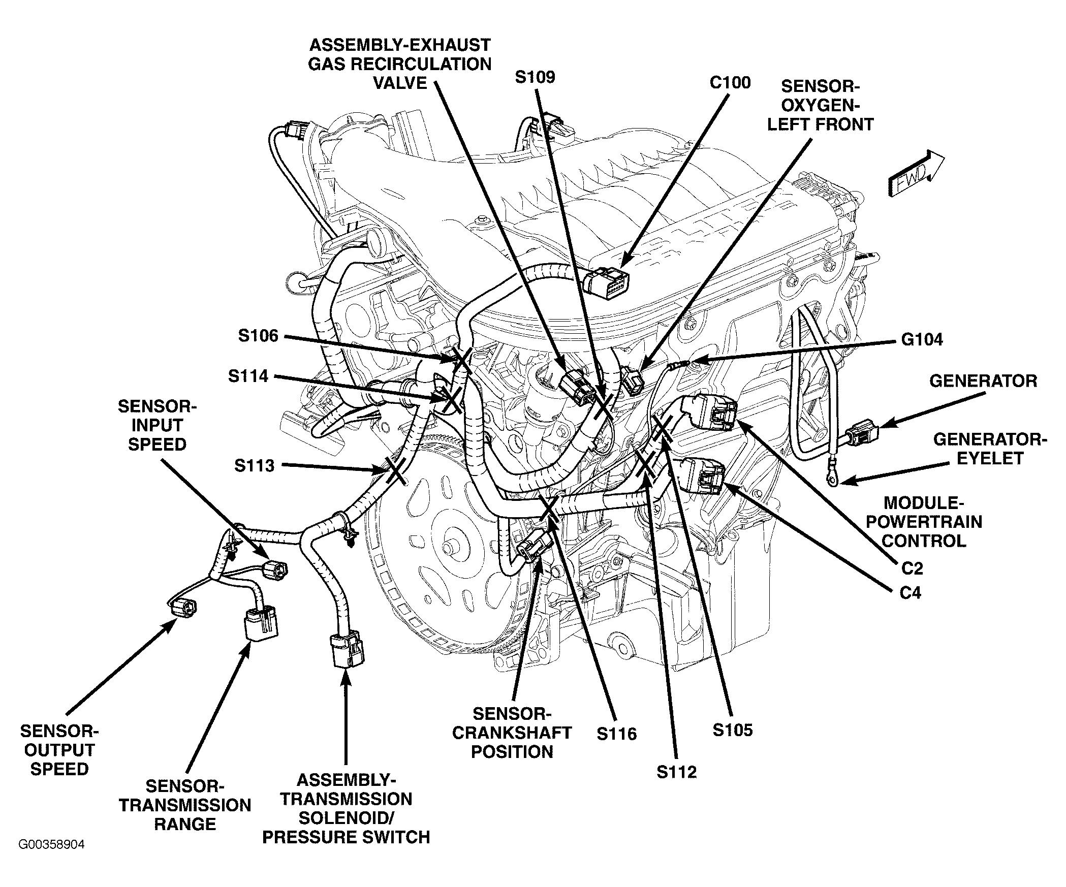

I can't find the location of my input speed sensor on my car listed above. Please help
Monday, March 9th, 2020 AT 10:15 AM
18 Replies
Good afternoon, I attached the location for you with the procedure. What is the reason you are replacing the sensor? Check out the diagrams (Below). Please let us know if you need anything else to get the problem fixed. Roy

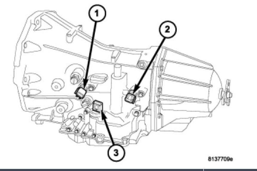

Where is the speed sensor located on my car?
+5
Thursday, November 26th, 2020 AT 11:23 AM (Merged)
CARADIODOC
  • 34,463 POSTS

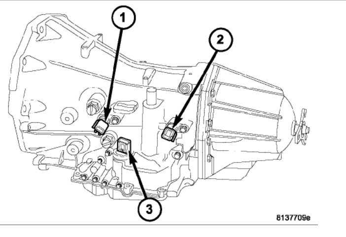

Here is the speed sensor locations on the transmission case. Check out the diagrams (Below). Please let us know if you need anything else to get the problem fixed. The input shaft sensor is #1 and the output sensor is #2

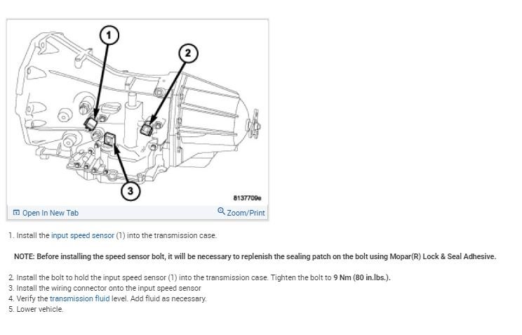

Where is the input speed sensor located on a 2006 chrysler 300c 5.7 liter hemi
+8
JDL
  • 16,098 POSTS
The input shaft speed sensor is located in the transmission near the front here is a diagram to show you the exact location

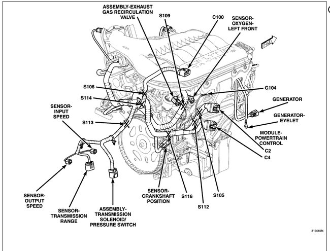

AAUGENTI
  • 2005 CHRYSLER 300
  • AWD
  • 180,000 MILES
Can locate my input speed sensor on my car listed above.
+1
DOCFIXIT
  • 18,828 POSTS
The input shaft speed sensor is located on the transaxle on the right side.
Check out the diagrams (Below). Please let us know if you need anything else to get the problem fixed. Cheers
