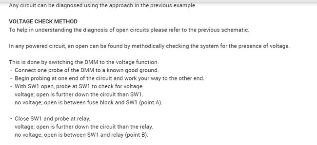

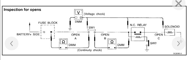

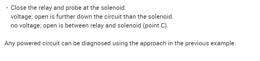

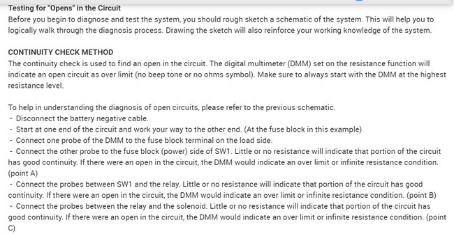

Okay so let's check the dark green/orange wire from pin 6 of the PCM connector to splice 108 of the engine harness for an open. In the diagrams down below I have included a guide on how to find an open in an automotive electrical circuit for you. Please go through this guide and get back to us with what you are able to find out.

I'm sorry. I forgot to put the the guide in the previous reply. Here is the guide for how to find an open in an automotive electrical circuit that I promised earlier. The capacitors collect the Electro Magnetic Frequency [EMF] that results from the collapsing magnetic field of the coils used to fire the spark plugs and then routs it to a ground. This frequency can interfere with crankshaft/camshaft sensor signals, and is famous for causing a hum in the speakers of your car stereo. But first let's check the wire for an open that we talked about earlier, please. Please go through it and get back to us with what you find out.

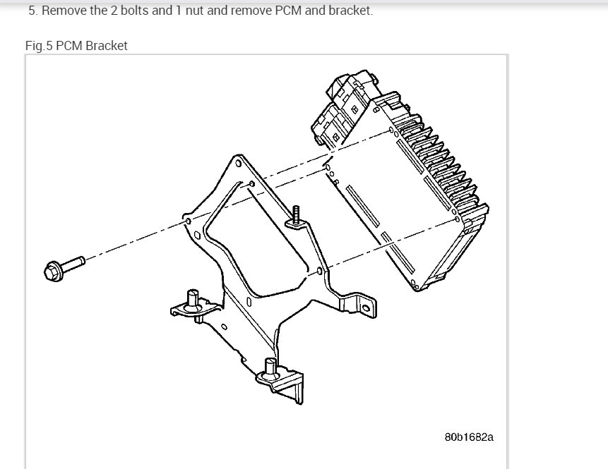

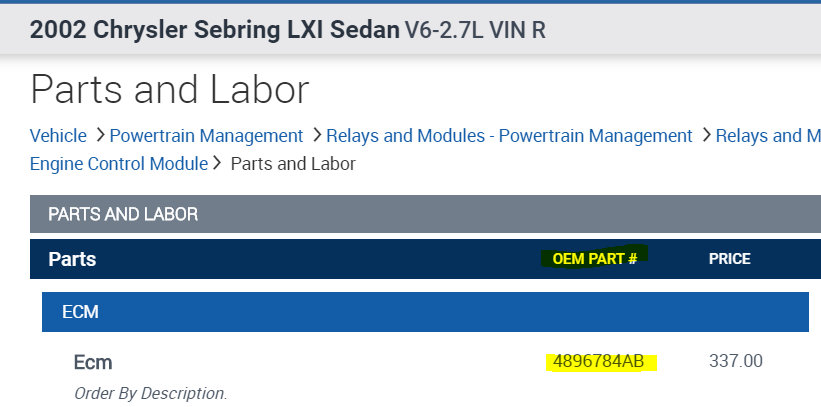

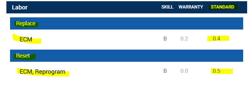

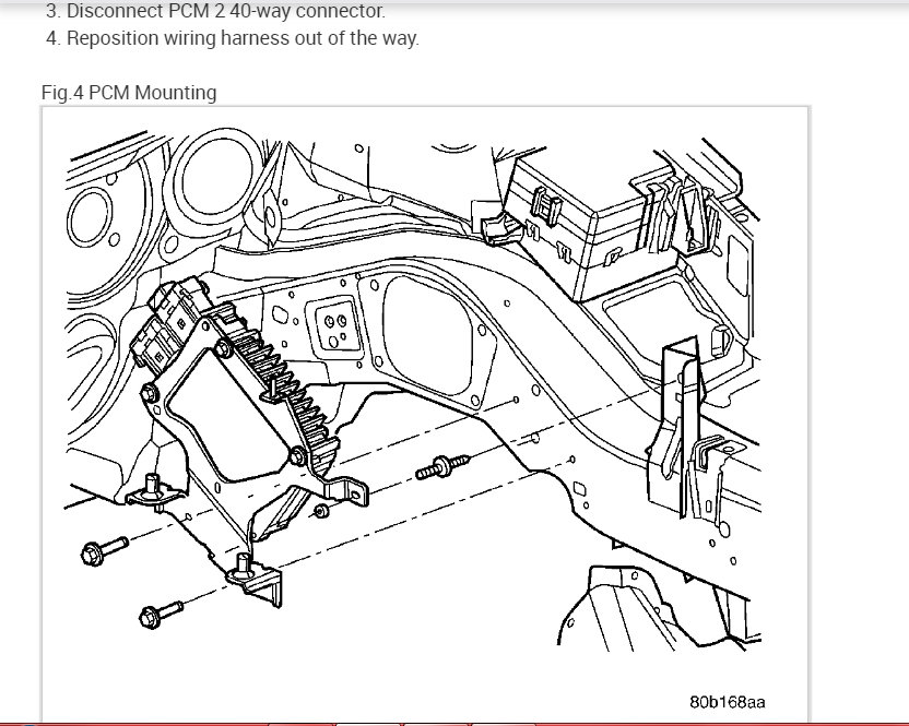

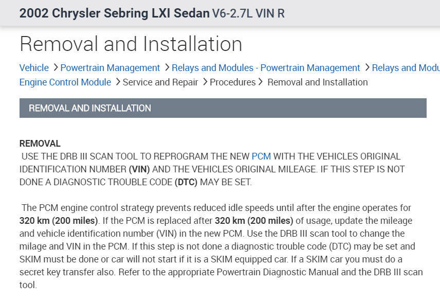

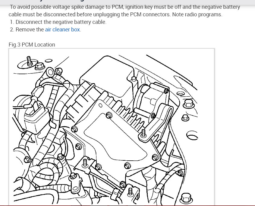

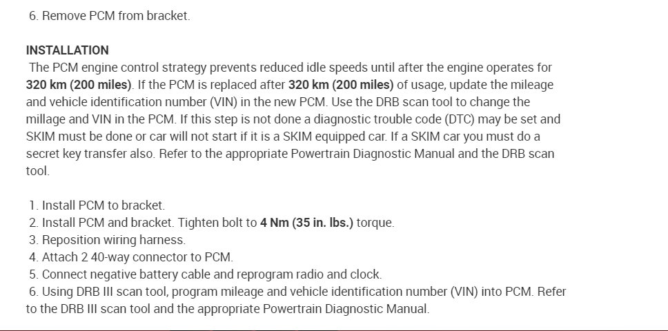

Okay, so if you cut the wire there then we might be looking at a bad PCM. As far as getting the timing chain/belt lined up with the timing marks, if you are able to turn your engine over a couple of times through the four stroke process with no resistance when turning it by hand, other than the resistance of turning an engine over by hand, then you are in the clear for being off on the timing, it's right. That wouldn't cause a no start from no spark either. Having said this, I have included in the diagrams down below the instructions for the removal and installation of your vehicle's ECM/PCM, along with the requirements when replacing said ECM/PCM. It will have to be reprogrammed to the Sentry Key Immobilizer Module[SKIM] at the dealership. I have also included the price for parts and labor for your vehicle's ECM/PCM should you decide to go that way. It looks like the cost for your ECM/PCM, removal and installation, and reprogramming will cost less than I paid for my PCM, used. To get the labor rate take the installation and reprogramming time add them together and then multiply that sum by the hourly shop rate in your area to come up with the labor cost. Also, please pay special attention to the highlighted areas of the guides, and whenever replacing anything electrical on your vehicle, disconnect the negative battery cable BEFORE you start. This will negate any power spikes from damaging sensitive electrical components. Please go through these guides and get back to us with how everything is progressing.
Thanks,
Alex
2CarPros
Thursday, November 21st, 2019 AT 10:10 PM

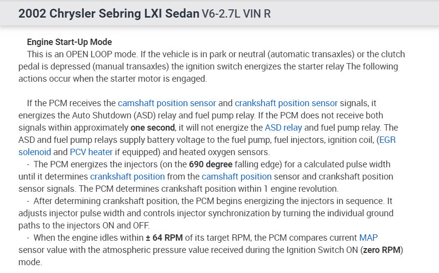

Question, so I unplugged the cam sensor car crank right up the cam wheel was put on back wards buy mistake and I was tapping on it with a hammer and screw driver to force it to seat looks like after realizing it was backward. I can see some small dents on the very outside rim. Could this be an issue an since car did crank? Could it still be a PCM?
Friday, November 22nd, 2019 AT 3:05 PM
SCGRANTURISMO
  • 4,897 POSTS
Hello again,

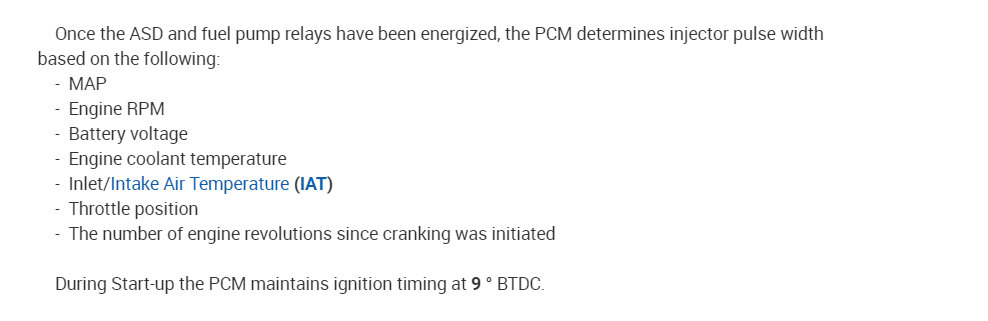

Yes it would. In the diagrams down below I have included exactly what happens with your vehicle in "Start Up" mode. Please go through this guide and get back to us when done. We can go from there with CMP wheel replacement instructions.
Thanks,
Alex
2CarPros
Saturday, November 23rd, 2019 AT 1:12 AM

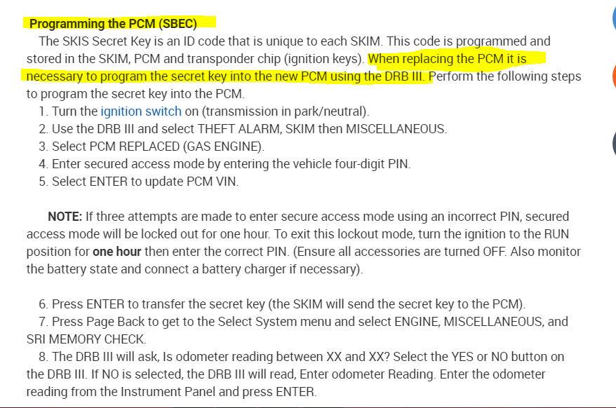

Hello again,

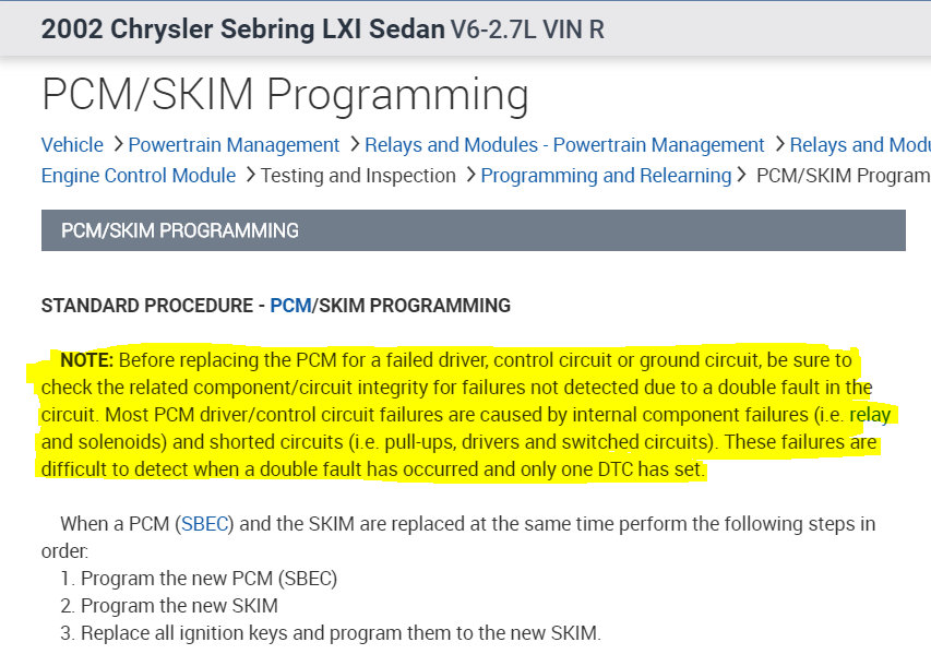

Yes, I still think that your vehicle's ECM/PCM has bad drivers in it. If you read what I sent last time, it says that when the ignition switch is turned to "start" and the ECM/PCM receives both CKP and CMP signals it will energize the ASD Relay, which your vehicle does, but the fuel injectors or ignition coils are not getting power, which only leaves the drivers from the ECM/PCM. You can have your vehicle's keys programmed to the new ECM/PCM either at the dealership or by a locksmith. There are no other options here.
Thanks,
Alex
