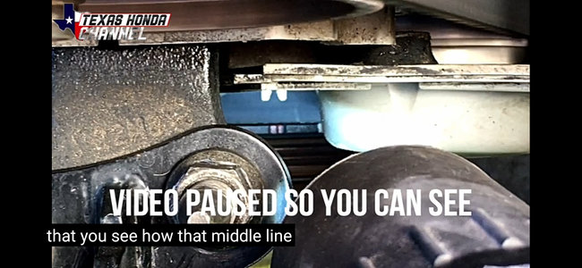

I the car listed above SE that hit the gas. Now it acts like it want to stall at the stop sign. Someone said the timing could be off. So I was going to check it and I found a video that is similar and I took a screenshot of it to see if that is correct.

This is what I found on YouTube:

I'm not sure what I am seeing in the pic. It looks like the transmission pan.
As far as the issue, timing usually doesn't change unless something is left loose. And actually, it isn't adjustable on this vehicle.

The picture was a screenshot from ignition timing on another vehicle similar to this one and I was trying to do ignition timing.

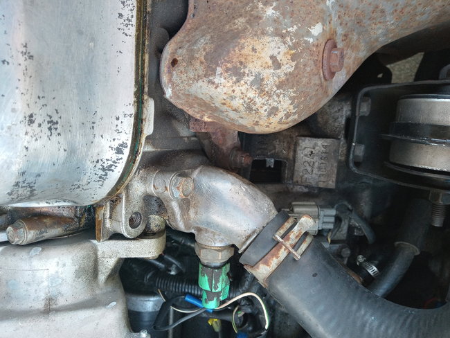

This is the one I'm messing with.

I don't mean to be a pain, but I'm looking at an exhaust manifold and a thermostat housing. Neither one deals with timing. Also, the timing is not adjustable. It is controlled by the PCM.
If possible, record it cranking and running so I can hear it. If it is a timing issue, I should be able to tell when it is cranking.

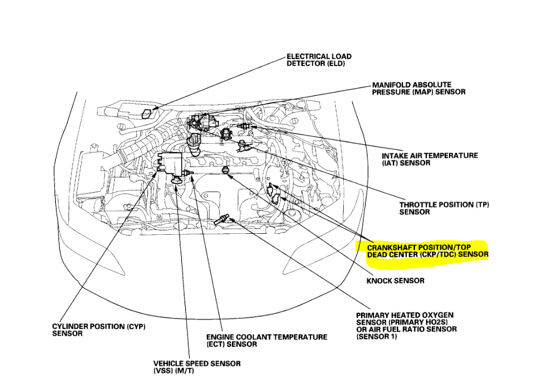

Do you mean there are no codes? A faulty crankshaft position sensor can cause issues and not set codes. Take a look through this link:.
I attached a pic below showing its location. Check to make sure there are no damaged wires or corrosion at the connector.

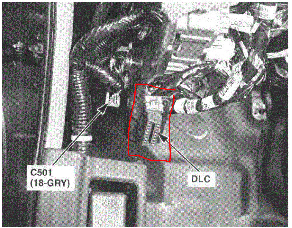

Why can't you check it? Do you have a scan tool? The data link connector (DLC) is above the left kick panel under the dash. See the attached pic.

This one doesn't have the obd 2 I don't believe so they said check the blue connector and jump it and do it that way I contacted the dealer they said they the only ones that can and I said that's bull.

I have to be honest. I'm not sure what you are dealing with. Vehicles after 1995 were required to have an OBD2 system. I have no idea what they are asking you to jump.
