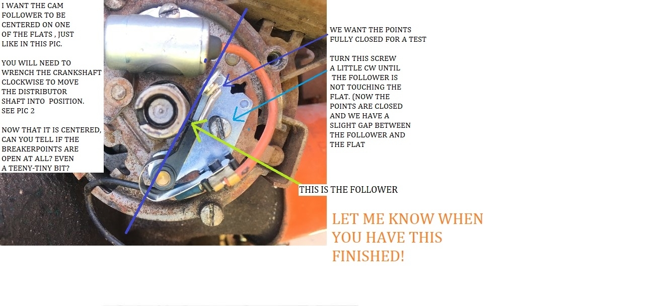

CJ MEDEVAC
  • 11,004 POSTS
Okay.
Is the cam follower (plastic piece on the points that rides the hex) still in the flat spot of the hex as it was in your picture that I "painted" on?
If so, that is where we want it!
Now, turn the adjusting screw CW (clockwise) until you see the cam follower lift slightly off of the flat of the hex (the whole points assembly will move). This gap you make between the follower and the flat will insure the breaker points are actually closed (touching)
Let me know when you are there, then we will do a test!

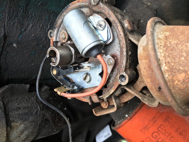

Here is where we are standing now.
Saturday, November 10th, 2018 AT 1:44 PM

Pictures below.
Maybe I have explained this a little better/different.
Let me know when you have done this.
Then we can move onward to a good test.
Still lost? Let me know.
The Medic

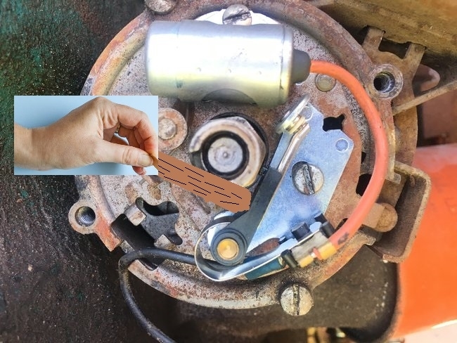

The beaker points now touch!
Turn on the ignition (key) to "on".
Do this when it is kind of quiet and maybe not so bright (not in the sunshine).
Insert a Popsicle stick or plastic whatever between the distributor shaft and the point arm.
Warning!
If you use something metal you will probably get shocked!
Twist or pry with the stick to barely crack the points apart.
You should hear a faint pop along with a blue spark between the breaker points.
Pry it open barely but very quickly over and over and over, you should get a pop, pop, pop, pop, pop along with the blue spark each time!
Nothing?
Turn off the key.
Fold a small piece of fine sandpaper in half or grab your cardboard fingernail file. Pry the points open and insert your sandpaper or cardboard fingernail file between them. Let go of the points and commence sanding for a minute or so! Remove the sanding device.
Start over!
Key on.
Popsicle stick
Pry.
Results? Popping? Spark?
Whatever happens (or does not), I am ready to tell you what to try next!
Picture below.
My keyboard has something under the "R", sorry if my "Rs" do not show all of the time!

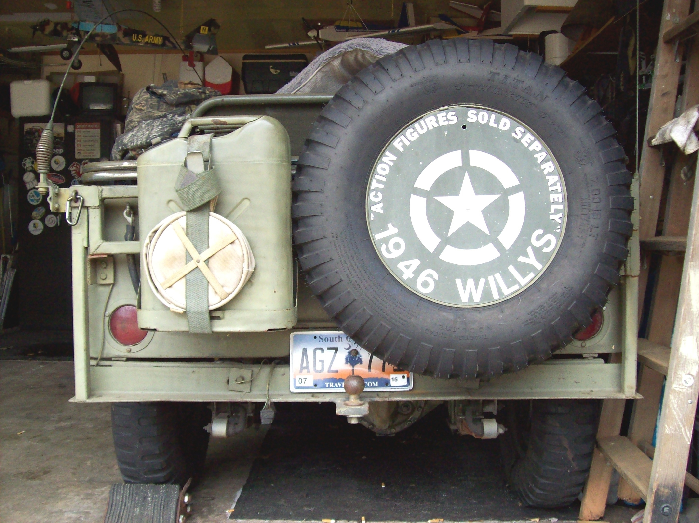

Do you have a voltmeter?
$5.00 at "Harbor Freight", maybe $20.00 at a parts store.
Got to have one to continue. You can use it forever and ever.
Like my pictures huh?
I really try to get things down to K-3 level.
My "was" two year old grandson (now 12) asked me why I had a chock behind the wheel of my 1946 Willy's army Jeep in my garage. He had not really mastered the English language at the time. I was all alone baby sitting.
The only way I got it through to him was to set up a small piece of plywood as a ramp beside my Jeep (for effect). I put one of his heavy metal trucks on it.
I then stuck a scale model make-do chock behind his wheel.
We both looked at it for a while with puzzled faces as we stared at each other.
He was lost until I pulled the chock out and let his truck fly down the driveway and crash when it went into the grass.
At that point, I started to scream and cry like a little girl!
I regained my composure for thirty seconds or so.
Then I went over to my Jeep and acted like I was going to pull the chock out.
He was so very insistent,
"No, Papa, No!"
He has never forgotten that "In Garage" physics lesson!

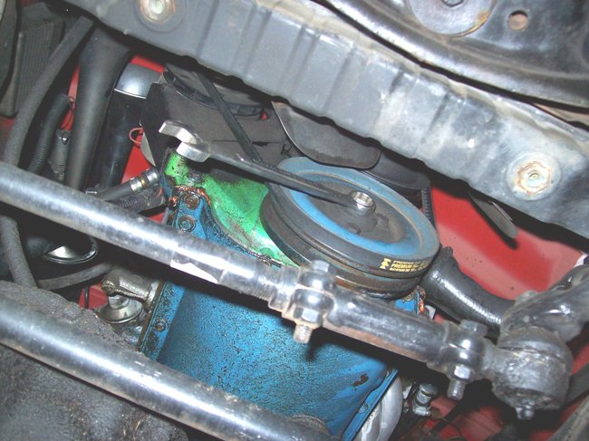

Driver's side rear wheel in picture

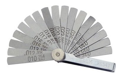

You need some feeler gauges for next task. Get them!
See picture.
