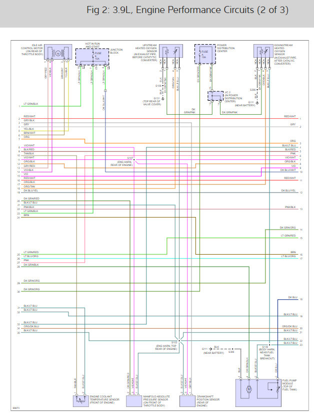

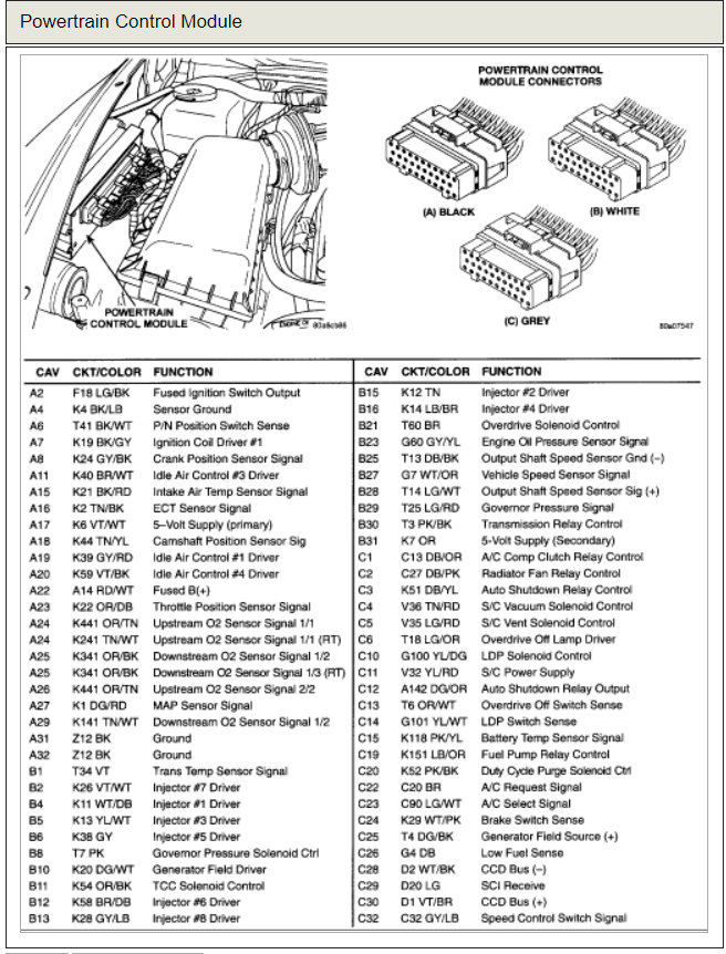

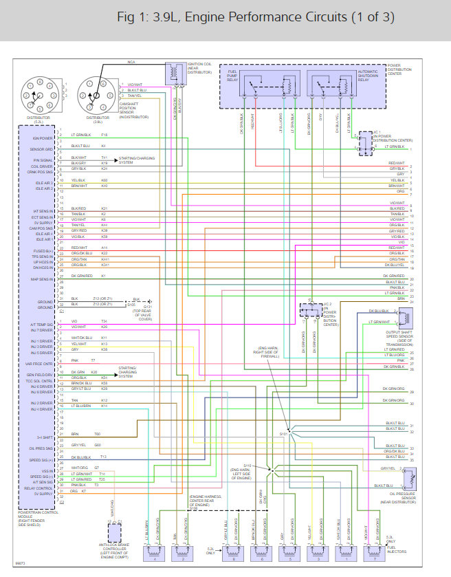

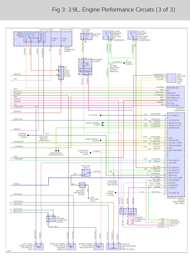

I have seen where the distributor timing being off will cause this. If that is okay it sounds like the computer is having a problem but to be sure lets test the engine computer wiring to confirm the failure. Check ground and power wires as well.
Here are the engine wiring diagrams and PCM location. Check out the diagrams (below).
Wednesday, April 11th, 2018 AT 7:06 PM

I have one more question. I noticed the middle plug that goes to the PCM is not original, it has been added. Is it possible it can be in the plug or plug wires and how can I find out?

The old connector is cut off and there is a new one wired and taped up in its place.

That could cause it if a single strand of wire managed to create a short, if it was on one of the control feeds to the IAC it could cause it to move and not show as a code.

I would go back to checking the wiring pin to pin and then to ground. Make sure the wiring is in good shape and that none of the strands are touching. Refer to the post above.

Like Ken says, go over the place where the wiring was spliced. It is possible that the connector was off a different model as well and they just matched color for color. The catch to that would be if there is a pin that was different between the two.
