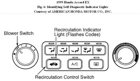

AC button, recirulate botton and selector button blink with the engine running. Prior to blinking the AC would shut off but then randomly turn on. The AC blows cold when it is on and the lights are not blinking but with the blinking lights it does not blow cold. I also can't change the selector to defrost, dash -floor or defrost -floor mode, nor can I turn off the recirculate botton. Thanks in advance for your help. I live in Key West Florida and it is a high humidity area.

Hi scuba2cuba,
It is quite common for the control panel to go bad and that is what I feel is the problem. You need to remove the panel to check for loose connections and most probably a rreplacement is necessary.
Thursday, December 17th, 2020 AT 11:30 AM (Merged)

When we start the car the light on the AC control panel is normal. We can turn the AC on. After running a while AC working stop and the lighting on the panel is off too. A few week ago, we found it could happen if we push the inner cycling button on. But now, AC will stop working no matter what we push any button on the control panel or not.

The control panel will have to be checked for failed switches. This is best done by a shop if you do not have the expierence required for this repair.

When you turn on the a/c the a/c light blinks on and off. The fan blows but no cold air. Could this be a wiring problem?
