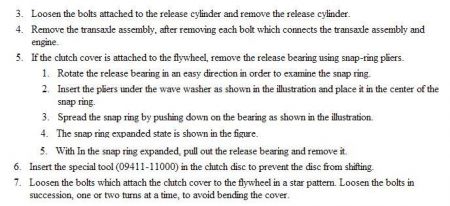

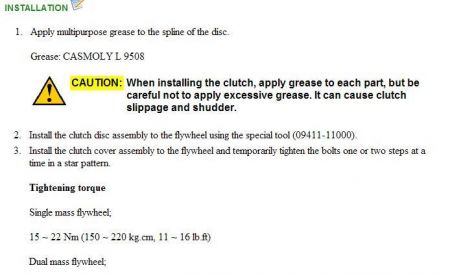

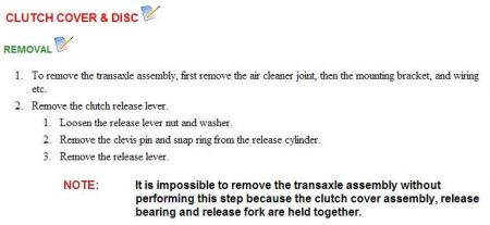

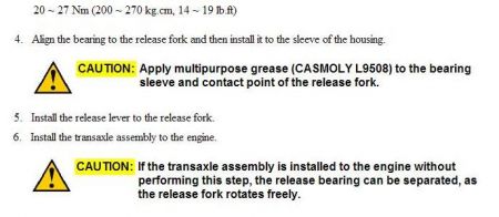

Need to know what it envolves to change the clutch
Thursday, January 28th, 2010 AT 3:16 PM
BLUELIGHTNIN6
MECHANIC
16,542 POSTS
Thursday, January 28th, 2010 AT 4:03 PM
