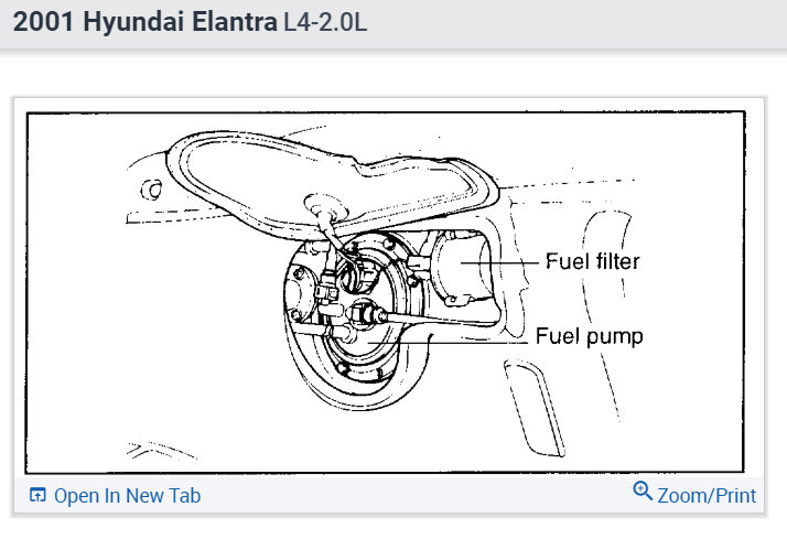

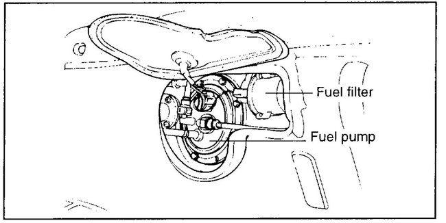

It bogs down when you turn the car off. It will sit for a minute and start back up. How many fuel filters are on this car and where are they located?
Tuesday, December 31st, 2019 AT 2:02 PM (Merged)
Good morning.
There are two filters. There is one external and one internal in the tank. I attached a picture of the external but to access the internal, the tank must be removed for access.
The fuel filter is located under the rear seat in a compartment above the fuel tank. Also, a filter sock at the base of the fuel pump located in the fuel tank.

Where is the fuel filter located on my car and how do I replace it? Is it inside the fuel pump assembly? This model is the GLS. Does that make a difference? Thank you.
Tuesday, December 31st, 2019 AT 2:34 PM (Merged)
CARADIODOC
  • 34,485 POSTS
The fuel filter is near the top of the tank next to the fuel pump here is a guide to help walk you through replacement and diagrams below to show you the location.
https://www.2carpros.com/articles/how-to-change-a-fuel-filter
