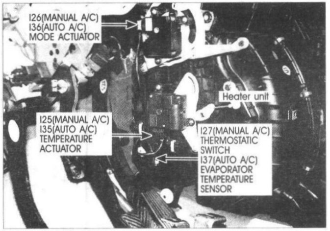

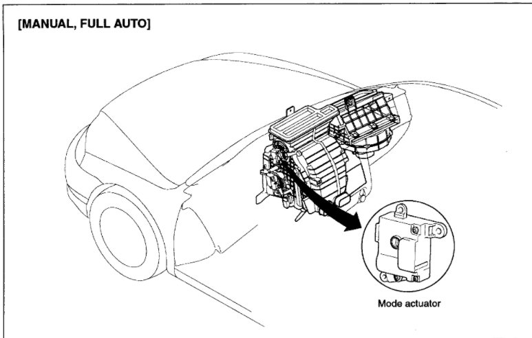

The heat output is stuck at mid-level/dash vents only and won't switch to floor, plus we also can't get much of anything from defog/defroster vents. Blower works at all speeds and temp functions properly. The mode selector switch SEEMS to work, at least partly, because the A/C compressor kicks in when moved into the defog positions. I can't find an adequate drawing/pic/diagram of what I need to look for and really can't afford the $500 estimate that our local dealer wants to fix it. First they'd want $126 just to run diagnostics! Please, any clues on where to look? Maybe a dirty connector? If it could be a dead mode actuator, would that be too difficult to replace?
~desperate in Minnesota
Nov 24, 2009 at 12:18 AM
  • CAR REPAIR CONTRIBUTOR
  • 54,193 POSTS
99.9% of the time it's the blend door actuator, Hyundai does give this info on their location! Remove the trim panel by prying it off, it just pops into clips, then unbolt the unit. Then you might need to remove the glove box door and some minor bracing. Here is a guide to help you fix the problem step by step. Then see the diagrams and images below with all for the blend mode door actuator locations https://www.2carpros.com/articles/replace-blend-door-motor

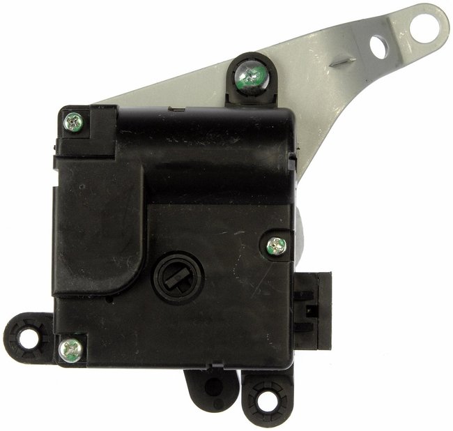

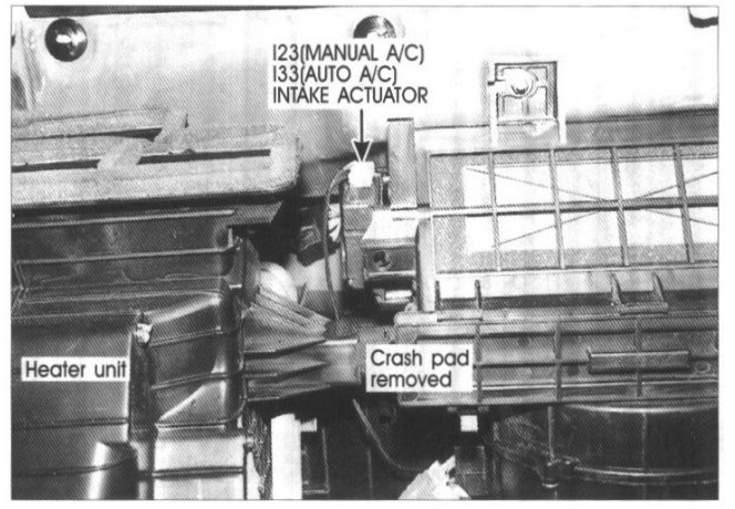

CHARLES ATCHISON
Trying to find where the heat defrost actuator is. The heater is stuck on vent.
Nov 11, 2019 at 1:22 PM (Merged)
STEVE W.
  • 15,148 POSTS
It is a small lever connected to the mode cam on the left side of the heater box. If it is stuck the motor that drives the cam could have failed or the cam may have, it is pretty much all plastic.
The picture is the motor that runs the cam.

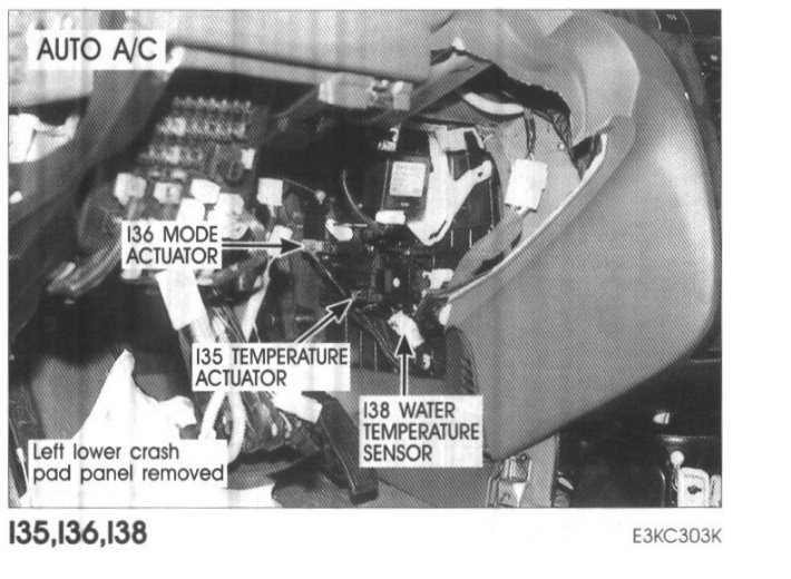

PD1210
2004 Elantra here having the same issue. Heat and A/C work but no directional control defrost, floor, etc.
I see the diagram and photos but having trouble locating this Mode actuator. Can anyone point me in the right direction?
Dec 6, 2020 at 9:10 AM

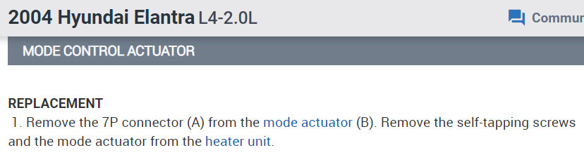

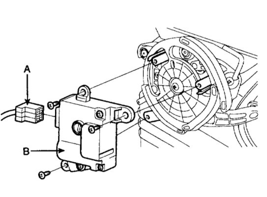

DANNY L
  • 5,648 POSTS
Hello, I'm Danny.
The mode actuator is bolted onto the heater unit which is under the dash on the passenger side. Here is a tutorial showing what is involved for its replacement:
I've attached a few pictures below showing how to replace and is location for your car. Hope this helps and thanks for using 2CarPros.
Dec 6, 2020 at 1:43 PM

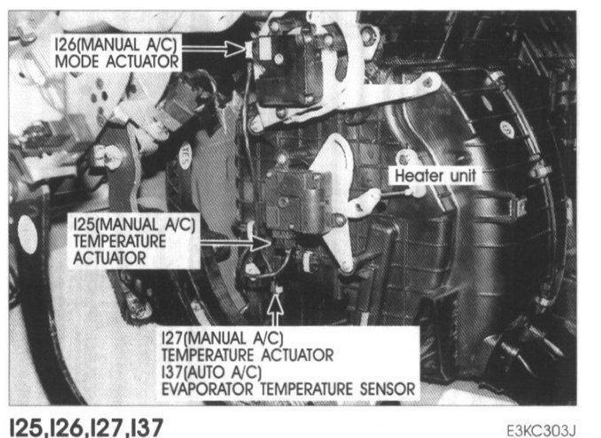

PD1210
Even in the photo posted this Mode actuator is on the driver's side under the dash directly above the temperature control actuator. Am I incorrect?
Dec 6, 2020 at 1:56 PM
DANNY L
  • 5,648 POSTS
Hello again.
I found a better picture and attached below of its location. Let us know if you have any further question on this issue and keep us updated. Hope this helps and thanks again for using 2CarPros.
