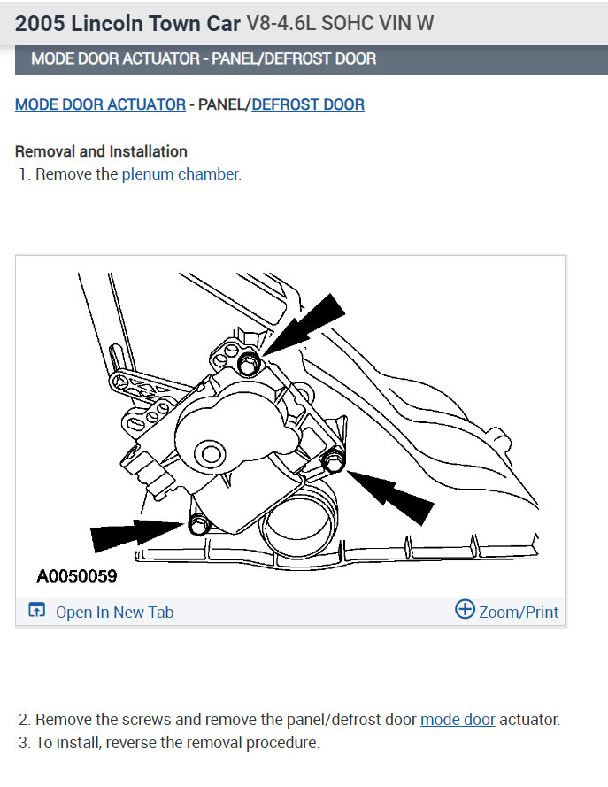

I did this repair years ago on a Crown Vic or something similar maybe just can't remember what it was. No air from middle vents, or rear air. Only defrost and bottom/leg air. No matter what I chose only the defrost and bottom. I ran the test, and it gave me
12.42
12.63.
12.64
Not sure what these mean.

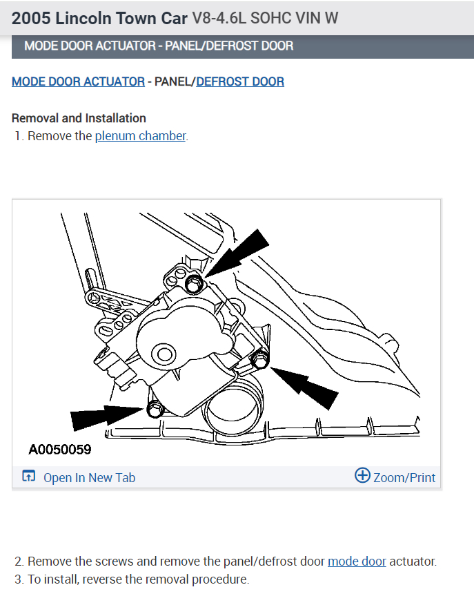

Yep, this happens when the mode actuator goes out. Here is the location and how to change it out to fix the problem. Check out the images (below). Let us know if you need anything else.

Would you remove the dash for this?

Can you tell me where this is located? I removed the radio and trim but before I go further need more info please.

It looks like it is behind the glove box.

I took glove box down and to the left there is one, removed and moved the door by hand nothing change as far as flow, removed cluster and panels under steering and there is another to the right, same thing, moved it and it did nothing.

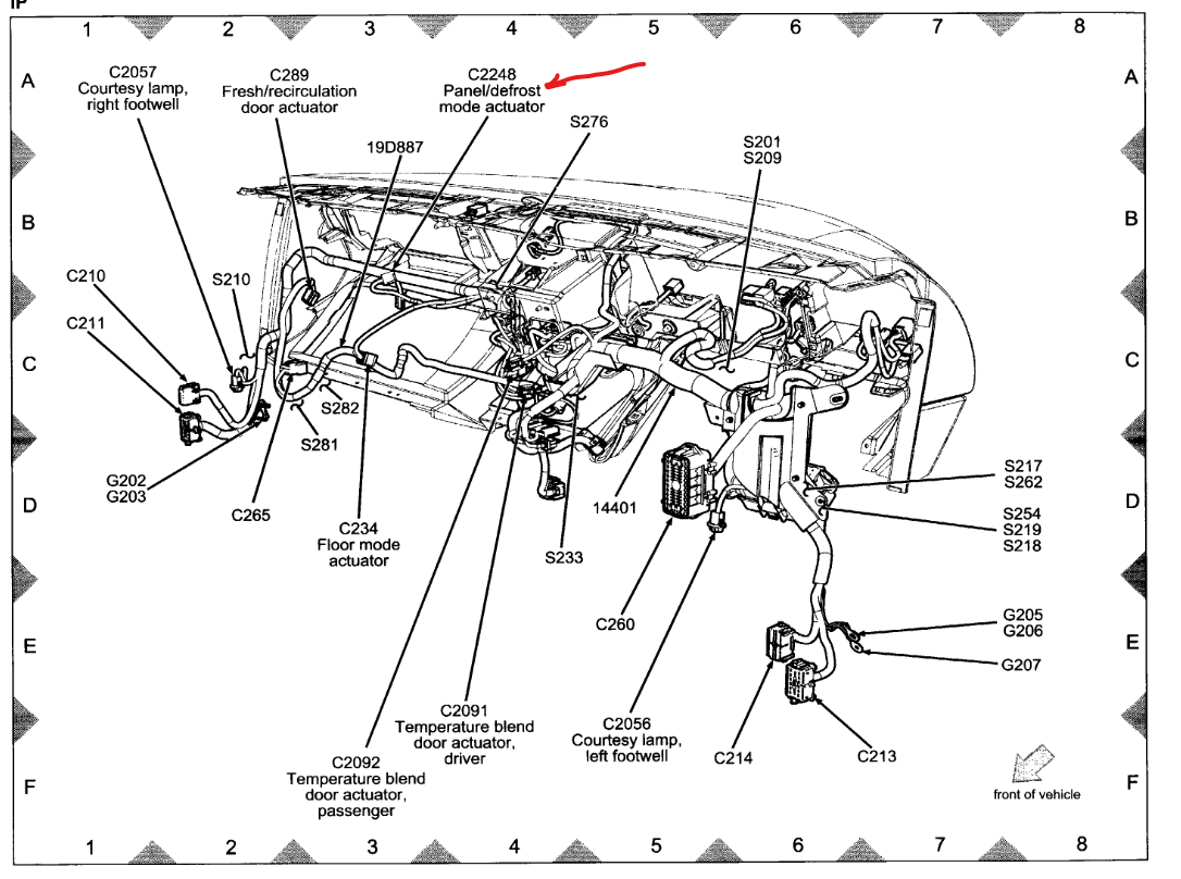

Can you get me the part numbers for the 2 actuators that set behind the dash on the vac blend door assembly?

Yep, the mode actuator is near the glove box, check this diagrams out. Check out the images (below). Let us know how it goes. Sorry I dont have part numbers.

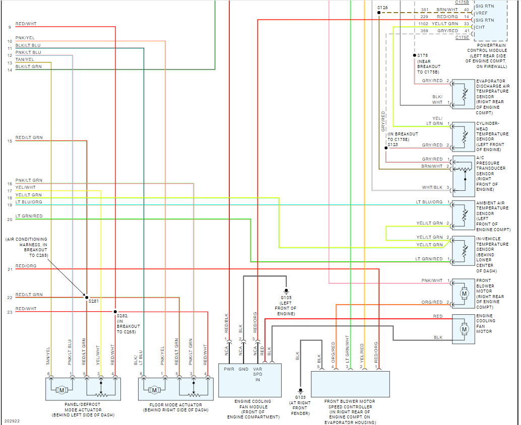

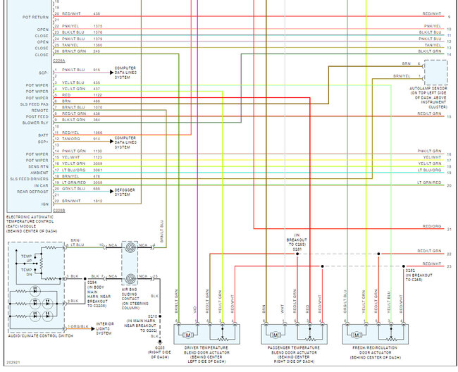

This picture looks backwards for some reason. So, the temperature blend ones are on sides, which I can access by hand, I tried turning them and it didn't make a difference now I know they are temp blend ones. Another for recirculation is by blower. The last 2 are hidden. So am guessing the one u marked is one of them and the other is for the foot. Are these numbers corresponding to part number? Based on the codes I got, 2 of them which do you think are bad?

The mode actuator sounds bad to me. That is the one I marked in the diagram above.

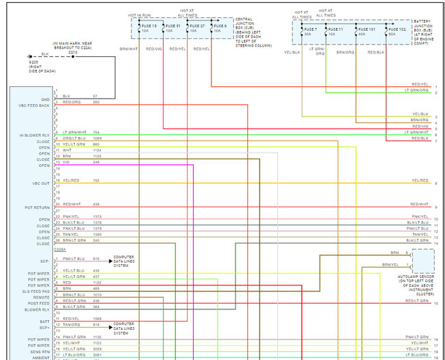

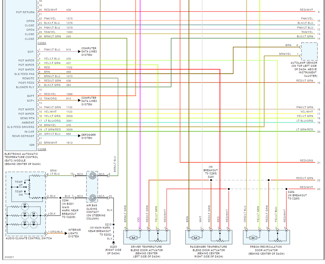

Is there a way to test the old actuator on the bench?

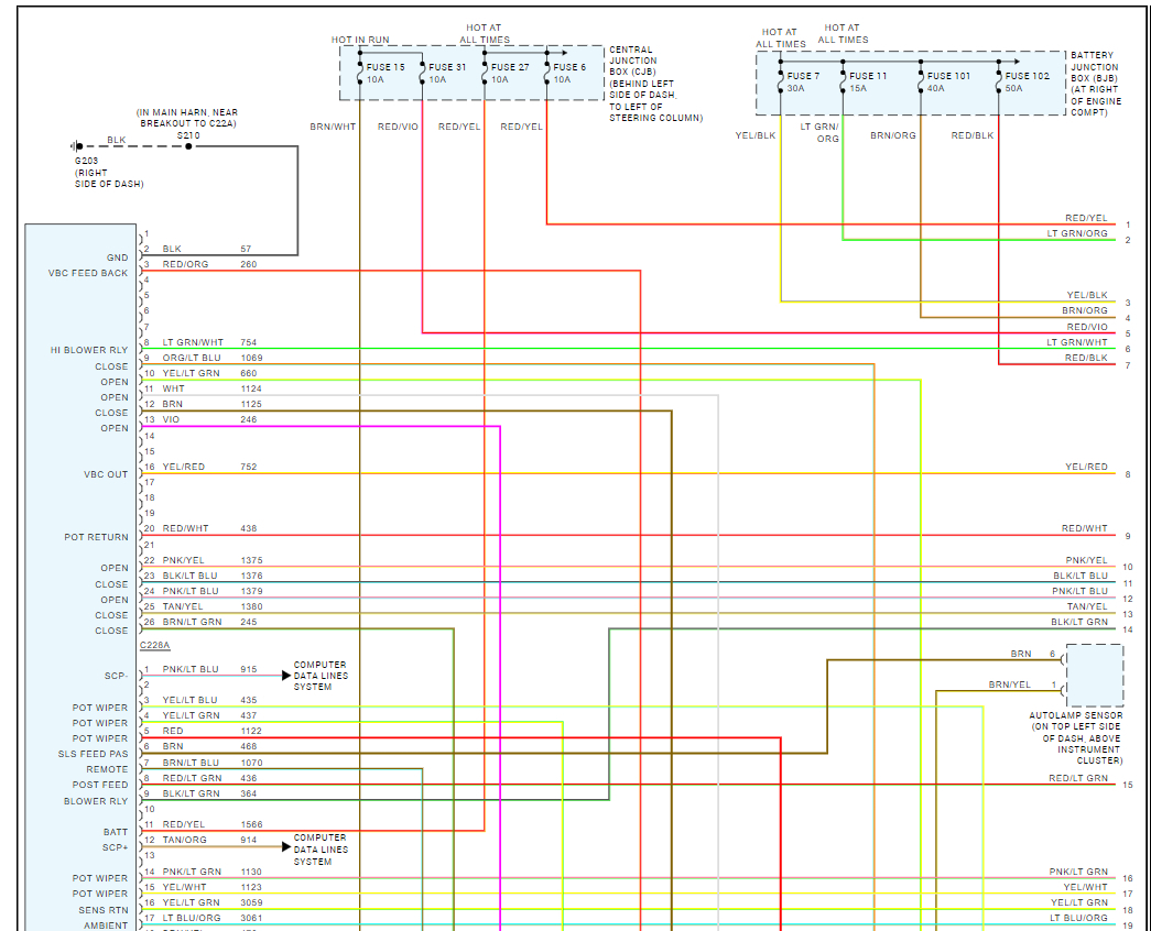

You can check for power and ground to the controller, here is a guide and wiring diagram for the system. Also, you may have the incorrect replacement part for the mode actuator. I don't have a way to test the actuator.
