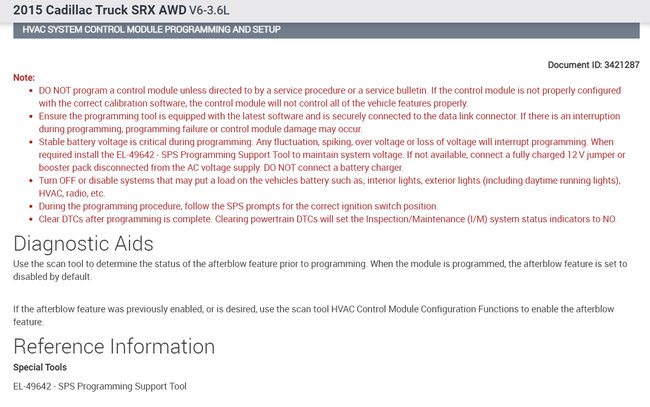

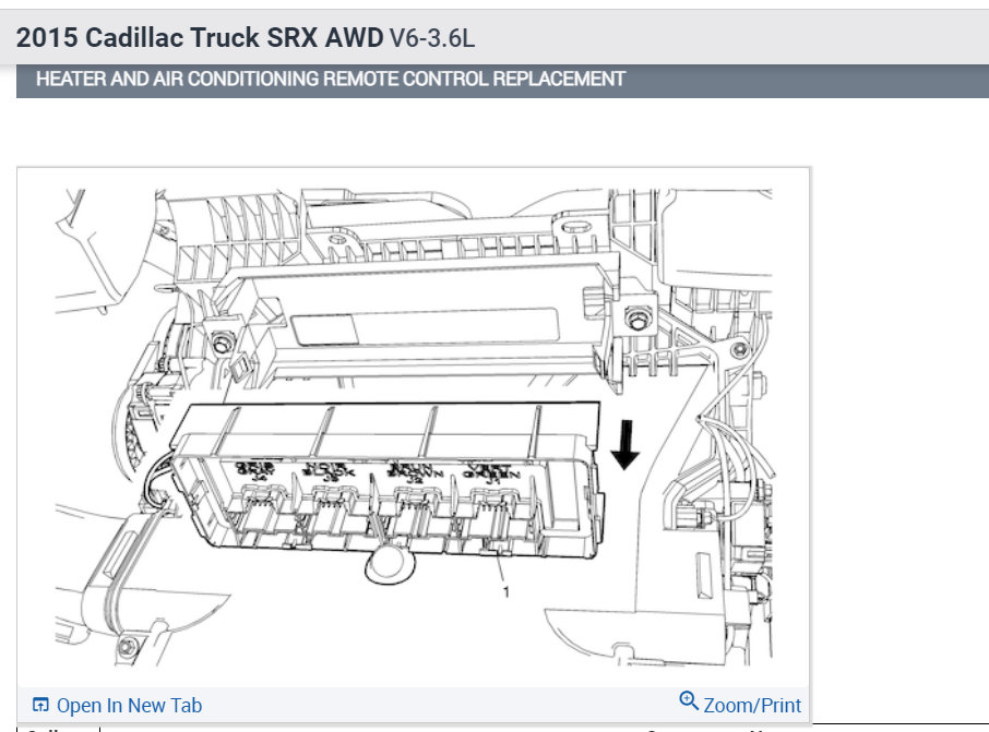

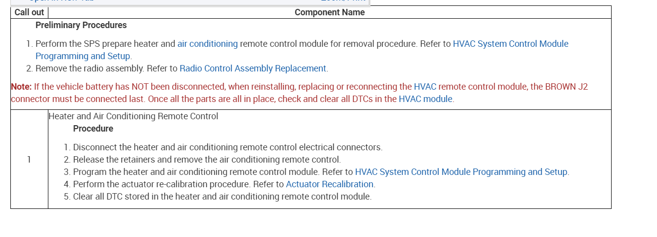

U1510 code is lost communication with the HVAC controller. I would check the power and grounds and if okay replace the controller.
