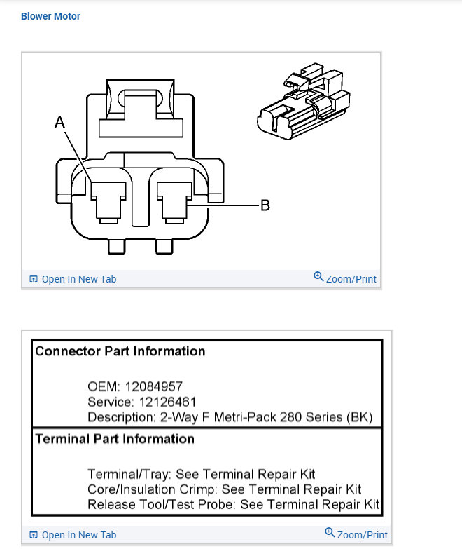

Maybe I missed it, but have you confirmed the blower motor itself is okay?
We do this by putting 12 volts to the blower motor and see if it turns on.
Here is a guide that helps with this issue:
https://www.2carpros.com/articles/low-or-no-air-flow-from-vents

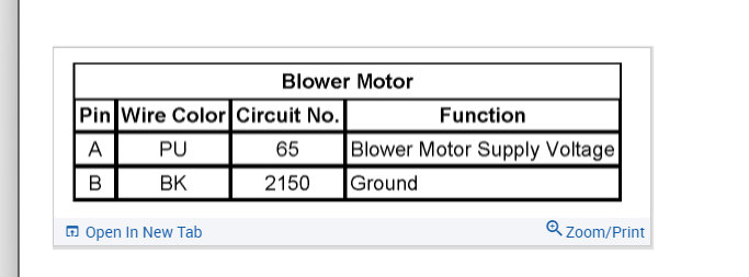

What I would suggest you do is remove the connector from the control processor (resistor) with the key on and blower motor on, and jump pin E to pin D. Or you can go to the back of the blower motor connector and jump A to B, but you will need to have it plugged in and the blower motor turned on to do it this way.
This forces 12 volts to the motor. If it comes on, then the blower motor resistor (control processor) is the issue. However, I suspect it will not come on and you will need to replace the motor.

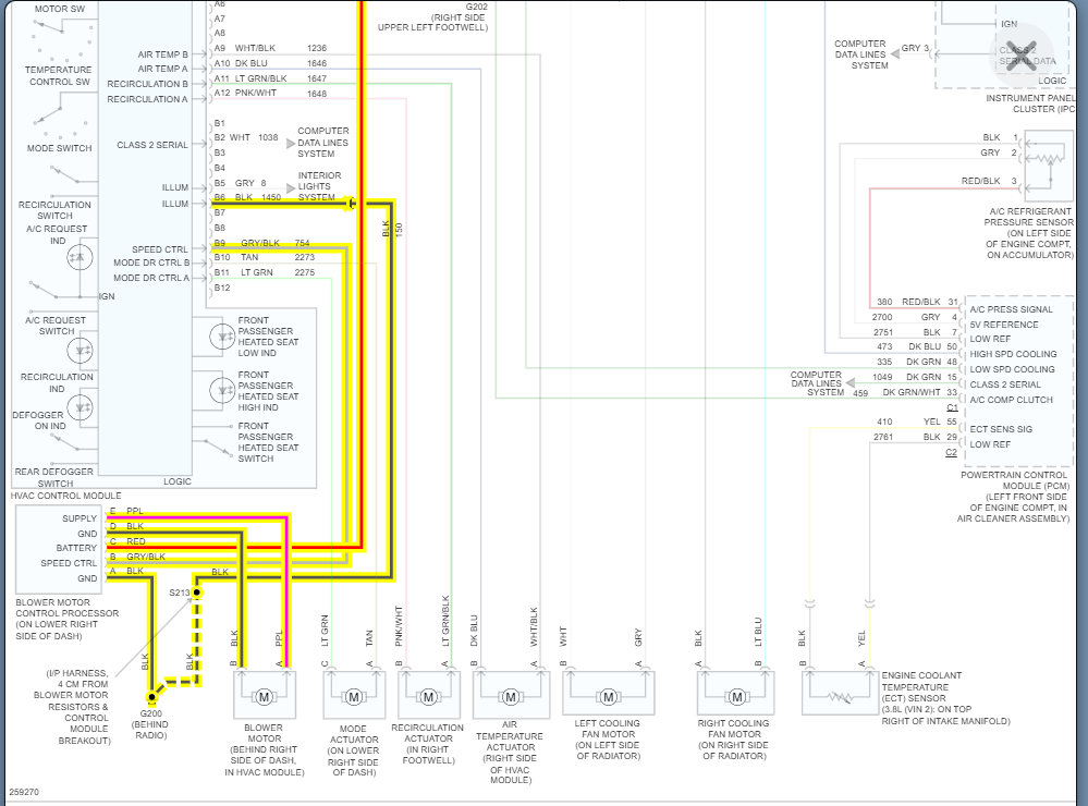

Please see the wiring diagram below. Let me know what questions you have.
Thanks

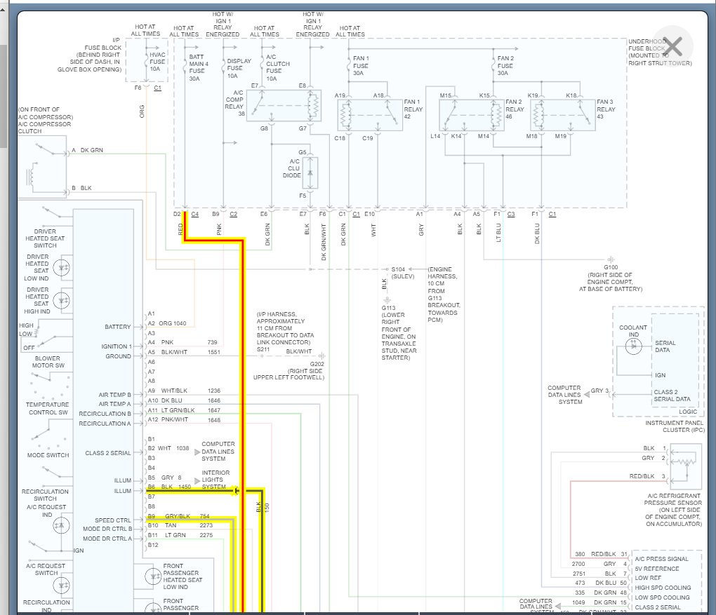

  • CAR REPAIR CONTRIBUTOR
Okay. If you want to confirm it, go to the resistor, and check the power on the purple wire with the fan on. You should have 12 volts all the time on this wire but just turn the fan on to be sure.
Then check the voltage on the gray/black wire with the fan turned to high. You should have 12 volts on this as well as this is your speed control.
If you are correct, then you are not going to have voltage on this gray/black wire which means the module is not sending the voltage.
However, we need to confirm these two in order to be sure because if the resistor is not getting power on the purple wire, then it will not work. Then it is possible (unlikely) that you have a faulty new resistor.
