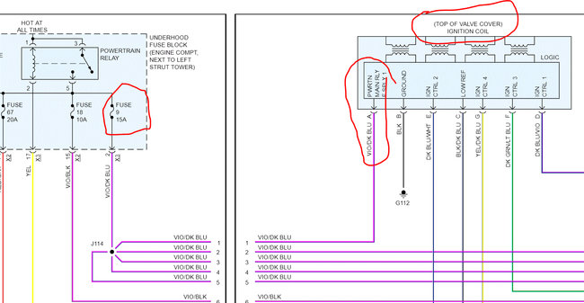

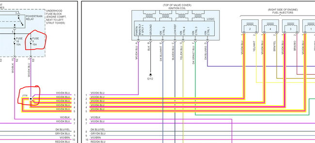

Well, after doing some more on it I found that the fuse for injectors 1 and 3 was blown. Replaced it and it blew again. So I unhooked all the injectors because I was unsure which was 1 and 3 and the fuse blew again. So I am at a loss now.
Wednesday, April 29th, 2020 AT 5:16 PM
  • 110,192 POSTS
Does it blow regardless if the key is on or off? Let me know that. Also, I attached a picture below showing what I believe to be the fuse you are referring to. That fuse powers all injectors. A ground is provide via the power-train control module (PCM). Now, if you look at the picture, note that I circled a splice in the wires. If there is a short, that is the first thing I would check.

Yes, it is fuse 9 and according to the lid for the fuse block it says 1 and 3 and says fuse 8 is 2 and 4. I blew when I tried to start it. I did not just turn the key on and see if it blew. I will try that tomorrow after I buy more 15A fuses.
Thursday, April 30th, 2020 AT 8:36 PM
  • 110,192 POSTS
If it blows when you turn the key on, there has to be a short between the fuse and the injectors.

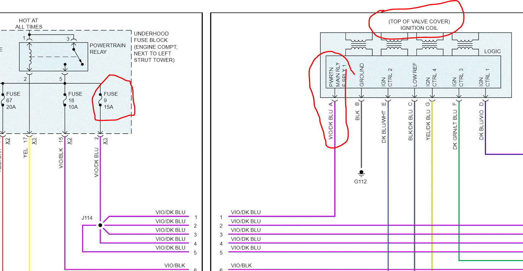

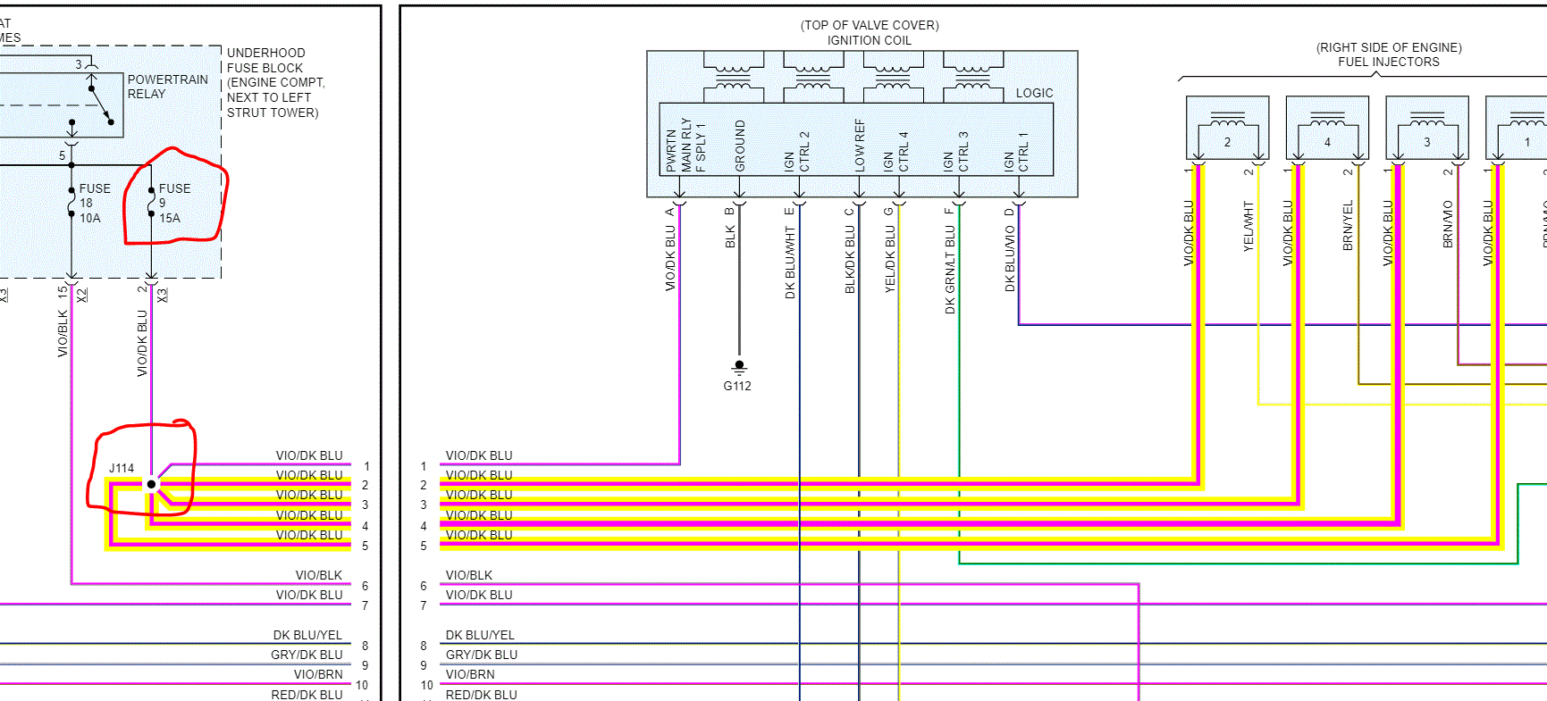

If I unplug the ignition coil and turn the key the fuse does not blow.
Friday, May 1st, 2020 AT 2:26 PM
  • 110,192 POSTS
Replace the coil unit. It must be shorted. Fuse 9 powers it as well. See the attached pic. Actually, before replacing it, confirm the connector isn't damaged. Also, see if you can get one from a salvage yard that is tested good to save money.

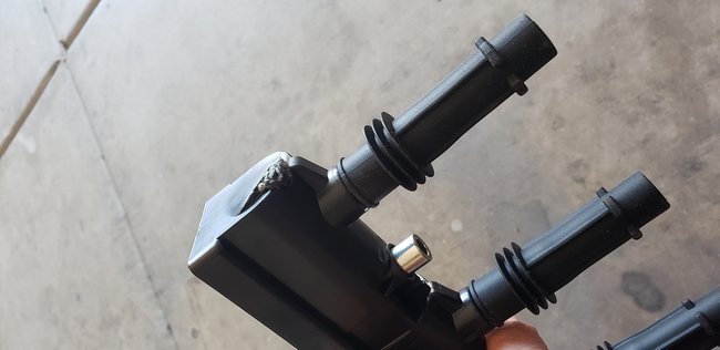

KAHNEFN
  • 7 POSTS
It is my ignition coil. My question is, what would cause it to do this to the coil? (See picture) it just started out of nowhere which is weird I have inspected all the wires and they all look good.
Saturday, May 2nd, 2020 AT 7:59 AM
  • 110,192 POSTS
That's the problem. Something internally must have shorted and overheated. Have you been able to find one?
