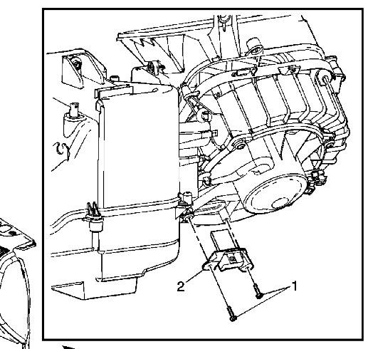

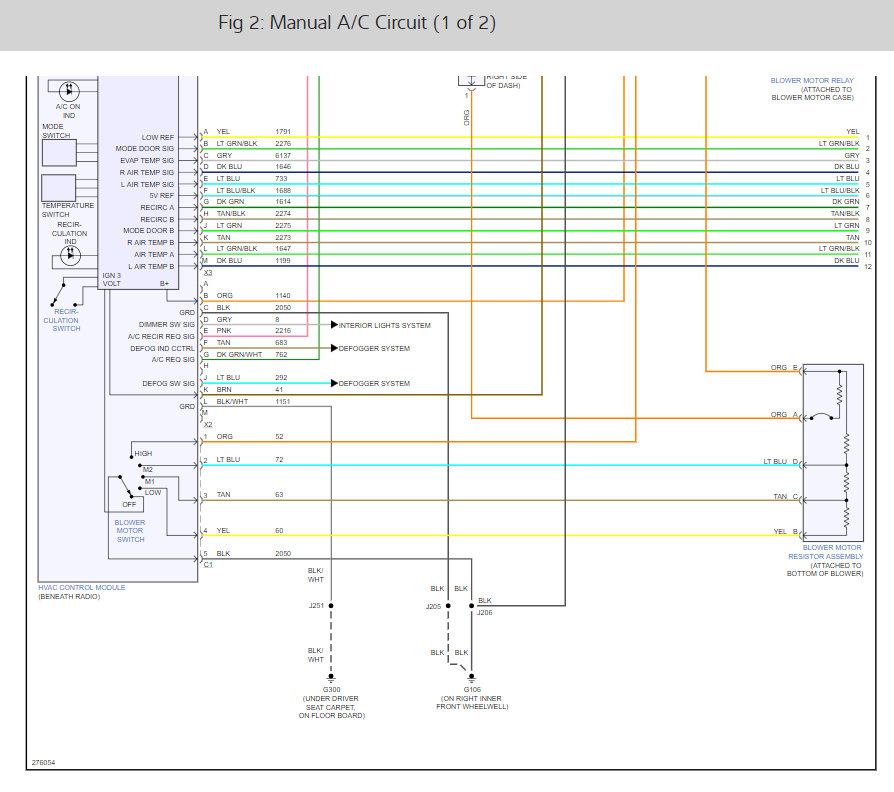

My blower went out on my air conditioner as I was driving. How do I repair the blower, the fuse is still good.
Do you
have the same problem?
Saturday, July 24th, 2010 AT 8:23 PM
FACTORYJACK
  • EXPERT

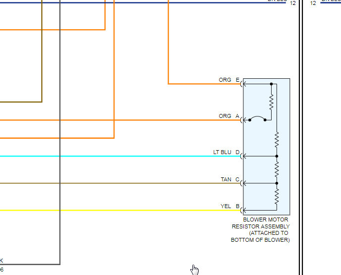

Pull the connection at the resistor, if you can get it apart. Often times a poor connection results in a thermal failure. Replace the resistor and connector. It is available as a harness, makes it easier.
