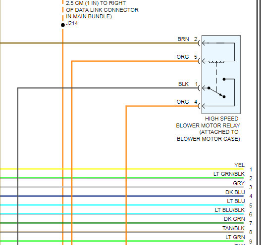

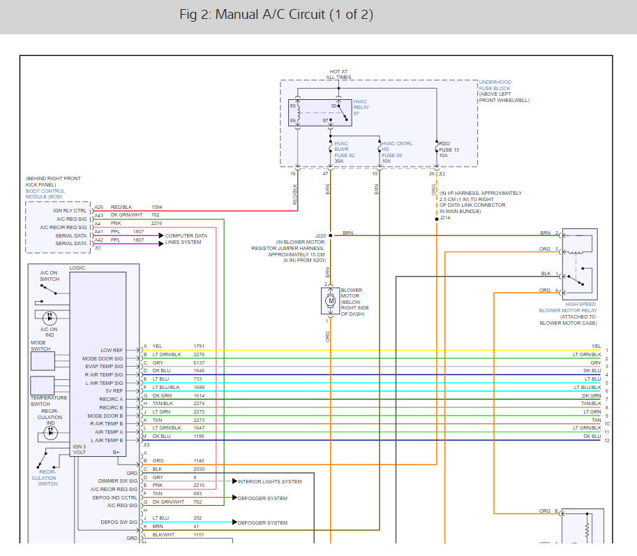

My Blower Motor is not working. What can be some possible problems?

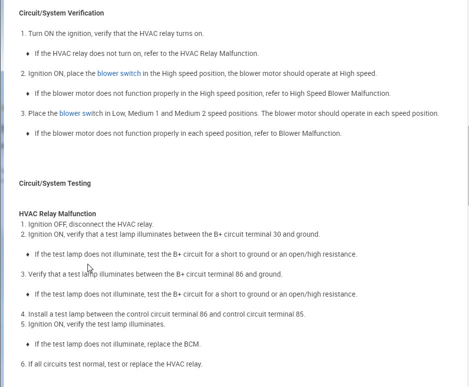

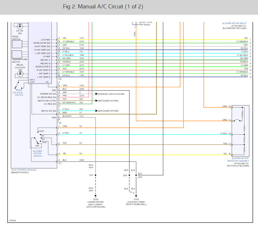

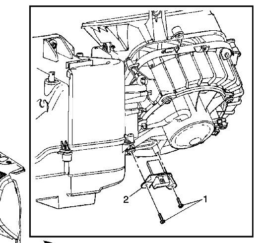

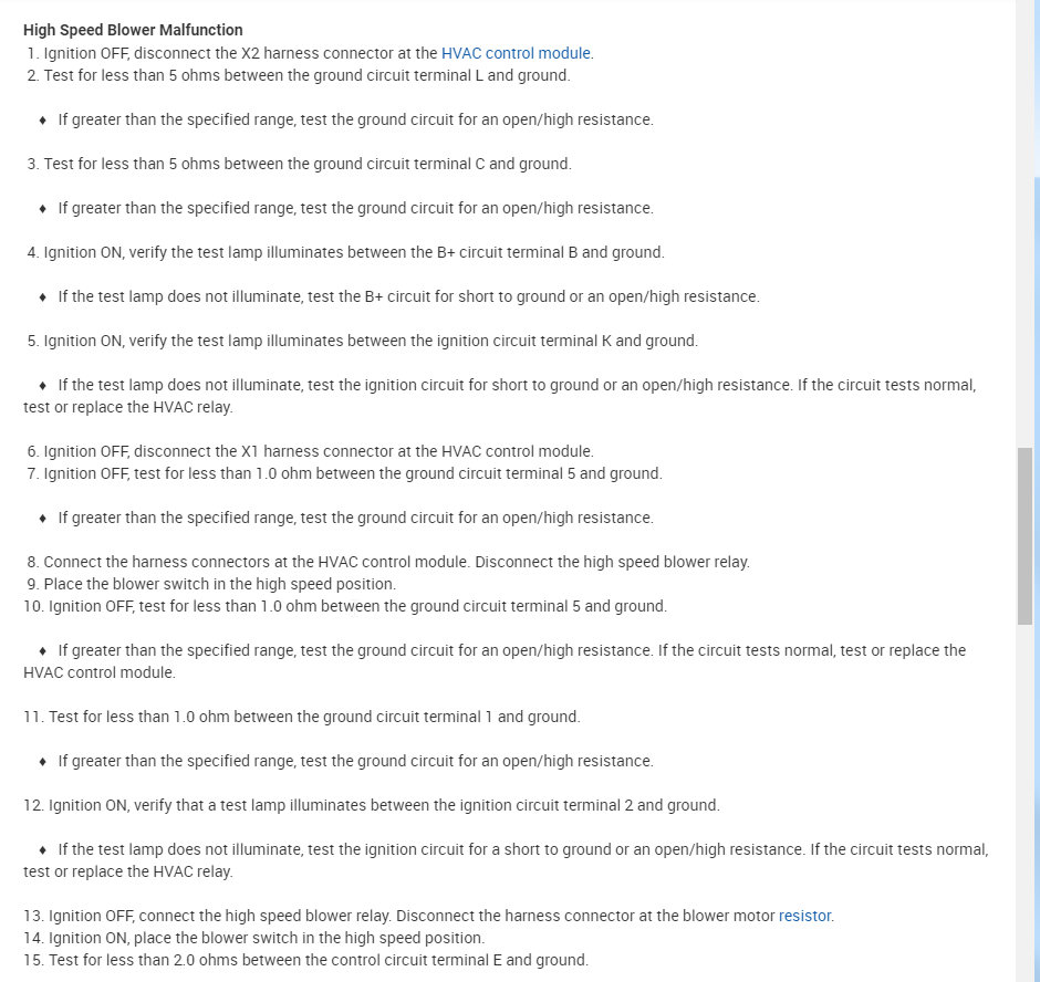

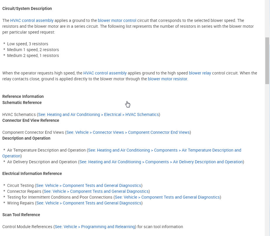

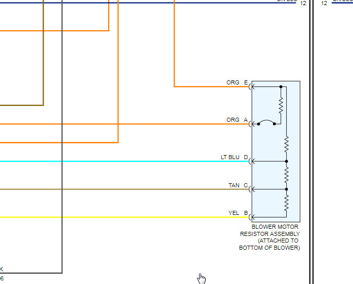

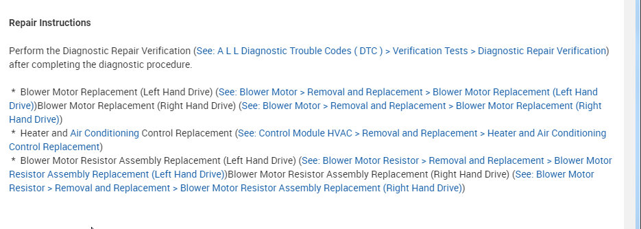

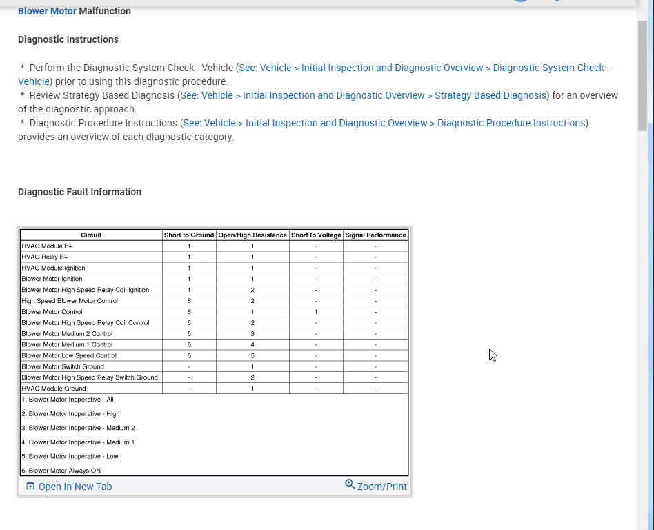

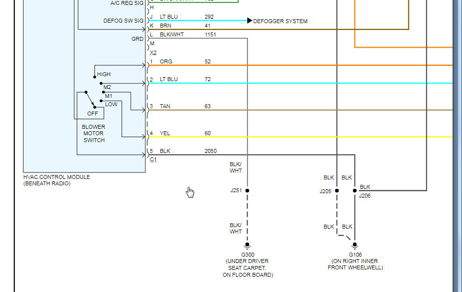

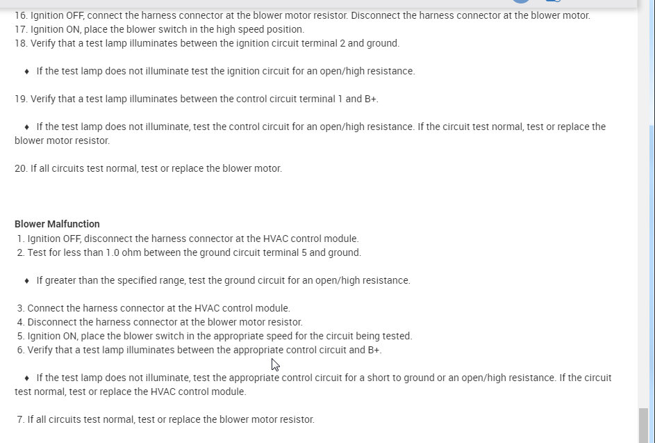

For jbl0509, check the connector at the blower resistor. Poor conection usually causes a thermal failure, you will see the signs when you get it disconnected. The resistor, and terminal will need replaced. Optionally, there is a harness available through GM that includes that connector.
For perkusmc2171, is there air coming from other than the dash vents, like the floor or defrost vents?
