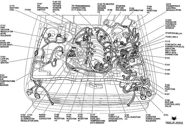

KLAWS53
  • FORD RANGER
I have a 1993 ford ranger with the 2.3 4cyl. Engine, I drove it the other day and it started bogging down and eventually died now it is sitting in my yard useless. It will start every time I try to start it but will only run for 3-5 seconds then it dies again, if I try to give it gas after starting it, it just dies quicker. Any ideas on what it may be wrong?
Thursday, August 20th, 2020 AT 11:11 AM (Merged)
  • 75,992 POSTS
Try cleaning out the idle air control valve that don't work-check the fuel pressure and comeback
FLYINGDIRT
Ken, Kept fooling with the ISC valve. Turns out that this was the source of the vacuum/ idle problem. Replaced ISC and it's working okay. Thanks for your help. Stretch

Veh ran great. One morning I started it up and it bucked and jerked and had absolutely no power. Tried to run it hard but bogged down and died. Plugs keep fowling and will not idle or stay running. Have replaced t-stat, 3 sets of plugs, ign wires, O2 sensors and egr valve. Re-deploying Soon and would like to have a truck to leave with my family. Any help would be greatly appreciated. Thank you
  • 110,192 POSTS
Have you checked fuel pump pressure? Has the check engine light come on? Have you checked the catalytic converter to make sure it isn't plugged?

Check right rear corner of the intake manifold near the firewall
