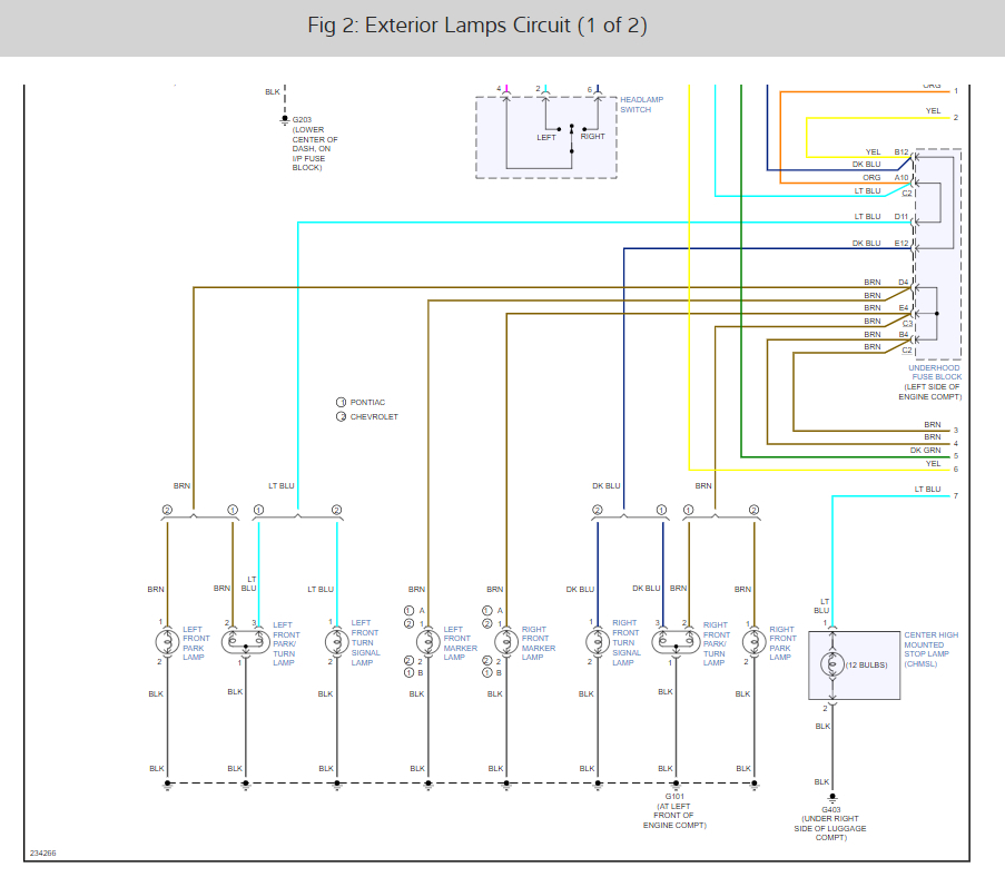

No taillights no running lights, no, turn signals and no hazard lights
TABETHACRAIGIE
  • 2006 CHEVROLET EQUINOX
  • 4.2L
  • V6
  • 2WD
  • 200,000 MILES

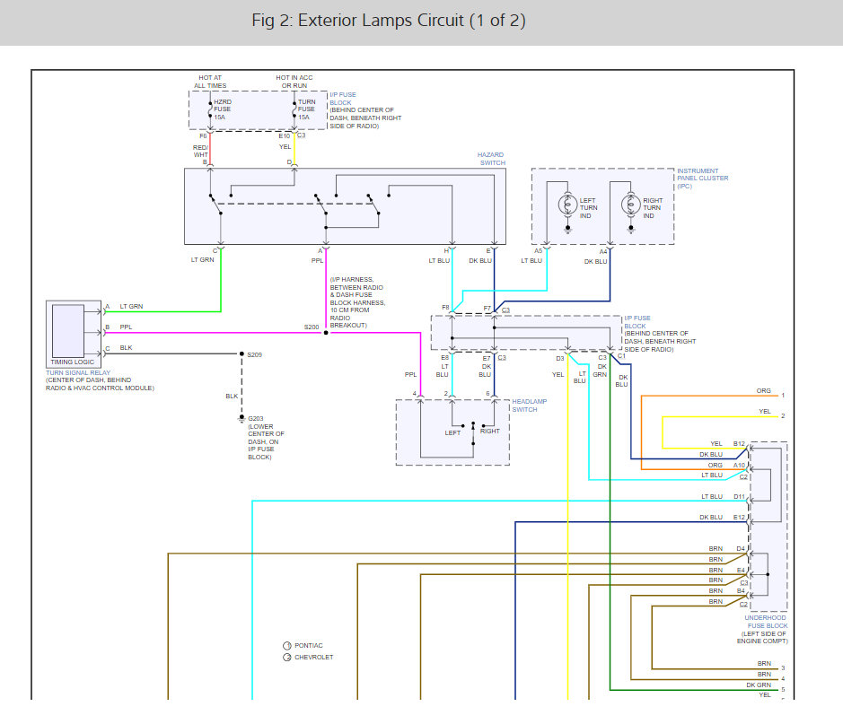

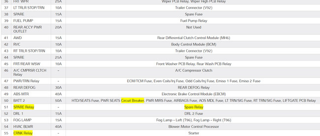

I have no taillights no running lights, no, turn signals, no hazards and no panel where my speedometer is lights at all.
I have a friend here looking at it and I don't know how to remove it without breaking the center panel or you turn on the shift.
Friday, February 14th, 2020 AT 11:23 AM
KEN L
  • MASTER CERTIFIED MECHANIC
  • 55,499 POSTS

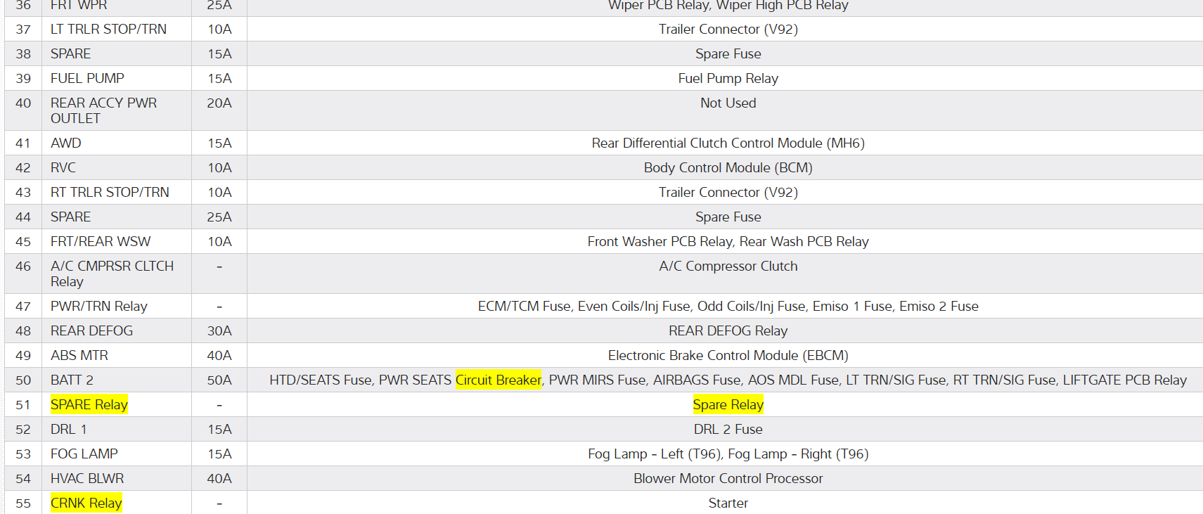

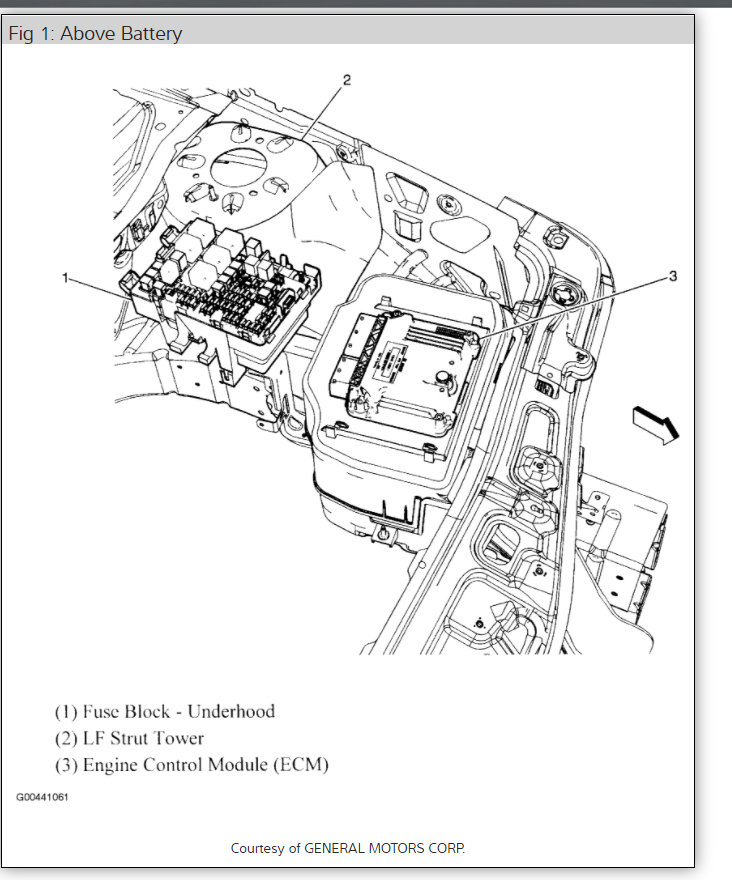

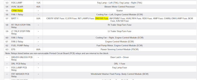

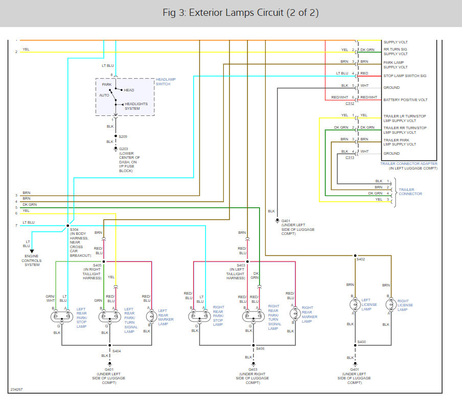

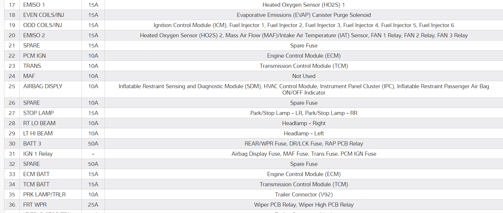

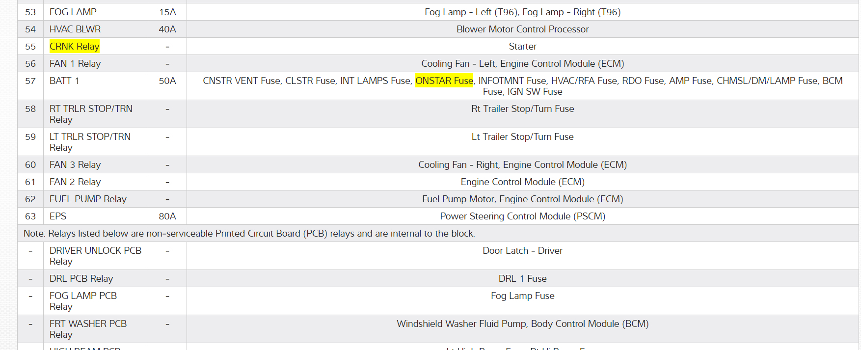

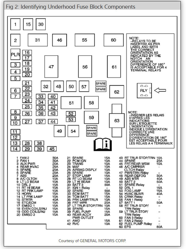

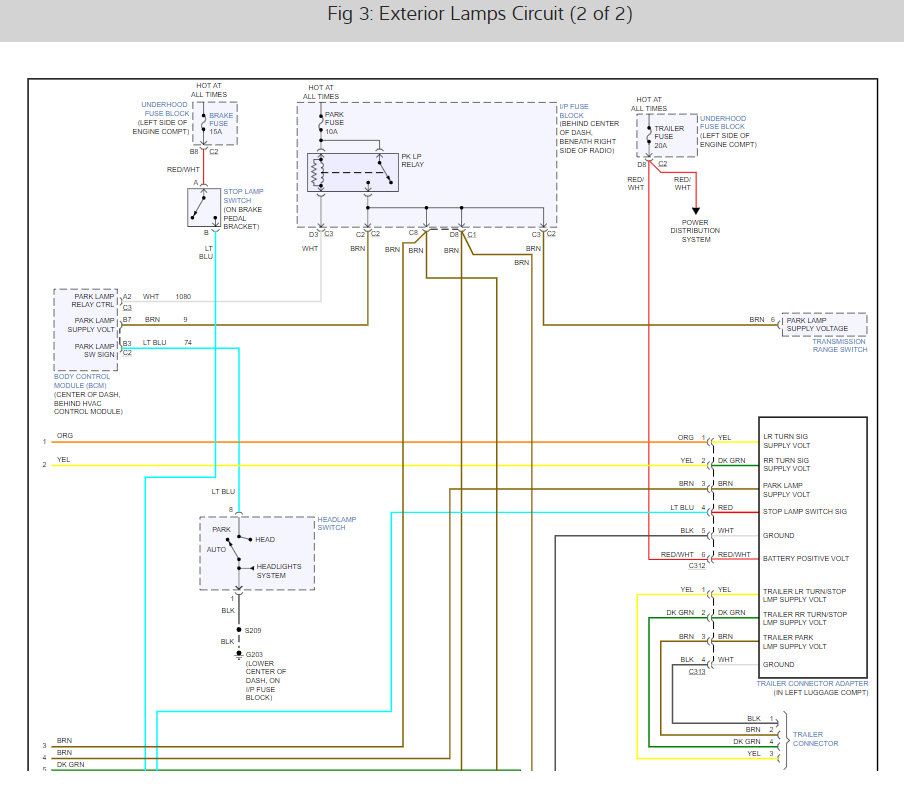

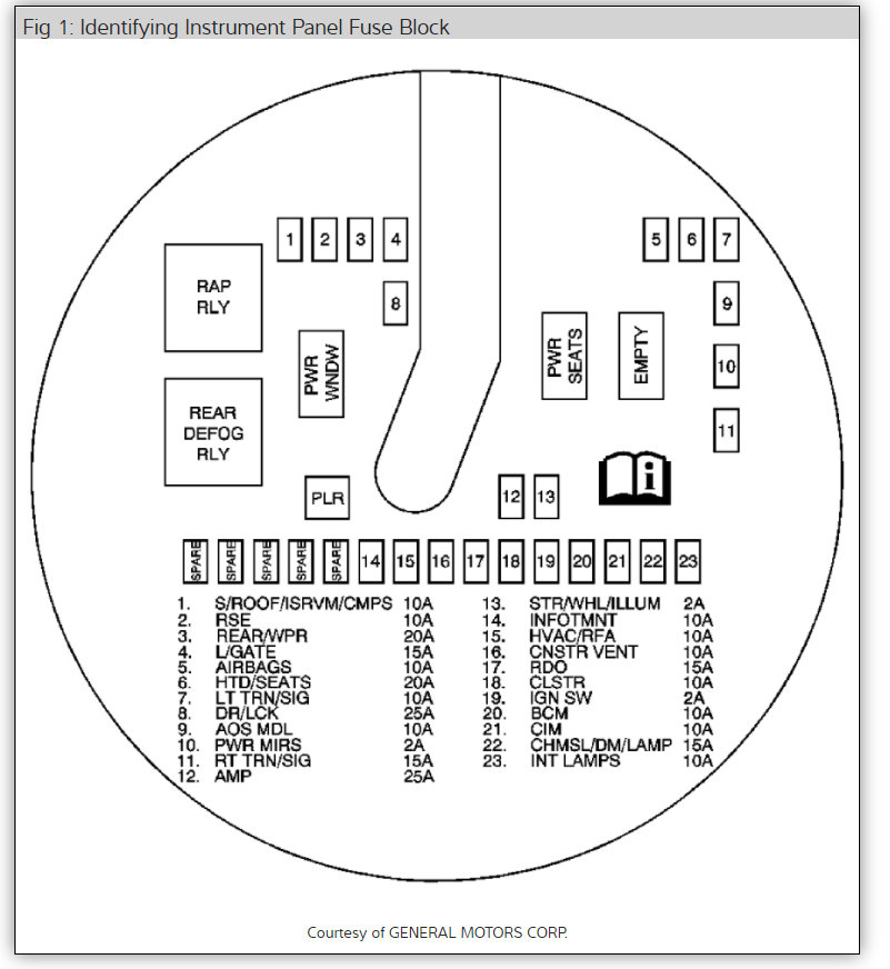

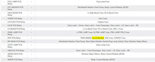

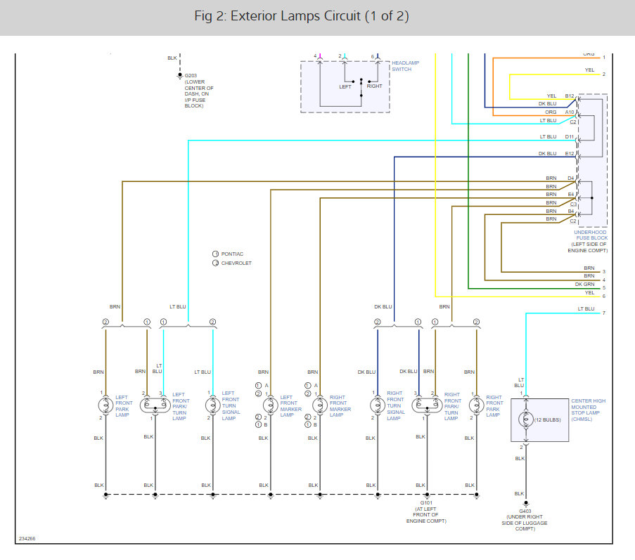

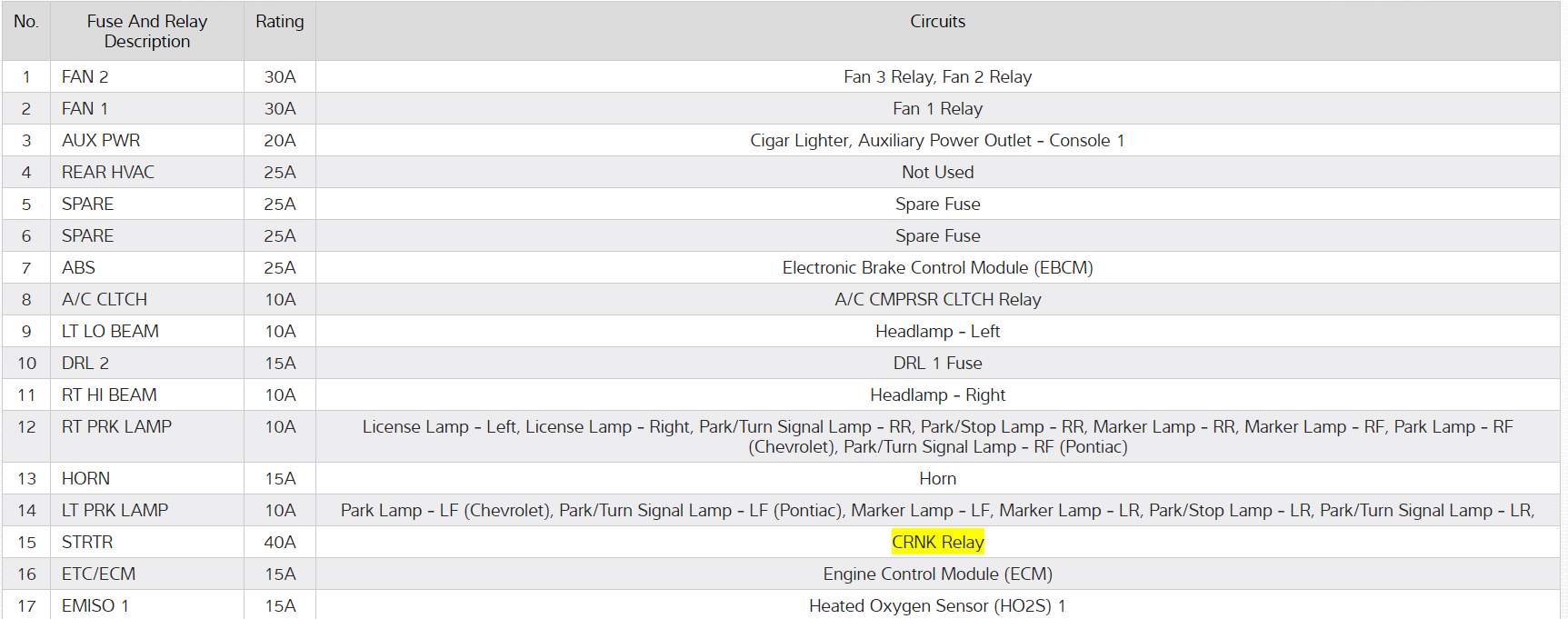

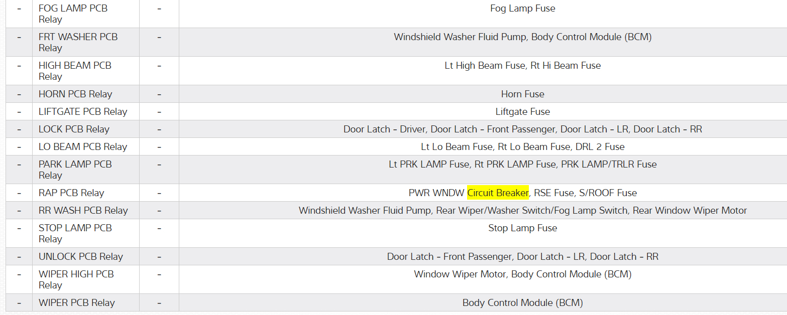

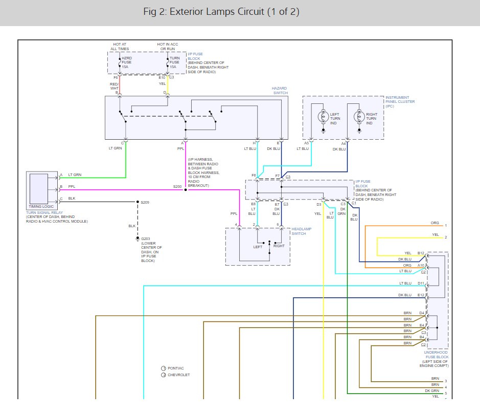

There are three fuses (turn, hazard, park) and one relay that run the system. Here is a guide to help you test the fuses and relay with the fuse and tail light relay location. Also I have included the wiring diagrams so you can see how the system works.
and
