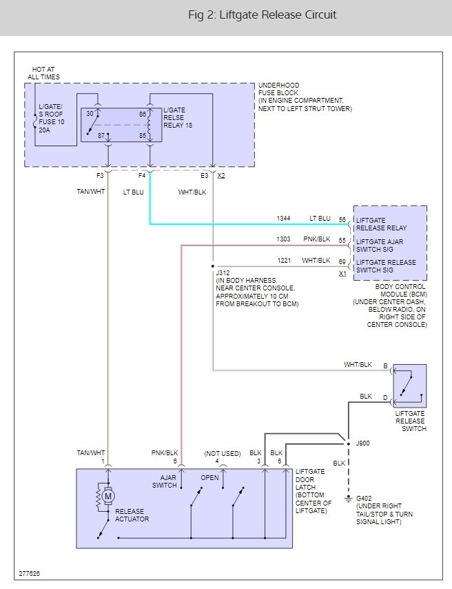

Rear lift-gate stopped working. Want to know the proper relay to test first? Would it be proper to test all relays and fuses first?

Yes I have found the wiring diagram (below) and a couple of guides so you can get the problem fixed.
and
Image (Click to make bigger)
