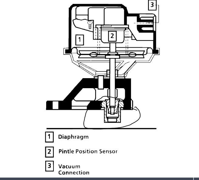

How do I clean EGR valve and intake air?

Good morning,
You need to remove the valve and look underneath. Make sure the valve is closed. It is common for carbon to unseat the pindle creating a massive vacuum leak.

When my wife is turning car over I spray carburetor clean in intake and car runs soon as I stop so does car not sure what is wrong with car. No codes.
Friday, September 13th, 2019 AT 2:28 AM
  • 52,797 POSTS
Okay, you have a fuel delivery issue.
Can you hear the fuel pump run with the key on?
You need to check the actual fuel pressure first to see if the pump is working.
