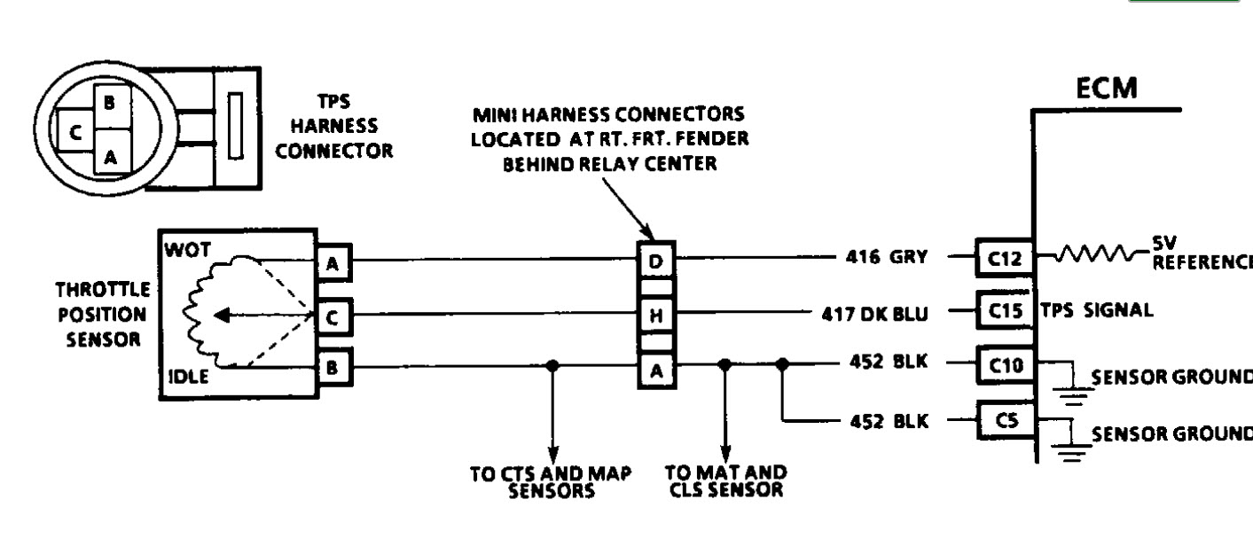

The car will run good until go to give it gas.
Monday, January 9th, 2017 AT 9:01 AM

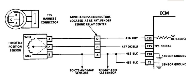

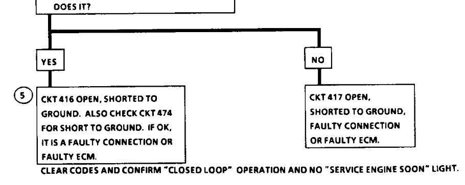

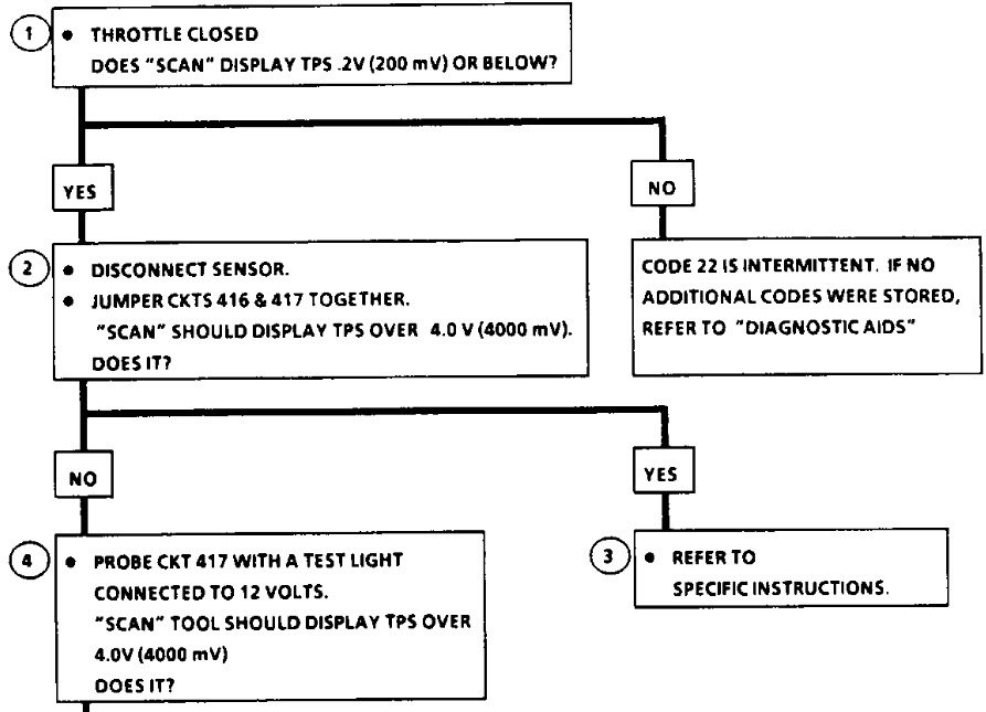

I am getting code 22 TPS signal voltage is low.
Thursday, January 12th, 2017 AT 3:34 PM
HMAC300
  • 48,601 POSTS
See pictures to test circuit it can be a bad TPS and or a vacuum leak to map sensor. So check that as well.
Thursday, January 12th, 2017 AT 4:49 PM

Well with the pictures I sent you can test if light is still on. Also, clean throttle plate on both sides and clean IAC hole may help this.

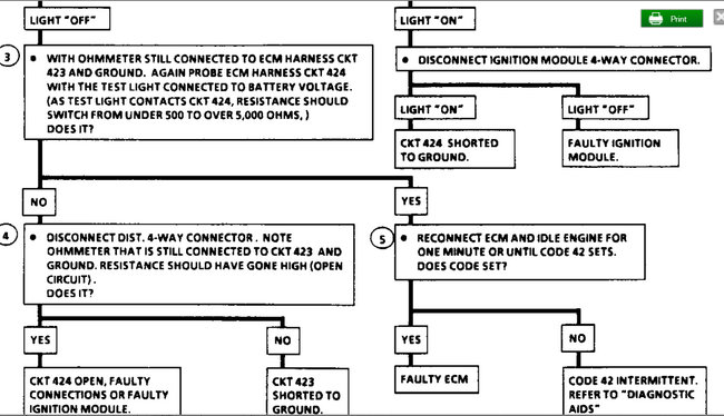

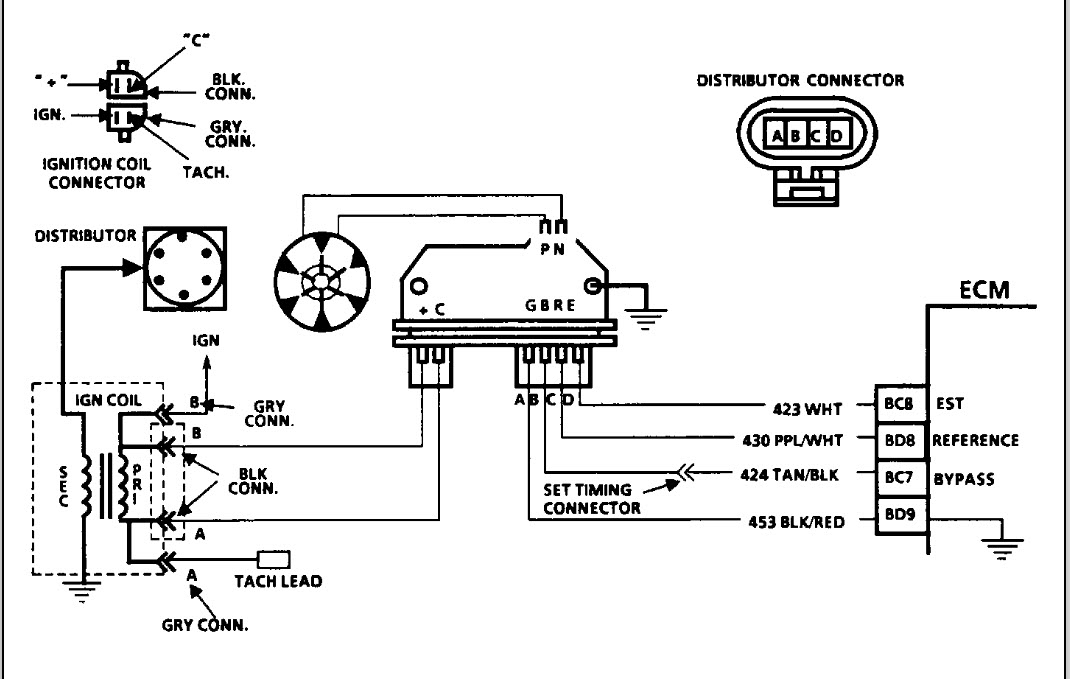

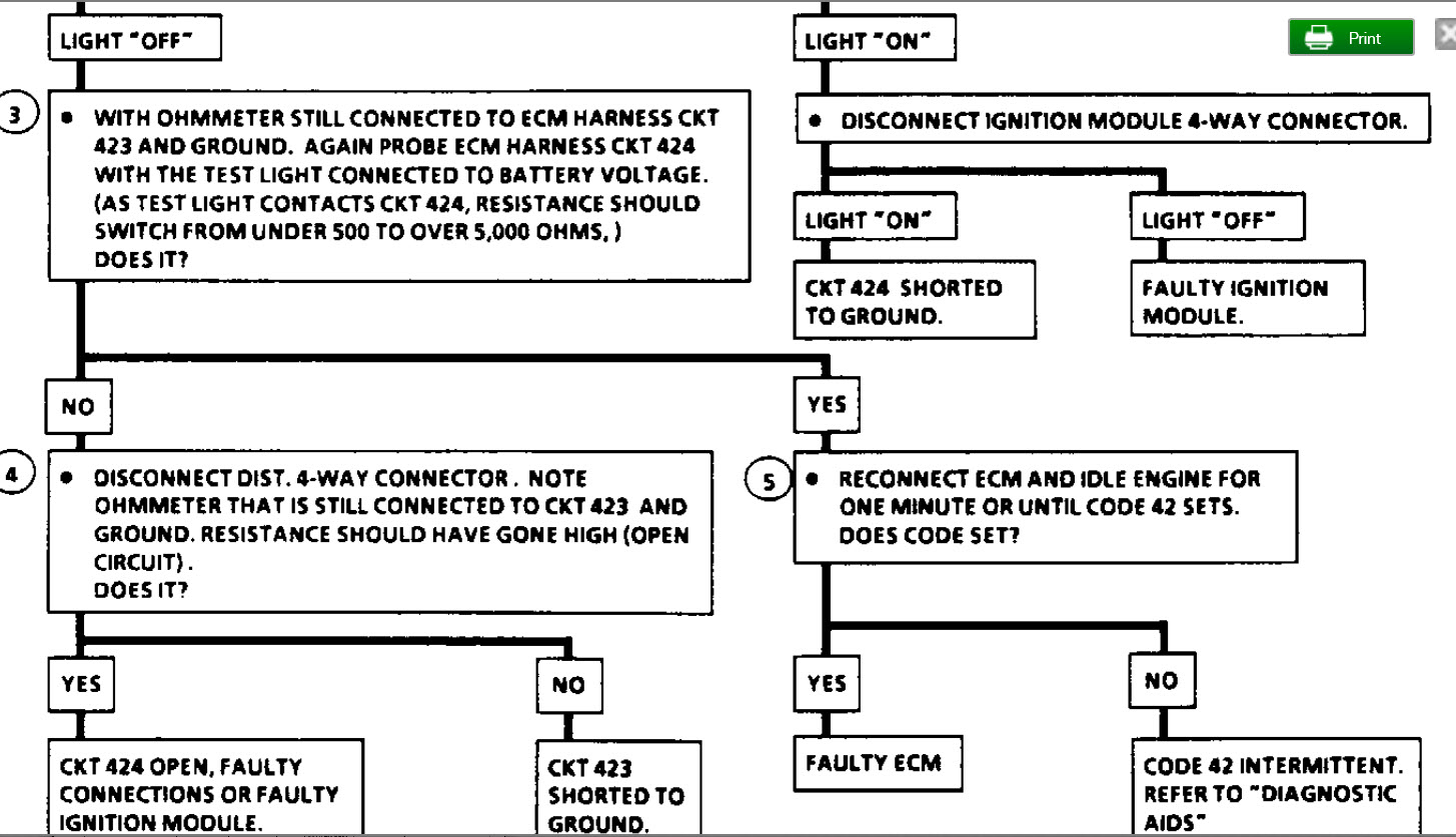

I am getting code 42 now electronic spark timing (est) circuit open or shorted direct ignition system (dis) faucet by pass circuit open or shorted to ground during engine run. Do not know what that mean
Friday, January 13th, 2017 AT 9:44 AM
HMAC300
  • 48,601 POSTS
See pictures on how to diagnose the problem.
