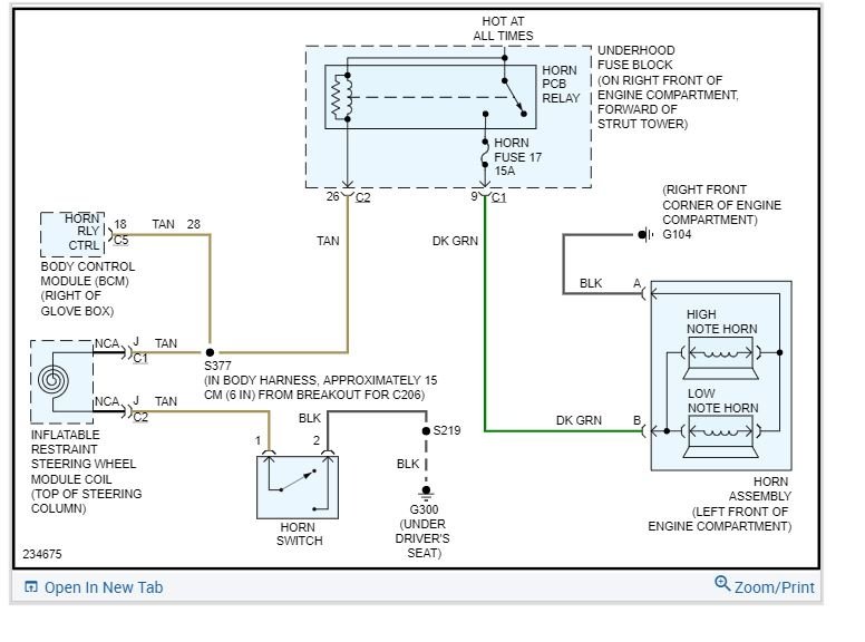

Horn not working. No power to fuse on either side.
Sunday, May 24th, 2020 AT 8:55 AM
MECHANIC
52,796 POSTS
Good afternoon,
The fuse is powered once the relay is energized.
I attached a wiring diagram for you to view. Can you get a test light or voltmeter for some testing?
