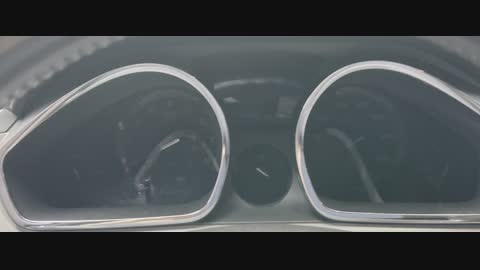

Here's what it does when I insert the key and then turn to 'on, then to 'start'.

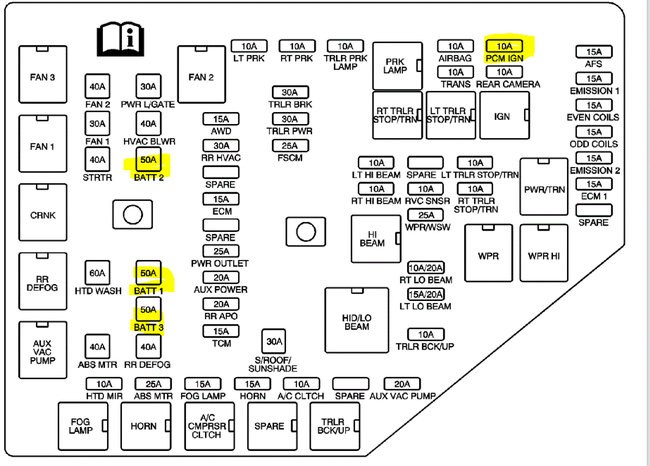

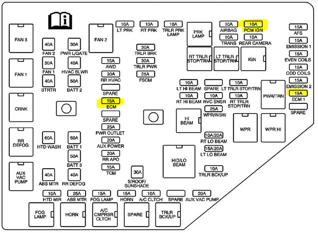

Next, I want you to check the PCM fuse and two ECM fuses under the hood in the fuse box. I attached a pic below showing their locations.
In addition to checking the condition of the fuses, confirm there is power to and from them. Here is a link you may find helpful:

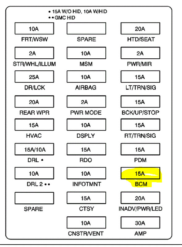

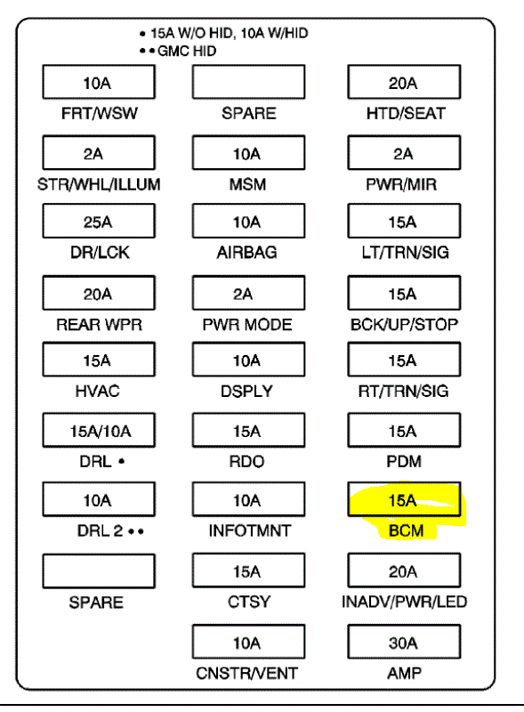

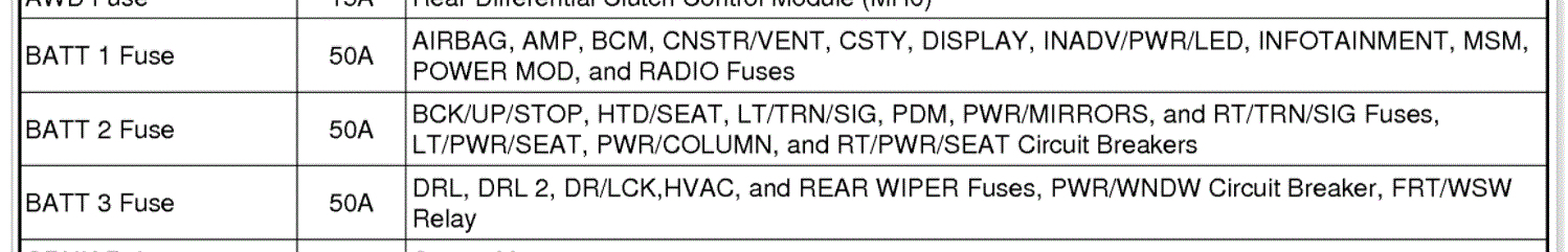

I need you to bear with me. I need to start with the power supply. If you look at pics 1 and 2, they are related to the underhood fuse box. I need you to check the fuses I highlighted. Also, confirm there is power to them.
Pic 3 shows the fuse box in the vehicle. Check the BCM fuse I highlighted. Again, even if the fuse appears good, make sure there is power to and from it.

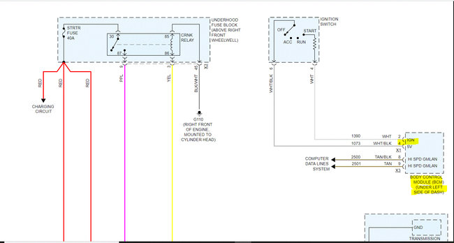

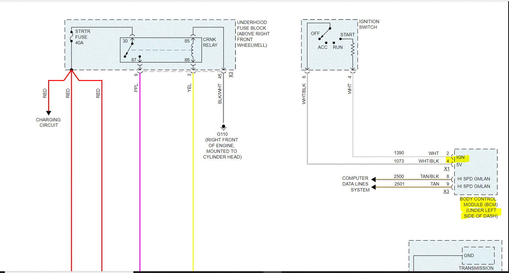

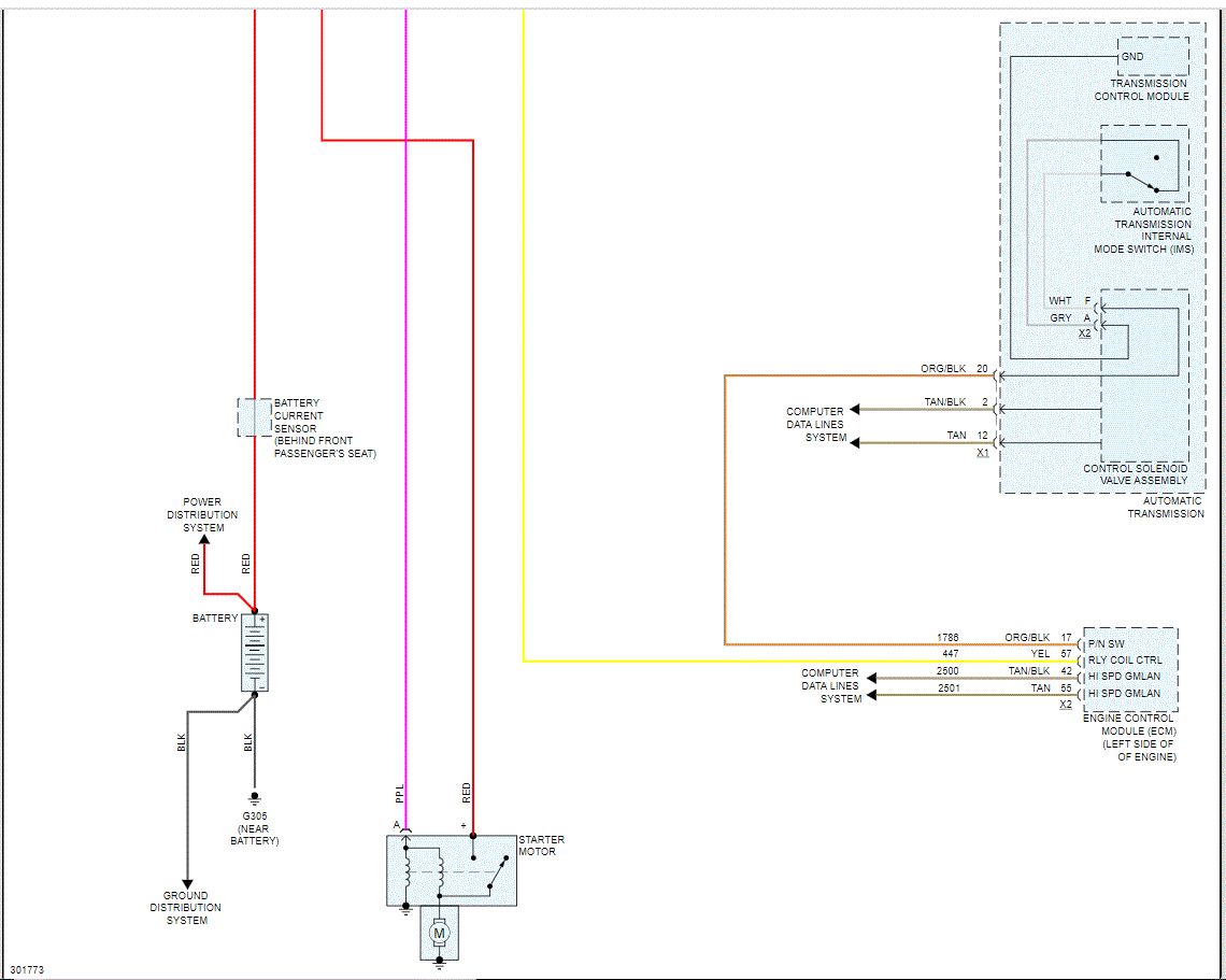

The last two pics are the wiring schematic for the starter. There is a white wire which travels from the ignition switch to the BCM. That should have power when the key is in the start position. I will need that checked if all fuses are good. Here is a link you may find helpful:
What really should be done first is to scan the CAN bus system. CAN stands for controller area network. Basically, all modules/computers are tied together via a few wires. When you use a traditional scan tool, most only look for engine trouble codes. If you use a scan tool able to read all codes, it will identify where the breakdown is.

Since the new ignition switch was installed, it could even be a loose connection at that point, so you may want to check that as well.

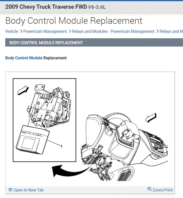

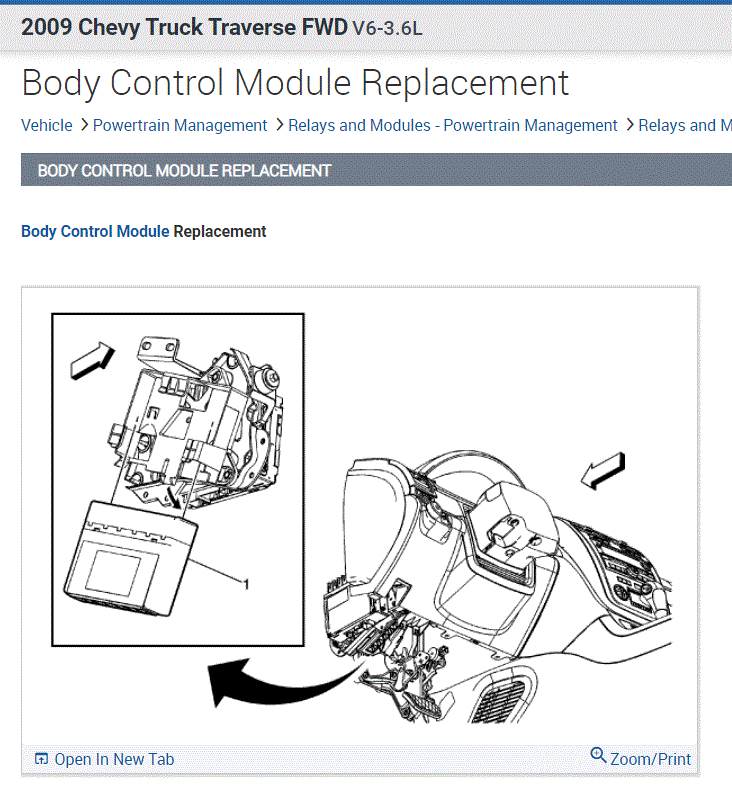

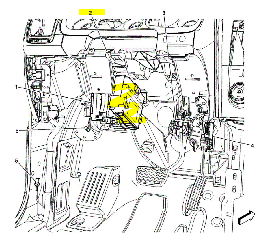

The last pic below indicates the location of the BCM, under the dash on the driver's side. See if there is any evidence of water damage.

Thanks for the diagram--very helpful! I couldn't find a pic or diagram of the BCM location anywhere. Everything you advised to check checks out. No obvious signs of water damage or water at all, no stains, nothing feels remotely wet or damp. Wires and wiring harnesses look almost like new. No blown fuses, power supply and continuity checks out.

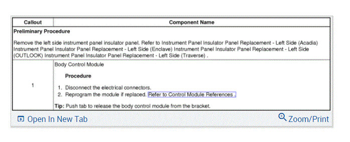

Let's hope this takes care of the problem. I attached the directions below for the replacement of the body control module.

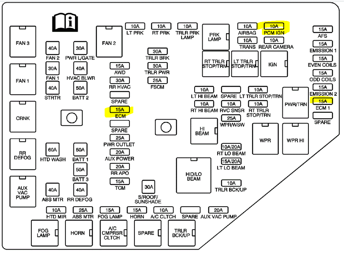

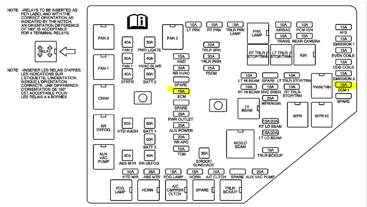

We are missing something simple. Have you checked the ECM and ECM1 fuses under the hood? If not, do that. In addition to checking the fuse, confirm there is power to them. See pic 1 below.

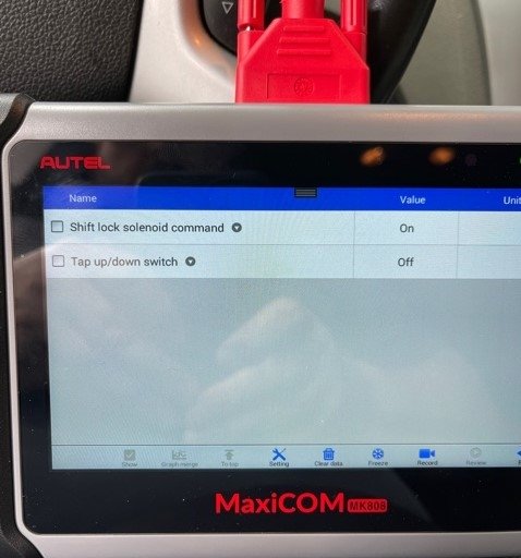

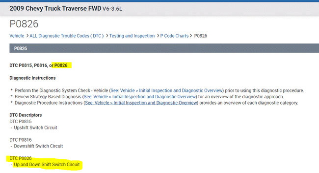

I got the MK808 and spent a good amount of time playing with it (and updating) over the weekend. Before I get into the codes, I replaced the original BCM back (to get rid of the airbag error from the "new"/refurbished BCM), and I replaced the Brake Pedal Position Sensor (as a desperation attempt to get out of park).
I received 9 DTC's but only two systems really "matter" to me: BCM and TCM. Aside from not caring right now about the non-BCM codes (e.g. driver door switch/motor, memory seat module, etc.), the codes "that matter", after reconnecting the battery, clearing all codes and running diagnostics are:
BCM:
B1395-03 Device voltage reference output 1 circuit low voltage
B1529-03 Device voltage reference output 5 circuit low voltage
TCM:
P0826-00 Up and down shift switch circuit
I don't think the "up and down" shift switch would keep it from coming out of drive, just prevent manual gear shifting.
Also, still no idea why the HVAC will not come on...switch positions all check as do fuses but first things first, right? Getting out of park.

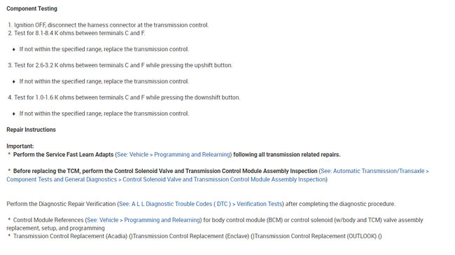

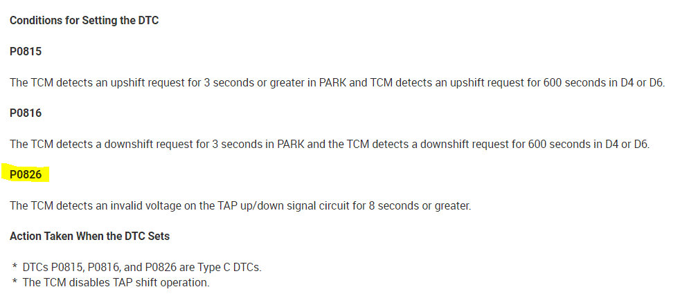

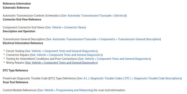

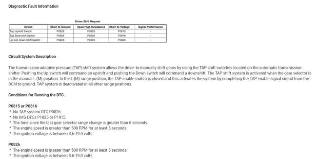

The B codes don't seem like they are a cause. The 1529-3 is for the steering wheel radio controls. 1395-3 is related to the instrument panel lighting/dimming (both low voltage from the BCM).

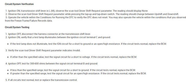

The P0826 is with the manual shift. I am going to let you look through the diagnostics related to that code because it is the only one that seems remotely relevant.
Take a look through the attachments below. Let me know if you are comfortable performing it.
Let me know if you have questions.

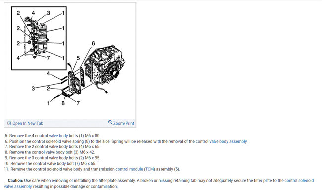

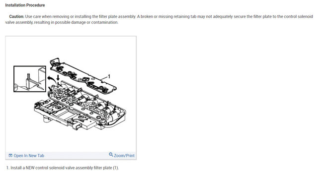

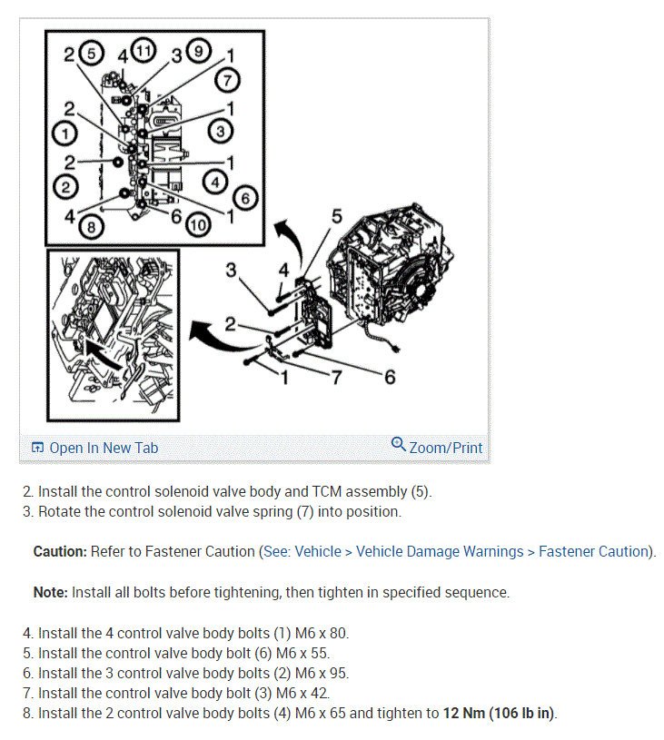

  • 110,244 POSTS

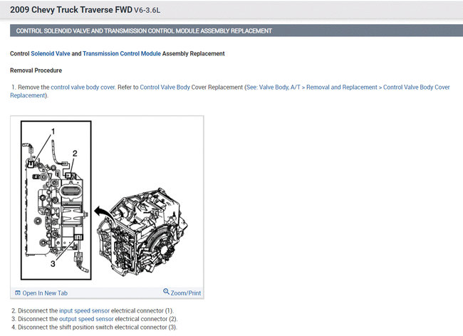

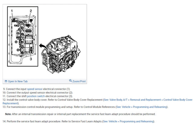

No problem. I attached the directions below for replacing the control solenoid valve in the transmission.
Let me know if this helps.

I was referring to the Shift Interlock Solenoid. Here is Rock Auto's link to it:
https://www.rockauto.com/en/moreinfo.php?pk=2456696&cc=1444048&pt=16116&jsn=8&_nck=HllVxRCey1%2B2aVRDo41oQcMse1xIL9SL3KmW9dQXSf%2BAJlcOi2imTXTfOFLWd%2FZ7qi3oWcgQbtVtfiosB09jyUkNCc52VyjIycSOtQQibJSfVbfK5HMC7z15elRBhMX1tqxmeGuesF5DG4rkswUQTDqayIM4bRPkLDSMBJdcQkTMW11g7eXzpX4BqsxEDcQ8lSOLCofroOV8YT7LeM1Tht6DEa007%2B3xTpPeHm8P3iryjR6VO0%2Bdul1FKv%2FdMgbLLHrTgG181MPTOpVP9JKh3xz0fgmHXLqAZICc5tvu32nYgPMOKWGIUWSwxr%2F7eiTjB3FGaPMYHE19Z%2F4Nt39nNS2l34%2BzuTBw
There are also YouTube video of others who are stuck in park and this ~$27 part was the cause for some. I'd be guessing if it were not for my new Autel scanner. I believe the solenoid is located, essentially, on or near the shifter column but I do not know how to get the center console out to get to it, or even how to pop 'anything' off to use a screwdriver (like others have) to manually test it, but I believe in my new tool, the Autel Mk808.
Here's one video: https://www.youtube.com/watch?v=F0zUYNcd_0k
Start at 4'48". This vehicle in the video indicates active/inactive. Mine indicates on/off, except mine says, "on" regardless if I'm depressing the brake peddle or not see attached picture). At least for getting the vehicle out of park, I now believe it's the Shift Interlock Solenoid.
Any guidance you can provide in getting the center console off and getting to the shift column would be appreciated.
