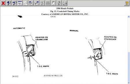

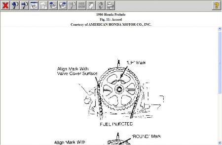

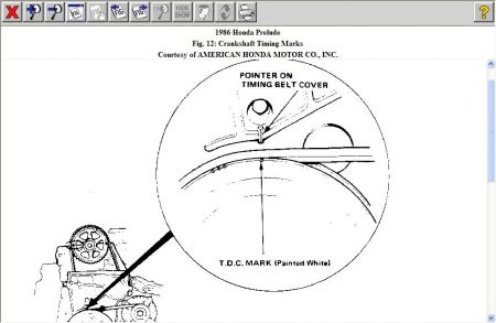

In the event your getting spark and fuel is reaching the plugs-try to reset the the valve timing by putting engine no.1 piston on compression stroke/TDC then line the sprockets as you see below
