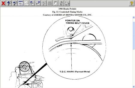

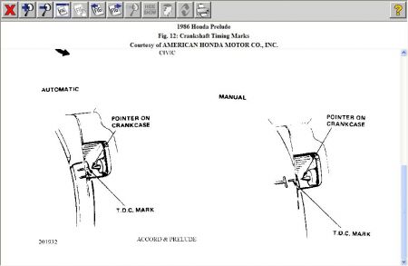

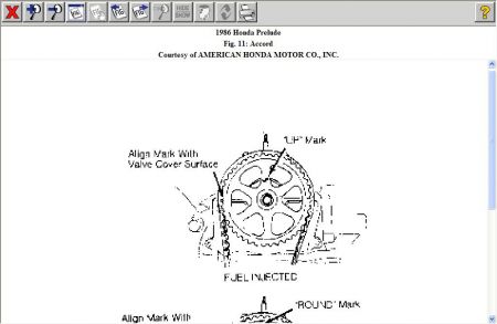

By timeing marks the car was runing till about a week ago when I pulled out of my driveway and it died and wont start anymore have checked fuses

Open up the distributor cap have helper crank engine over while you check whether the rotor is turning.
Did you do a static or dynamic with a timing light
Saturday, September 20th, 2008 AT 4:57 AM

I have never done that not sure how to do it have always timed by marks will have to check dist cap in morning when I have a helper to turn it over

Put the engine on TDC line the markings oon the damper TDC/0 make sure your not on the exhaust stroke otherwise you gonna be 180deg off-where is the rotor point at is it no.1 or no4?

It is on the #1
